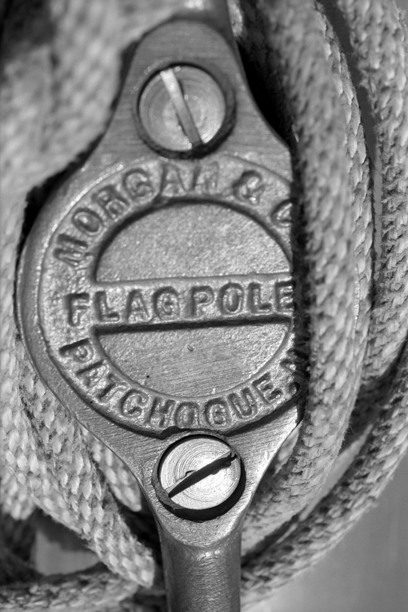

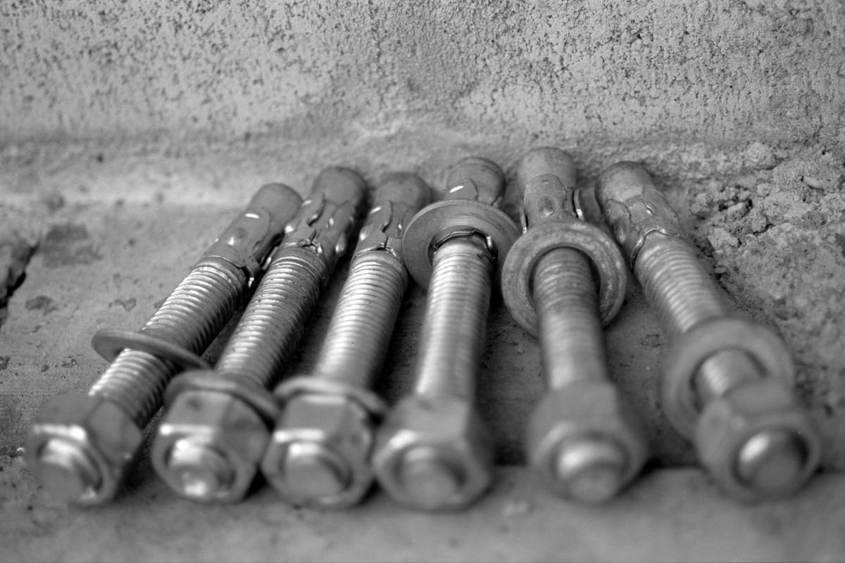

Ferrania P30 Alpha box speed, developed in Adox Silvermax, 1:29 11 minutes 20C 1 minute continuous, 1 inversion/30s thereafter.
Cataloged in lightroom, no adjustments.
Pakon F135 scans to raw, inverted in colorperfect.
Please see the flickr link for more photos: https://www.flickr.com/photos/thekurgan/albums/72157692998955080
Thanks for taking a look.
I absolutely loved the P80 rolls I got. I found it to be accurate to box speed in a 1:100 rodinal stand.
It looks gorgeous on reflective objects... Vintage cars, metal objects, etc. But especially so in subdued / diffuse light.
Not unlike Pan F+.
I haven't gotten around to printing it wet (but i'm very much looking forward to) so keep that in mind.
