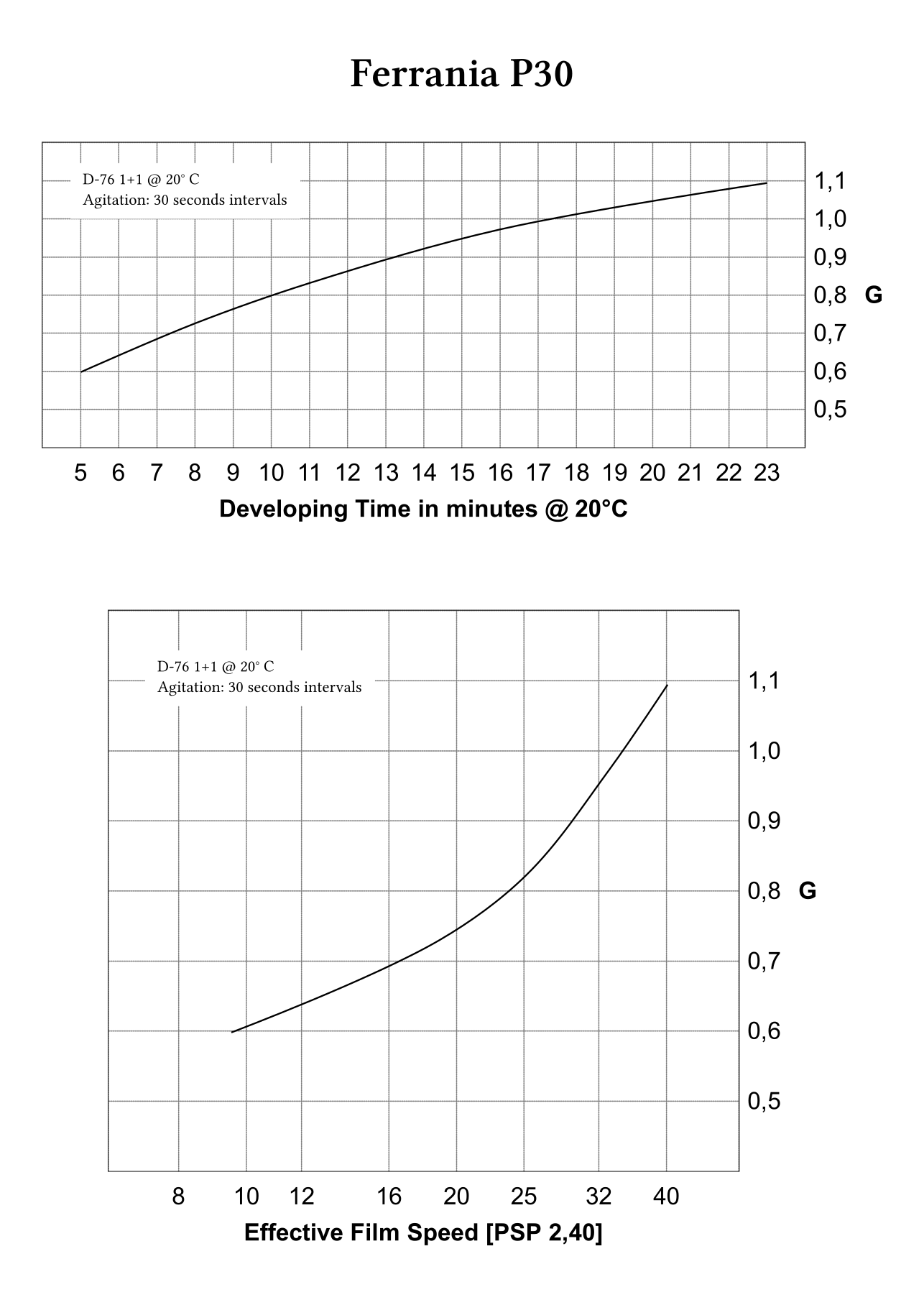

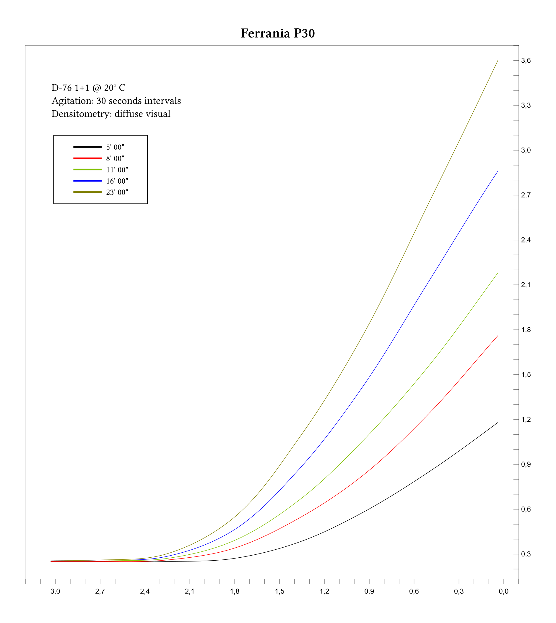

These are my sensitometric data.
Here a small review, sorry only in italian, but I think it could be quite understandable using an automatic traslator.
I stress that this work with my workflow in my darkroom and that are exlusively for enlarger printing.
P30 has a long toe and can be used with good results at EI 25, may be EI 50 too if printed on soft grade paper using a diffusion enlarger.
May be that scanners can pull out more details in the shadows than photographic paper, but my workflow is all analog.
Hope it help.

Your review is very appreciated, I too work only with an analog workflow (I just use the scanner to make previews to share with friends). I too had good results at ei 25, and I found it frustrating that apparently I just end up with underexposed and overdeveloped negs @ ei 80. The charts are appreciated too!
Hope it help.
Diego
Thanks for sharing your results! I really appreciate it.
