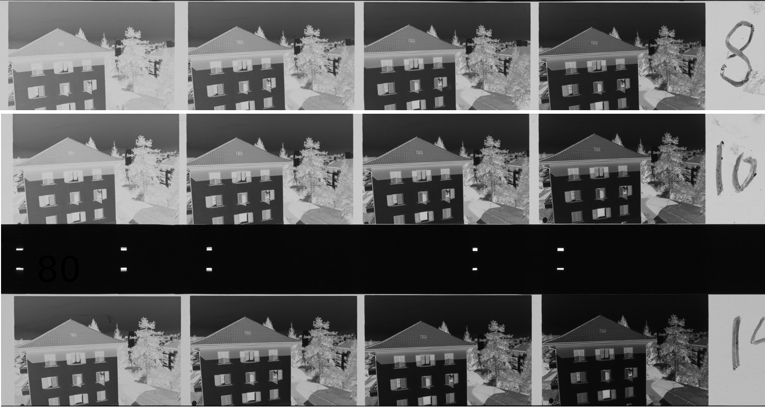

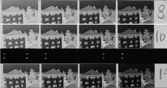

Some time ago I made a couple strips to test p30 in rodinal, at 80, 40, 20 and 10 iso for 8, 10, 14 minutes. (See attached image, not the best scan but you should get an idea). I was expecting my negative more or less as the bottom left one (80iso, 14 min), a bit contrasty but overall ok. My favorite combination was at 20 iso @ 10 minutes, but since people were getting nice results at box speed I hoped I could get some too.
@twelvetone12, I feel your pain as it sounds similar to my initial experience with P30. I shot my first roll at EI80 and developed it in D-96 per the Best Practices document; soot 'n chalk results--anemic shadow detail and blown highlights. Then, I decided to get serious and do some sensitometric testing which revealed that EI40 provided the correct Zone I exposure of 0.10 over fb+f. My next roll was to determine proper development time/temp/etc with D-96. I finalized on using D-96 @ 1:1 which I haven't seen mentioned, anywhere. I didn't go back and check for correct Zone I when using the developer at 1:1 so I guesstimated that either EI32 or EI40 should be close enough; someday, I'll run the tests, again, to verify.
To sum up, I got the best results shooting at EI40, placing important shadow areas no lower than Zone III, and developed in D-96/1:1 @68F for 6 mins with continuous agitation (12 inversions per minute.)
Don't give up! It's a quite beautiful film, once you get it locked in.

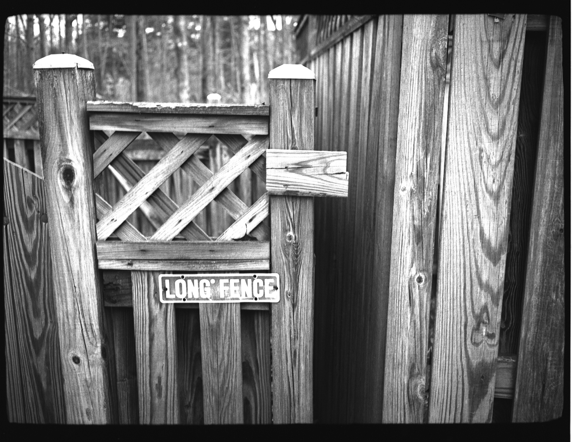

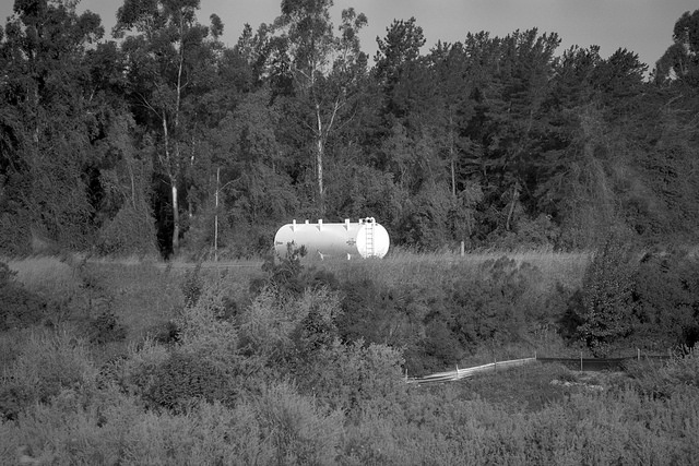

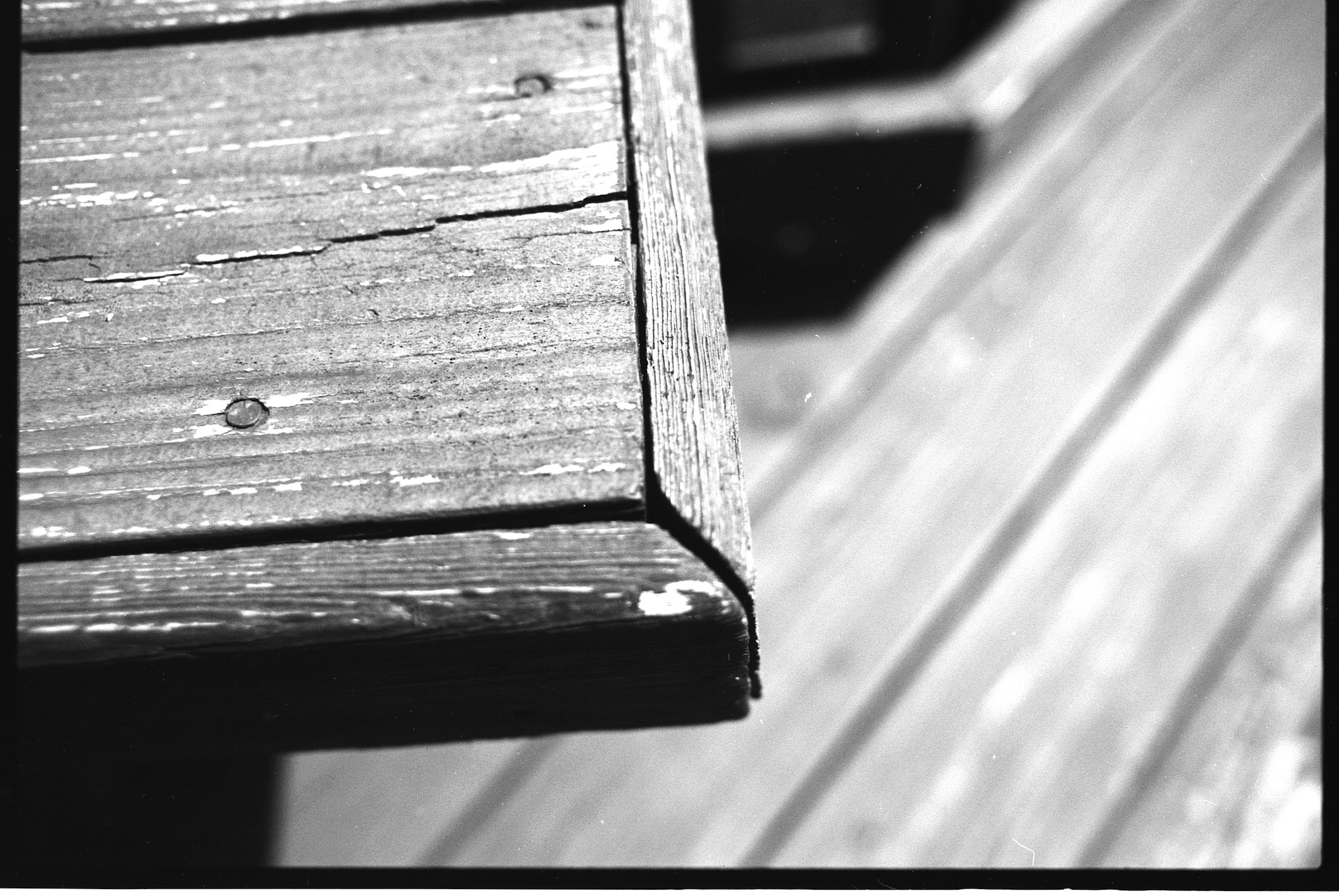

In Scott's article, he specifically does not try pyro. I'm attaching two pictures made on P30 and developed in 510-Pyro. The shot of the fence is actually taken with an original half-frame Olympus Pen, the other with a Vivitar Series One 28mm f/1.9 on a Nikon FE2. The grain is very, very fine.
View attachment 198689 View attachment 198690
I like the tonality of these.

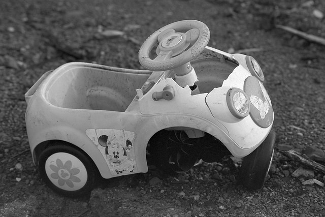

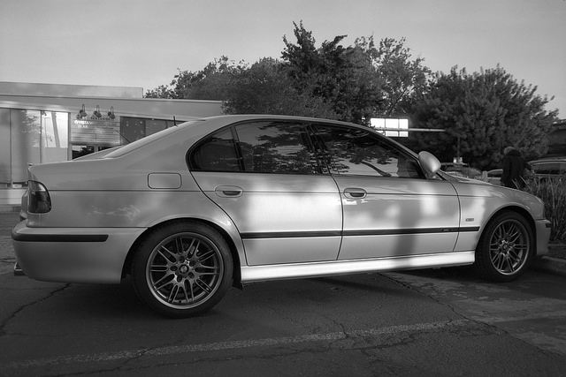

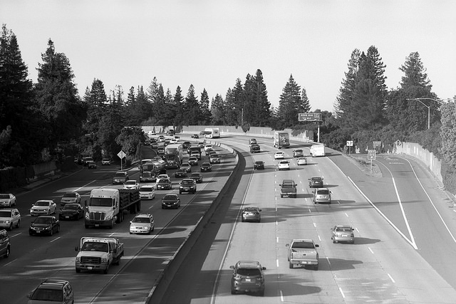

Here are the results from the FF No. Monobath, Ferrania P30 Alpha 80 ASA, 6 minutes @ 71F, 5 minute wash, photo flo and hung dry overnight. Pakon F135 scan to raw, invert in colorperfect colorneg mode, lightroom cataloging and dump out as jpeg.
https://www.flickr.com/photos/thekurgan/albums/72157696553030865
View attachment 200141 View attachment 200142 View attachment 200143 View attachment 200144 View attachment 200145
That's astonishing. Some of the best results I've seen on p30!
Thanks for the pics.
Thank you guys. I am very pleased and was skeptical after reading the book by Grant Haist, but aside from the strong odor, I'm pleased for an AIO solution. The 500ml bottle will do about 4 rolls of 36 exp (135).
