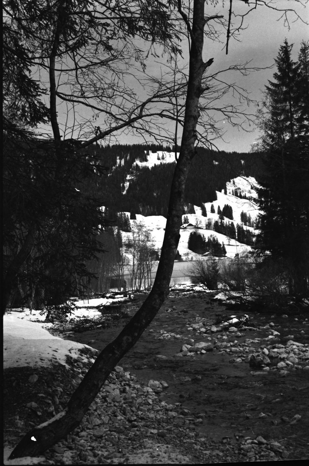

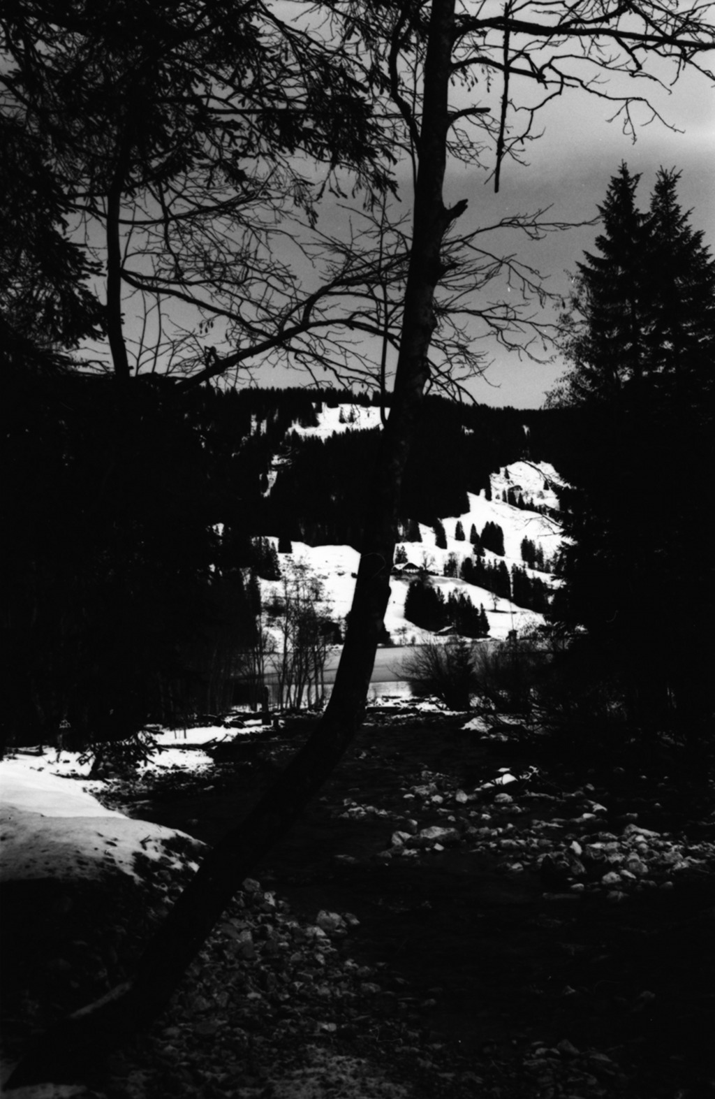

After two rolls of p30 that came out tragically in d76 (shoot @80iso, they came out underexposed and underdeveloped), I was hoping for the magic properties of Paranol. S. Now, I don't believe in magic, and the negative resulting was one of the worst I've ever had in the last years. I shoot @80, developed in 1+50 for 14 minutes at 20.0 degrees. The negative came out as document microfilm: there is transparent base in the shadows and DMAX in the highlights. Nothing in between. I looks like a 8iso film shoot ad 3200 and developed for two hours, massively underexposed and brutally overdeveloped. I used my Nikon F90, and I trust the meter, as the day before I did HP5 and color and the negs were all exposed correctly.
As a side note, I also developed a roll of Acros (shoot in sequence) and, while it appears exposed correctly, it seems quite underdeveloped (I did per instructions, 1+50 14 minutes at 20C). So I'm not sure how much fault is in the film and how much in the developer.
Returning to P30, I really can't understand how some people get good results at 80iso, unless they overexpose by 2 stops. The 4 rolls I shoot at this speed all had no shadow detail and a mixture of thin/blocked highlights depending on the developer I tried. I will revert back to 16iso in beutler, which gave me the best results, for the remaining films.
EDIT: I'm forgetting how to write in English... :sad:
EDIT2: it is a F90 obviously...

How was the film agitated? Was the temperature precise? If you are seeing nice results at 16 ISO, I suspect a metering problem. Are you seeing these results by examining the negatives, printing or scanning? If scanning looks horrible, how are the negatives scanned? What software?
Hi Scott! The temp was at 20.0 measured with my digital thermometer, I agitated 30s at the beginning, then 10s each minute (I use a stopwatch).
I think the meters are not at fault, because I used P30 with different cams (F3, F4, F90) all of which I use regularly and produce excellent results with other films (and slides which I shoot often). I also develop lots of other films regularly and I never get such results (even when my thermometer was off by +3 degrees!)
Later I will be in the darkroom and make a photo of the negative on the light box. You can clearly see completely empty shadows and dark highlights.
In the meantime, for what is worth, I have two scans. The day was quite dull and slightly overcast. First image is p30 and second acros, same spot some 30 seconds apart. Same camera.
Maybe I just hit a bad batch of p30, dunno. I was able only to have good results @80 iso with one roll in d76 and could not replicate it.

Wow, yes those scans do look lifeless. I've not had results like that using even HC-110(b). What is the scanner and software combination?
It is a Canon 9000 mark II + the bundled software, which is quite dreadful. But I will post a photo of the negatives, I think that is more representative.
If the software has a way to dump out a raw, linear scan, I'll see what photoshop/colorneg can do, which is all I use these days for all my inversions. I'm just not familiar with proprietary scanning software. I do know the Pakon default is also hideous with the P30 (and most true B&W films). Sample: my sister would slaughter me if I put this out in to the world, Pakon F135 @ default B&W setting.
