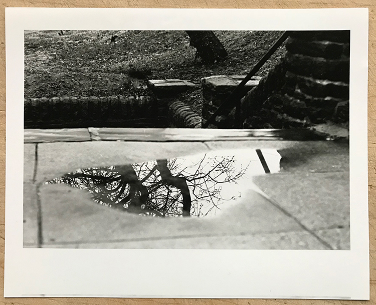

Just closing the loop with a wet print. This was a straight print of a negative exposed at ISO50. On 8x10 paper it was a 20 second exposure at f5.6 with a 1.5 contrast filter on Ilford MG RC paper. I didn't dodge or burn, just looking for contrast on the paper.
The grain under the magnifier is really fine.
