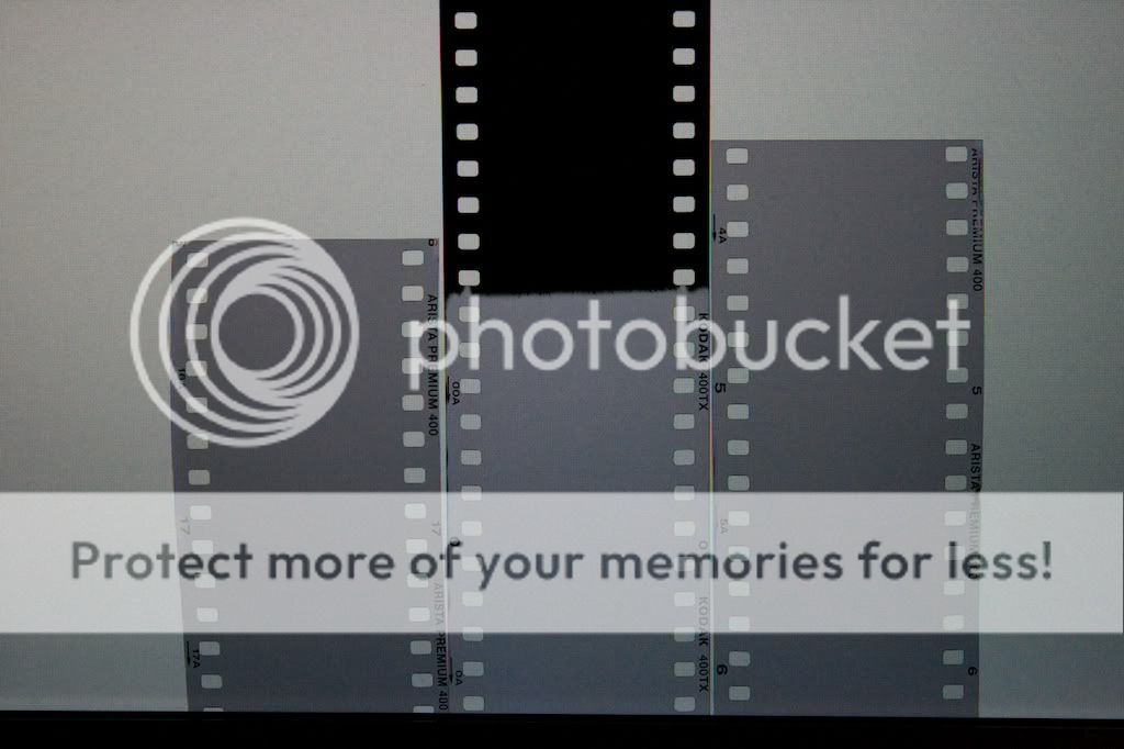

I don't have a light box, but I can try to take a photo of the film up against my monitor; I'll get that posted soon. I sure hope you don't determine that I am highly radioactive!

There seems to be a lot of interference and other funky behavior from my computer monitor, but maybe it will still be useful. The center film is the leader from the "fluke" good roll I developed, which I still can't explain. The other two are from recent film tests I did on direct cassette-to-development unexposed film strips. (Before you ask, "real" Tri-X has fogged the same way as AP 400 in my recent tests.)
I didn't bother editing the levels at all, but I can increase the contrast for you if it would help.
Different films have different base fogs. If you'd like, you can send me the strips you show above and I can check them with a densitometer and measure the base fog. PM me if you are interested.

Kirk- Thanks for the offer, I may take you up on that sometime in the future. Those strips I took a photo of are the same type film though, so I think I'm dealing with more than a little base fog right now! :D
If you have a spot meter, you can do a quickie density check yourself. Meter your monitor or light table, don't move the position of the meter much, and then place the film in the same spot and meter again. Anything up to about 1 stop difference is probably OK.
My eyes aren't the greatest, but I don't see increased density along the edges here. Wasn't that the essence of your problem? I don't believe you were complaining about overall fog.

The edge density on my negatives (only noticeable with images present) was my original problem, but then I discovered that it seems to be caused by the overall fog, so that is what I'm working on now. The problems go hand-in-hand, anyway; when my rolls don't have excess fog (lab-developed or when I got lucky), there are no edge defects. Maybe I should have started a new thread. :D

It doesn't look that bad. How do they print?
EASmith,
They don't print very well-- I have to use grades 4 and 5 all the time. That is still manageable I suppose, but the edge streaking that goes along with the fogging is not; it's hard to burn the streaks evenly, even on scans where I have the undo button.
