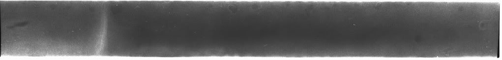

A friend pointed out that chemically-speaking, an unexposed emulsion shouldn't have any density when developed so there is probably a light leak somewhere in the system. It probably isn't in the camera, as I've gotten good results in lab-developed film shot with this camera, so I'm guessing the leak is in my changing bag or tank. Probably the tank, as there is such a defined pattern, but I'll set up some experiments to test where it is.
You can see that there does appear to be some sprocket-hole surge, so my problem may be partly agitation-related. Could the surge-like pattern be caused by the light leak in a tank too, though? Hmm...
Also, I have no idea what is causing those longitudinal lines, but one step at a time. :smile:

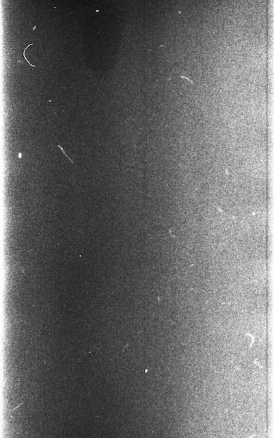

This image shows why problems can be so perplexing if they have multiple causes. The sprocket surge is one thing; but I seriously doubt that is much of a problem. Your friend's comment that a totally unexposed segment of film should have no density (above film base/fog level) is true; but other things can make film "developable." Physical stress, for example.

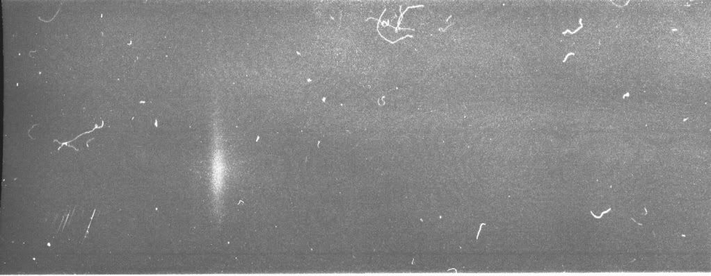

Here are the results of that test. Bubbles and streaks are probably due to lack of photoflo and not being too careful with the finished negs. The dust is because I don't really care. :tongue:
Lid open for two hours, then lid closed for several hours (unexposed film, not run through camera):
Lid closed for several hours (unexposed film, not run through camera):
Previously posted negative (from test roll run through camera):
Lab-developed film base (from roll run through camera):
Any ideas? Note that some of the apparently overdeveloped edges are just bits of the negative carrier in my scanner. I don't think you can make any direct comparisons based on shades (meaning, the darkest spot on one scan may not represent the same density as the darkest spot on another scan) between the scans because of how my scanner software works, but you can obviously compare within each scan and compare the patterns between scans. Also note that the two test negatives were done in a two-reel tank-- the "closed" film on bottom, the "closed/open" film on top.

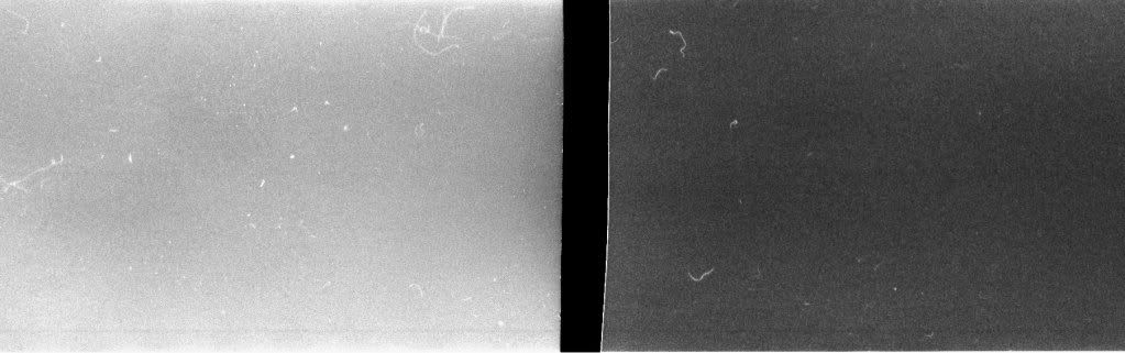

Here is a scan of two unexposed films (both scanned in the same pass, so you can make absolute density comparisons between the two films); one where the changing bag was used in a bright room (left), and one where the same bag was used in a dark room (right):
Pretty amazing, eh? I imagine I will be far more pleased with my future negatives if I was losing that much contrast. :smile: I don't have any unexposed film tests of the new changing bag, but qualitatively, based on a roll I just developed, there is a monumental improvement.

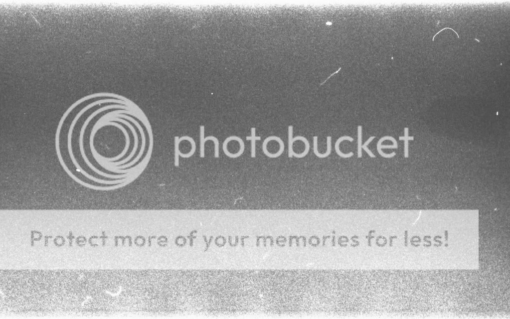

Ugh, this is ridiculous. That good result I posted was apparently a fluke; ever since then it has either been more of the same or a slightly different version of the same thing. I've been loading my changing bag in a room that is *almost* darkroom dark, so I figured I eliminated my light leak problem, yet I still have uneven development. For the most part I have eliminated the sharp edge streaks (though they are still present to a lesser extent), but now this has been happening:
The image of the film is oriented the same way the film is oriented in the tank (top of frame = upper edge in tank). This has happened on several test rolls; one stand development, one "normal" to see if it was repeatable (it is), one w/ water instead of acid stop bath (no difference), one w/ increased initial agitation (this seems to have brought me back to my previous problem w/ both edges overdone), and one w/ ID-11 instead of rodinal.
Though the pattern of uneven development occasionally changes, whenever bits of unexposed film are scanned alongside the fluke unexposed film (the one with good results) there is a huge difference in density, just like I showed in my previous post. For whatever reason, the one good film I developed has a lot less fog (I assume it's fog, is there another word for unexplained density?) than any of my others. Scouring the internet has been fruitless, so far. I wish I had videotaped myself developing that film!

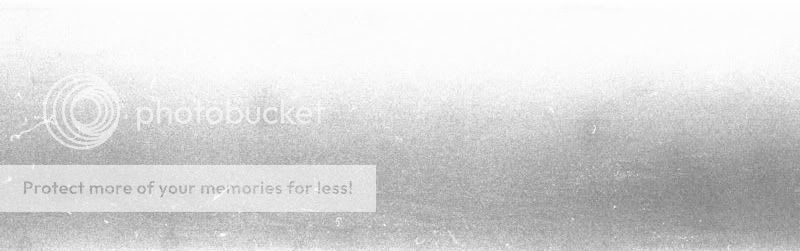

Edge Density variation.
Your negs have development density build up. This is a problem that is difficult to completely elimate but can be moderated. Many say they have no problems, but looking at the negs it is evident.
