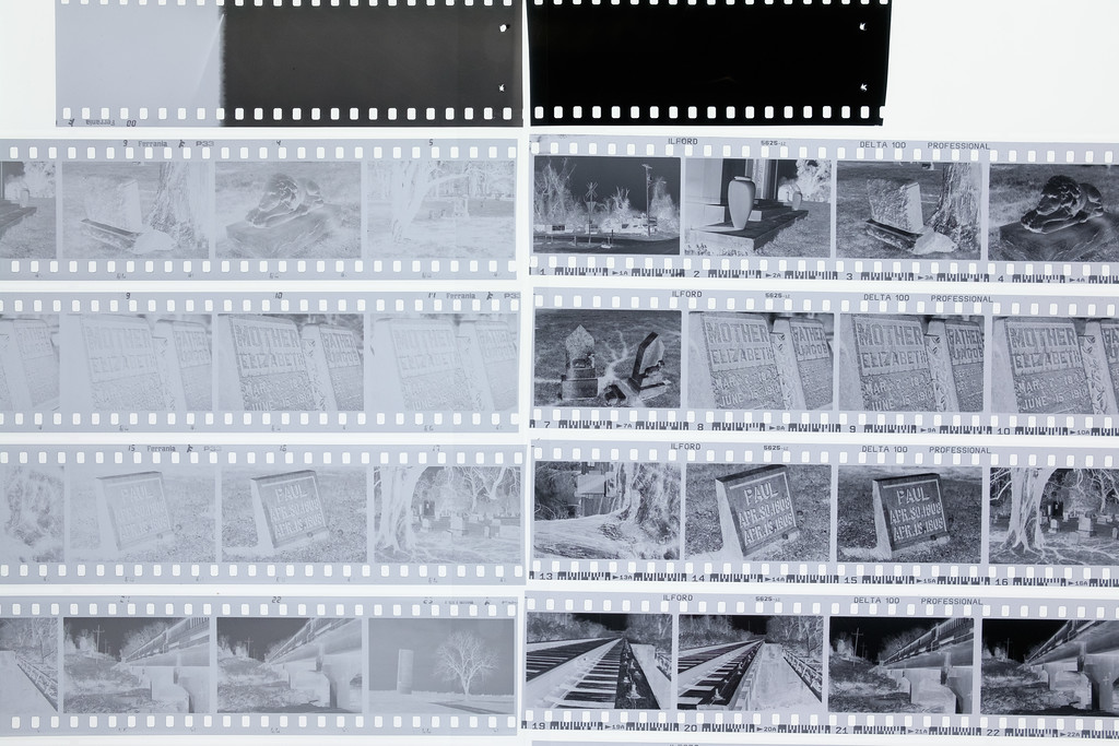

I developed my first roll of Ferrania P33 today, but my negatives came out very thin. I believe the problem is underdevelopment.
As mentioned above in post #9, I came up with a time of 7:00 at 20*C for LegacyPro Eco-Pro diluted 1+1. Right now, I still don't know if my problem is:
a. my processing time was too short, or,
b. my Eco-Pro chemistry has somehow lost activity?
The Eco-Pro chemistry should be OK. It was made using distilled water less than 4 months ago, and kept in a full HDPE black bottle in a cool dark basement. Legacy Pro says the stock solution should have a 6-month shelf life, and my previous experience agrees.
The P33 is on the left; the roll of Ilford Delta 100 on the right is more like what my negatives usually look like when I photograph them on my light box. (Actually, this roll of Delta 100 may be a little more dense and contrasty than my average results, but not by a lot.)
Whenever I'm using a developer that is approaching the end of it's shelf life expectancy, I do a clip test. Was the roll of Delta 100 also processed in the same developer?
No, the Delta 100 was processed in Ilford Microphen. The only reason I showed the Delta 100 negatives was as a sort of reference to show what my "normal"negatives look like on my lightbox.
To be clear, my Eco-Pro developer was not "approaching the end of it's shelf life expectancy." Based on my previous experience with Eco-Pro, I would not be expecting any trouble at 4-months, because it usually works fine at the full 6-months as predicted by the manufacturer.
Normally, I do a quick test for activity before using any of the ascorbic acid type developers, but this time, I forgot. However, I don't think my normal activity test would have helped, because I just do a qualitative check to see if there is "some" activity. A weak or underperforming developer would still pass my test. When you do your clip test, do you somehow quantitatively prove the developer has full activity?
Obviously, I will want to test the remainder of this batch of Eco-Pro before processing anything I care about. To do that, I will process a test film for which I have a known, reliable time -- as opposed to the (wild-guess) time I used for this roll of P33.
Unless/until some more data becomes available about P33 in XTOL/EcoPro/Adox XT-3, I will probably just hang on to my second roll of Ferrania P33. Either that, or order some Bellini ECOfilm developer.

If 10:00 is a good time for a stock solution, then my time of 7:00 for a 1+1 dilution must have been way too short, thus explaning my thin negatives.
Can I ask where you obtained your time from or on what basis you decided that Legacy Eco Pro at 1+1 at 7 mins was the right time?
