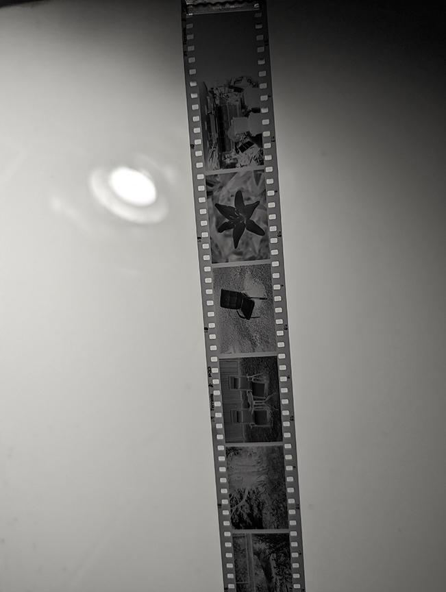

I developed my first roll of Ferrania P33 today, but my negatives came out very thin. I believe the problem is underdevelopment.
As mentioned above in post #9, I came up with a time of 7:00 at 20*C for LegacyPro Eco-Pro diluted 1+1. Right now, I still don't know if my problem is:
a. my processing time was too short, or,
b. my Eco-Pro chemistry has somehow lost activity?
The Eco-Pro chemistry should be OK. It was made using distilled water less than 4 months ago, and kept in a full HDPE black bottle in a cool dark basement. Legacy Pro says the stock solution should have a 6-month shelf life, and my previous experience agrees.
The P33 is on the left; the roll of Ilford Delta 100 on the right is more like what my negatives usually look like when I photograph them on my light box. (Actually, this roll of Delta 100 may be a little more dense and contrasty than my average results, but not by a lot.)

No, the Delta 100 was processed in Ilford Microphen. The only reason I showed the Delta 100 negatives was as a sort of reference to show what my "normal"negatives look like on my lightbox.
To be clear, my Eco-Pro developer was not "approaching the end of it's shelf life expectancy." Based on my previous experience with Eco-Pro, I would not be expecting any trouble at 4-months, because it usually works fine at the full 6-months as predicted by the manufacturer.
Normally, I do a quick test for activity before using any of the ascorbic acid type developers, but this time, I forgot. However, I don't think my normal activity test would have helped, because I just do a qualitative check to see if there is "some" activity. A weak or underperforming developer would still pass my test. When you do your clip test, do you somehow quantitatively prove the developer has full activity?
Obviously, I will want to test the remainder of this batch of Eco-Pro before processing anything I care about. To do that, I will process a test film for which I have a known, reliable time -- as opposed to the (wild-guess) time I used for this roll of P33.

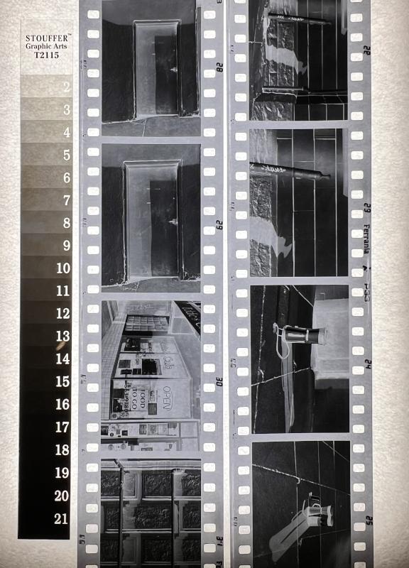

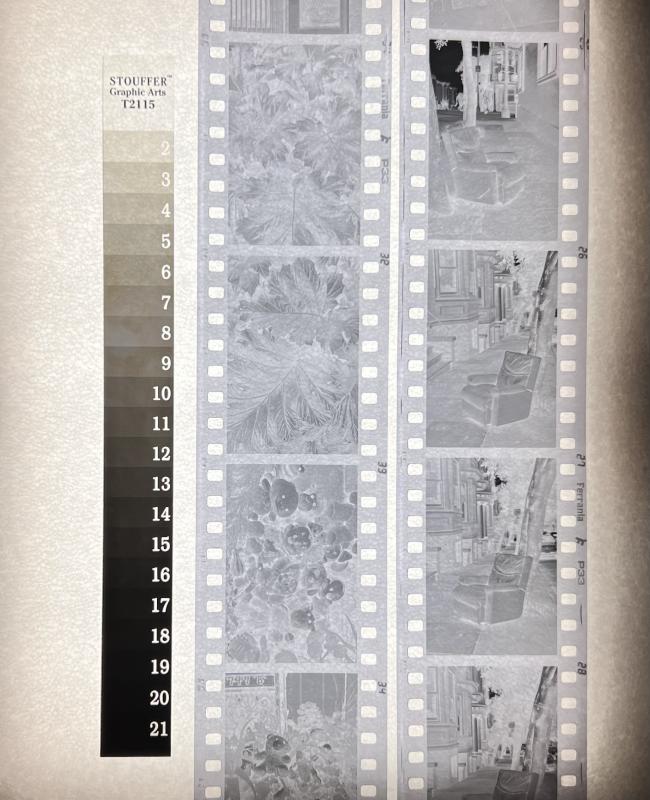

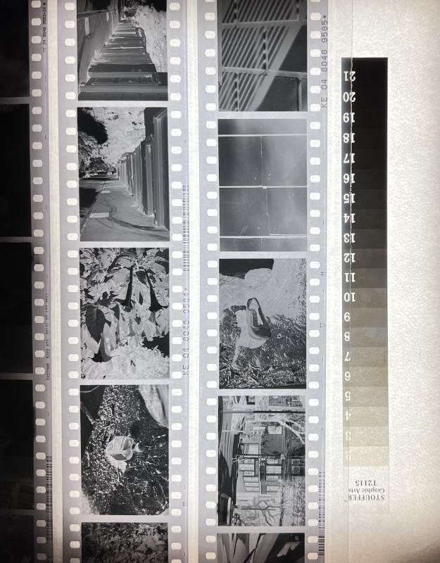

Thank you so much! Now your question has me referring to the negatives - I found Ferrania's recommended development (5 min @ 20C 1+25) far too low, but given it had good detail in the shadows even underdeveloped I'm happy with its rated box speed. I wouldn't try to print these in the darkroom but digitally they were fine. I tried it again with 30% more development and it was more reasonable but I can't find those negs right now.
Conversely I found Ferrania's recommended D76 development (10 minutes at 20C) to be too much for my purposes (though I was shooting in contrasty sunlit conditions) and produced chalky highlights with loss of highlight contrast. Still pretty usable, though.
I would have experimented further except I then tried P33 in TMax developer because I use it daily (1+4, 6min, 20C, though probably not super relevant to other people's conditions) and was very pleased with the results and have been using it with that ever since (the sneaker picture is with TMax dev.)
Apologies for the makeshift light table photos but I figured you'd like to see the actual film. Also, while I'm no eminent master darkroom scientist I think i have decent control over process so I don't think there are significant errors in processing or major exposure variations here.
That's so interesting thanks. So you did D76 stock, correct? That's a little too much contrast for my liking as well in that light setting. The Rodinal ones are really off, which Rodinal were you using if I may ask? I found the Adox one to last for ages, similarly to the old Agfa ones, but for example the Foma R09 clone starts going bad, open & ungassed, after little more than a year. Could it be a factor? Else Ferrania needs to tweak their chart.

it was D76 stock, yes. I had assumed the rodinal was bad, too, but I did another roll of HP5 after that with the same Rodinal and it was fine. So I'm not sure what the story is there. I expected it to be underdeveloped at 5 minutes anyway but figured I'd stay with their recommendation. And it did end up looking fine with longer development, I'll post a snapshot of the negatives if I can find them.
my rolls were among the first to come out of the factory and I don't know if they were all in the same batch, so i suppose there could have been some variation there, who knows. I didn't notice any actual defects in the film, which is nice.
