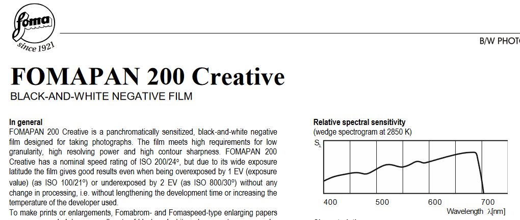

Upon reflection, Fomapan 200 has extended red sensitivity, out to about 720nm. I imagine P33 would be closer to FP4's spectral response.
Hi Andy, actually It doesn't - it has a pretty standard panchromatic response, very similar to FP4+, or Tri-X
Check out the Naked Photographer's spectral response comparison here
(Foma 200, slightly underdeveloped, left)
I wonder if you were getting mixed up with Fomapan 400, which is the one of the three Fomas with long reds up to almost 700nm.
This is what I have. Did Foma make two versions of 200?
ahah wow! Pretty sure it's a mistake in their pdf. That looks like a cut&paste of the Foma 400 spectral graph further shifted right!
Actually if you check the one currently online for Foma 200, on their website, the plot goes even further into the red compared to yours above.
Foma, your intern is making a mess of that Adobe Illustrator! :D
