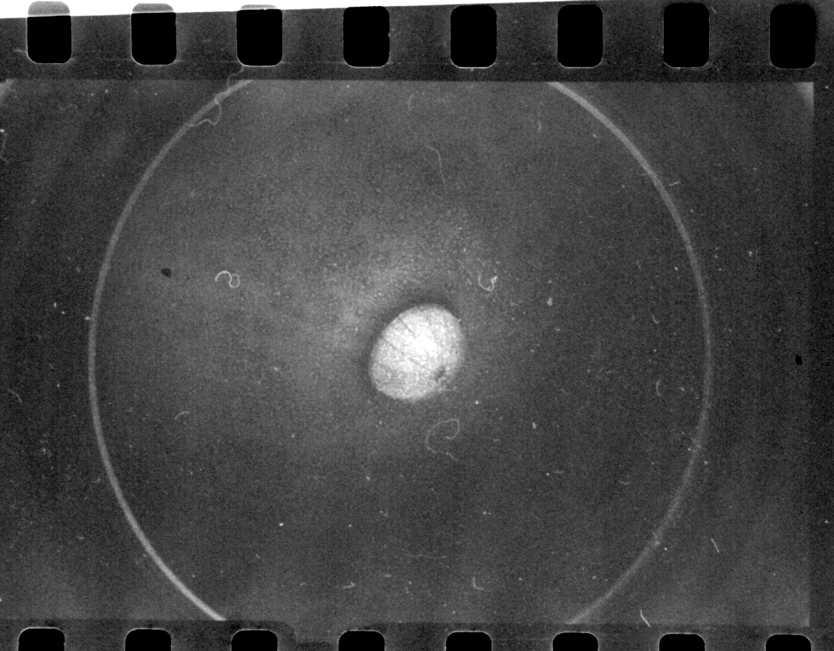

this is one of the images developed with vitamin E....it's just a light on the ceiling, nothing exciting...I had forgotten it was such a dark & boring subject...so perhaps I need to upgrade Vitamin E from astronomically weak to extremely weak
all these negatives have lint and scratches on them because they're just tests & I'm pretty rough with them...the images are round because they're from a cheap "Fisheye 2" camera

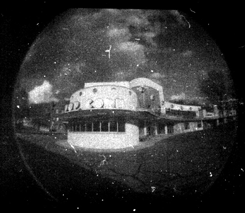

this is the tryptophan test....much better than I expected...I need to find a turkey to photograph now...unfortunately it seems the National Zoo downtown doesn't have turkeys

here is one of the results from last night's run:
two strips of tri-x in:
500ml water, 3 tbsp dextrose, 3tbsp, sodium carbonate, 1 tbsp sodium bicarbonate, 0.3 grams KBr, 72F
dextrose & sodium carbonate are heated together in the microwave for over an hour to generate the developing agents....glucic acid...and perhaps others ( gluconic acid is a new suspect ).....then the other ingredients are added...I thought the sodium bicarbonate was going to create a buffer solution and lower the pH...but pH was 11 before & after I added it....KBr was guesstimated at 0.3 grams because in a previous test 1.1 grams was helpful but waayyyy too much
one strip of tri-x was removed after 45 minutes, the other after 90 minutes
both negatives had decent images without all the fog I used to get....after only 45 minutes the negative looked usable, but thin...the negative that was developed for 90 minutes looked pretty good
here's a scan of one of the 90min images:
