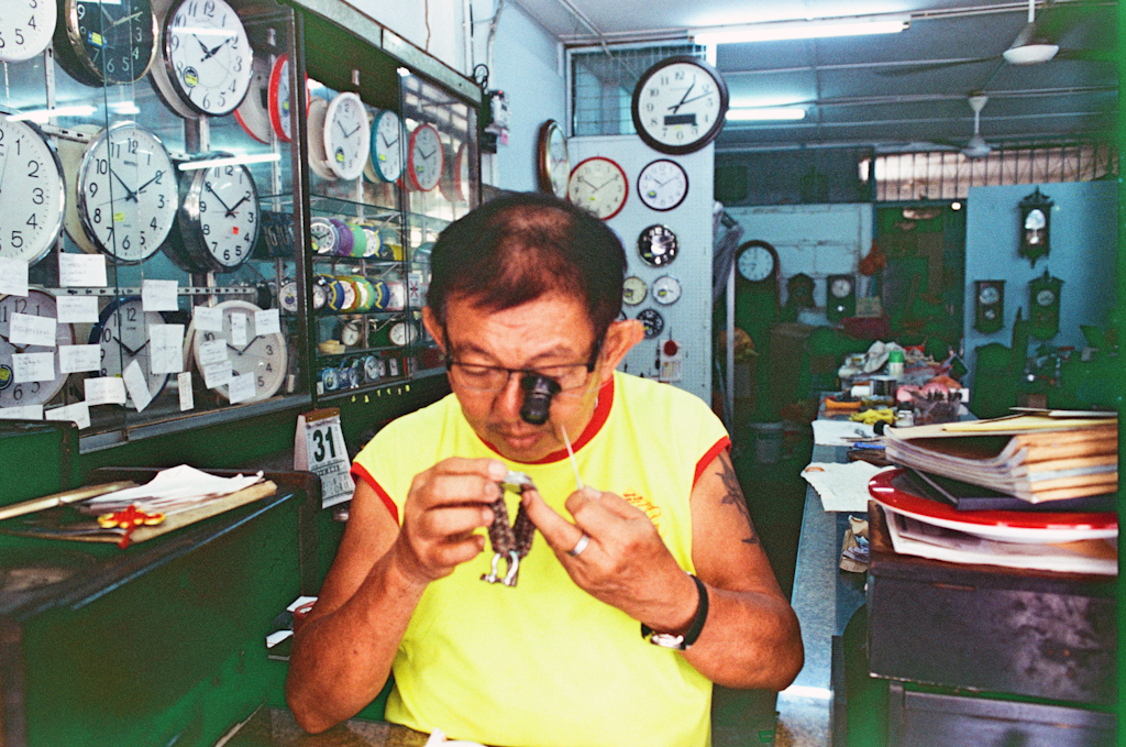

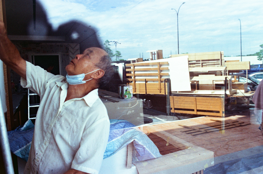

Thanks to Cinestill et al. a sizeable part of this world develops ECN-2 materials in C-41 chemistry, and most seem to be more or less happy with the results. And no, he does not HAVE TO use the same bleach times as C-41, that's a process, which runs to completion, and different materials may well complete in different time frames. BTW the ECN-2 process uses a bleach very similar to C-41 bleach, and the ECN-2 process does bleach for 3:00.
Rudeofus: he uses Fuji CN16 chemistry - I don't think he will get good results mixing the process in this situation...
I am aware of that, and we are both aware, that CN-16 is Fuji's name for C-41. Yes, that's "the wrong process", but a sizable number of ECN-2 shooters use that process and seem to be happy with the results.
It appears to me, that the dark sections in these scans show much less reddish glow than in your first test run. Is this correct?
Reddish glow? Both series exhibit massive crossover, magenta shadows with cyan highlights.
We have unknown process (no details how the processing is done), no visual representation of negative, no information about the scanning process, no information about the necessary digital manipulation part of inverting the scan...
Sure, C-41 is not the right process for ECN-2 film, but that problem is WAAAAY down the list...
Massive problems is what I see in the first couple of images posted by the thread starter. What is shown in his later images may have some cross over, but nothing unfixable. And yes, the images with 1:15 bleach and 5:00 fixing look more red in the shadows than the 3:00 bleach and 3:00 fix samples. This may be due to process variations or whatever.
Interestingly I have so far no explanation for the big difference between original sample images and the later ones.

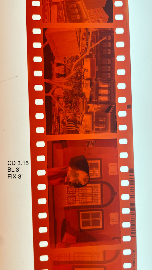

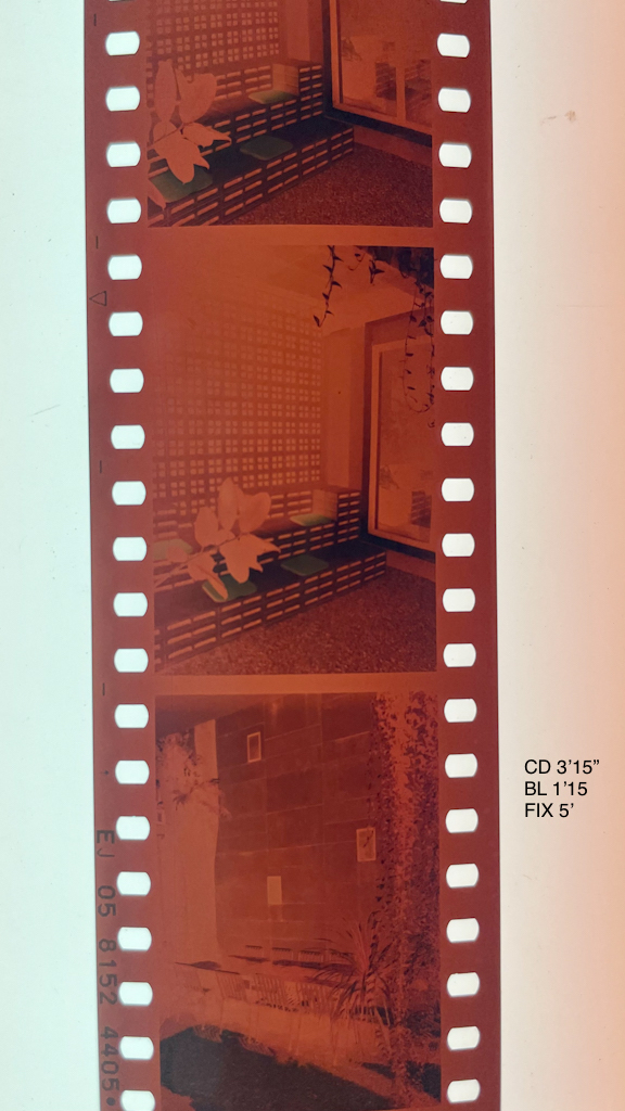

Attached are the negatives ..
i reshoot using the phone ..

Thanks for posting the negative strips as well. Is it possible to photograph them side by side in the same photograph? Your phone probably has chosen slightly different exposure settings for both shots now. However, by the looks of it, the left strip has a very significant amount of retained silver due to incomplete bleaching and fixing. This sort of thing does potentially explain the defect you ran into initially, as mentioned several times.
Be generous with bleach and fix times, then see how your next rolls go. There's a good chance the problem will stay away if you bleach and fix for at least 3 minutes each. Also be sure that the fixer isn't exhausted; either use it one shot, or replenish it as recommended by Fuji.
Yes, as @koraks already said, be as precise as possible with CD temperature (38ºC with constant agitation for C-41), remove remjet before CD, generous bleach and fix. You are close (no magenta negatives, lol), the rest of the problem is using wrong film in wrong conditions (tungsten balanced film for daylight) and scanning (out of the box, Noritsu scanner will not handle V3 500T very well).
