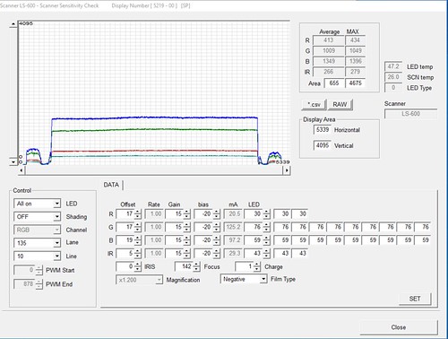

FOR scanner i got 2 scanner
LS600 noritsu and HS1800 .. im using both actually
but for the last pic im used the LS600

You should check your sensor:
if there is something unusual going on (like a very weak green channel).
Disable ICE while you are troubleshooting. You can also upload a full resolution raw file of the scan somewhere and I can check what I get from my EZ Controller.
