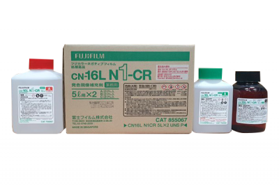

this is what i used. Fujifilm chemical
The CN16L range of film chemistry is a low replenishment rate chemical designed for the processing of all negative films compatible with Fuji minilab configured for the CN16L process. As in all range of film chemistry, the CN-16L comprises a Developer N1-CR , Bleach N2R, Fixer N3R and a Stabiliser N4R. The N1S Developer starter is used with the N1-CR to make fresh Working tank solution.
Those are chemical i used to process EC-2.

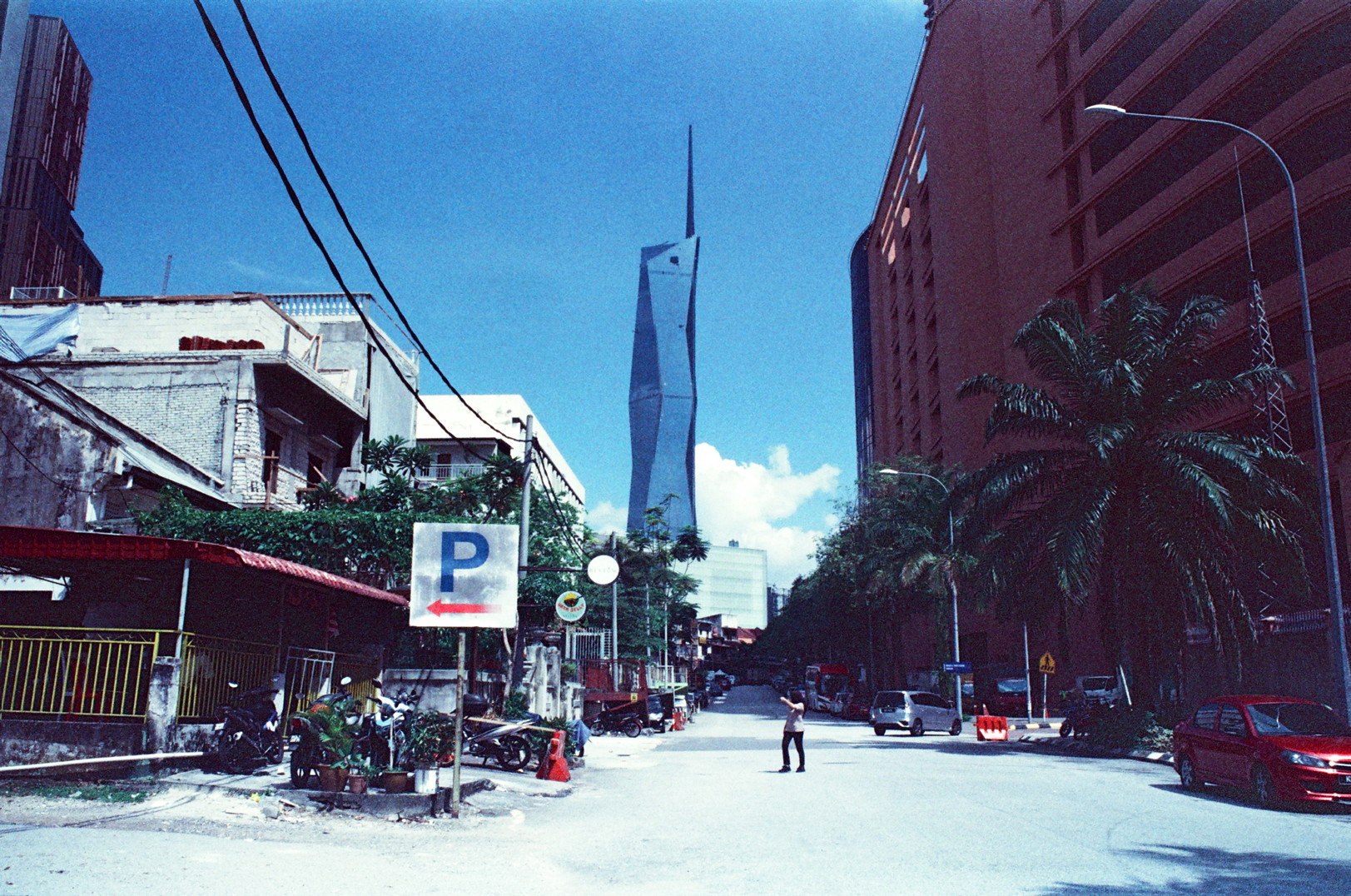

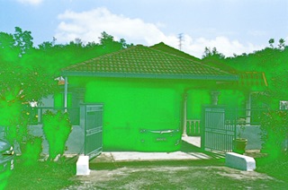

Hi everyone, im newbie here. Just wondering and looking for answer why and how can resolve
I developed my Motion Film Color , through ecn2 process. My chemical im using Fuji N1 (CD), N2 (Bleach) , N3 ( fixer). The formula 3’15” : 1’15” : 2’30” with temprature at 38degress a least.
After complete the process, rinse with N4 , and fresh water .
Surprisingly its doesnt turn into my expectation ..
Anyone can help me why its happen and guideline to solveView attachment 339488View attachment 339489
Are these images reversal of the actual negatives? These have some blue sky etc, this isn't the actual negative??
I may be a little late to this discussion but looking at the image the OP posted in #1. it would appear to me that they are scans of negatives with retained silver. (this is due to insufficient bleaching )
Did the OP re-bleach and re-fix these negatives?
I know the chemicals being used and they are designed for machine processing. Of course, they can be used for home developing, no problem, but the bleach and fix times would need to be extended. (in machine processing there is very vigorous circulation/agitation of the bleach and fix chemicals which can't be achieved in home processing)

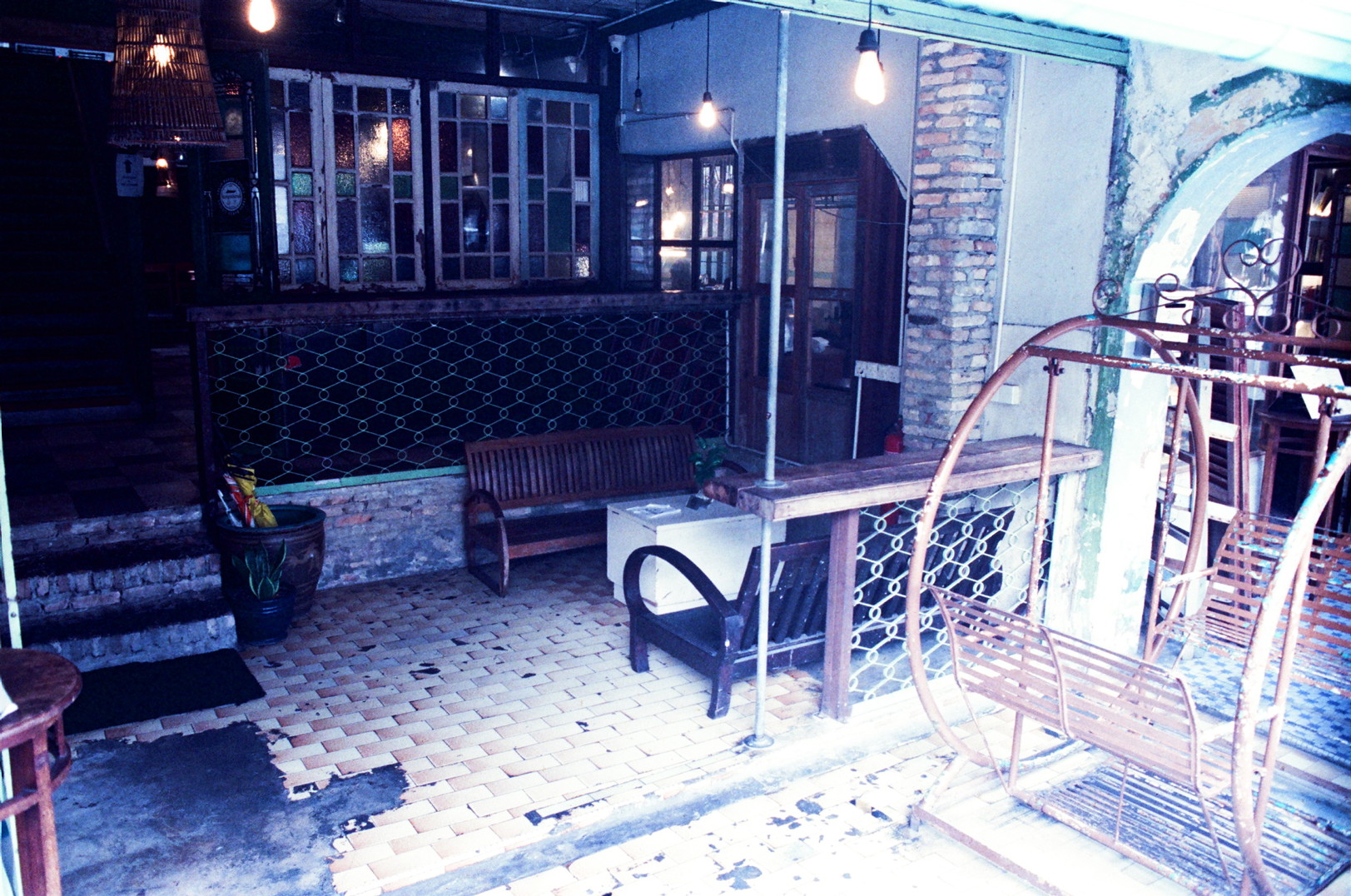

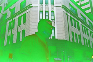

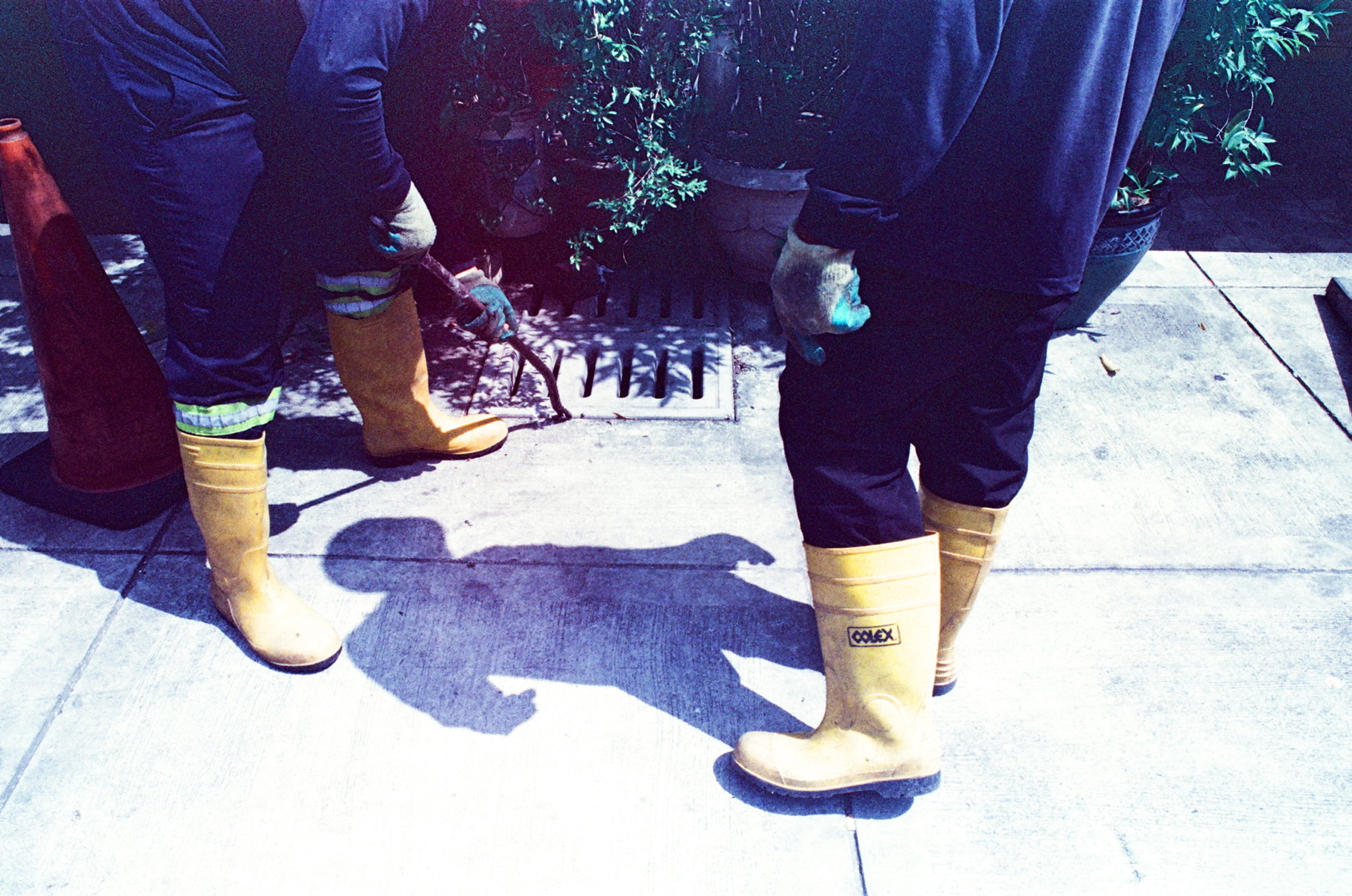

1st : using KV3 500T
timing : CD 3'15" -- > BL 1'15" -- > Fix 5'
Chemical temperature : 41degree.

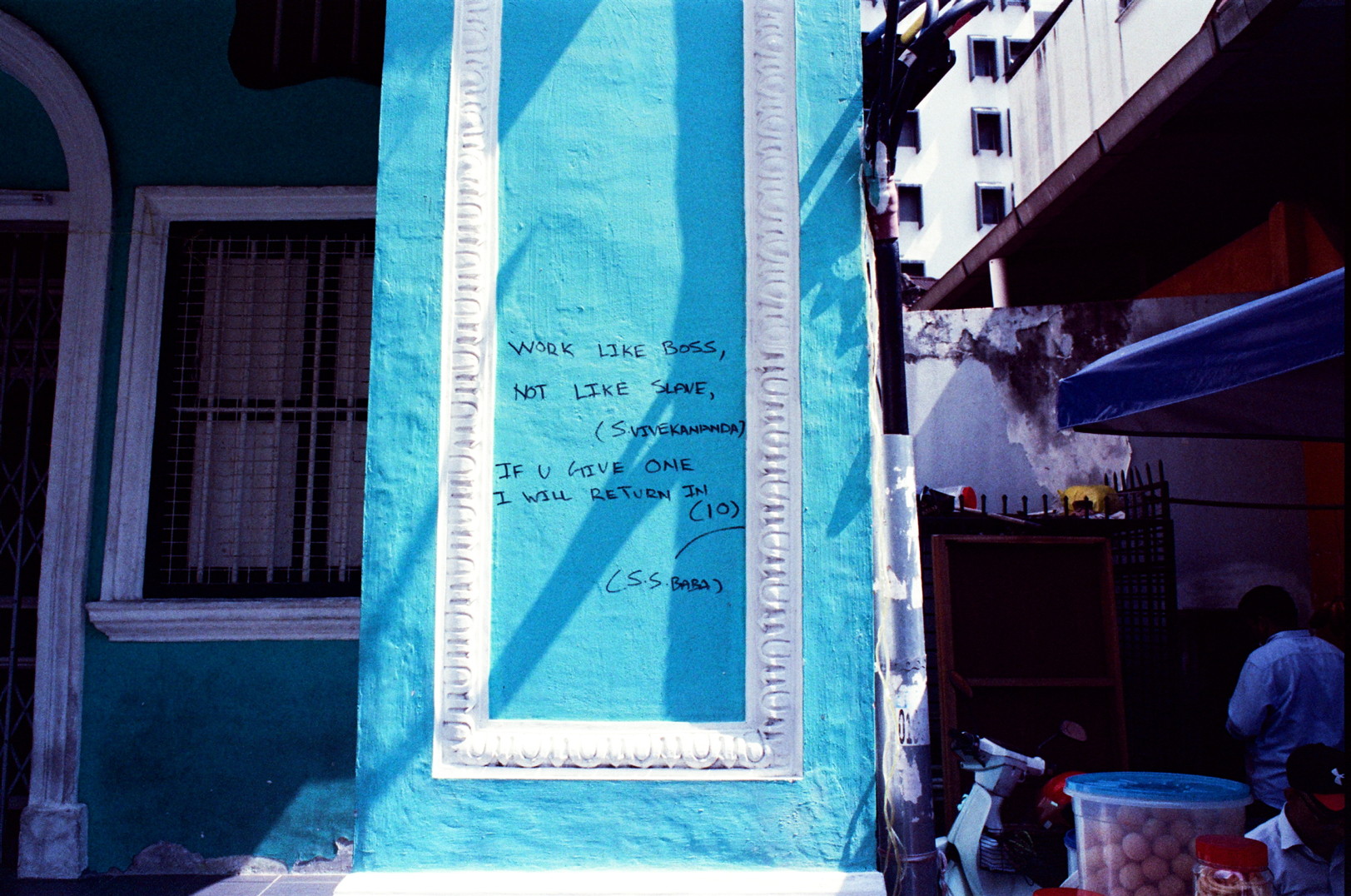

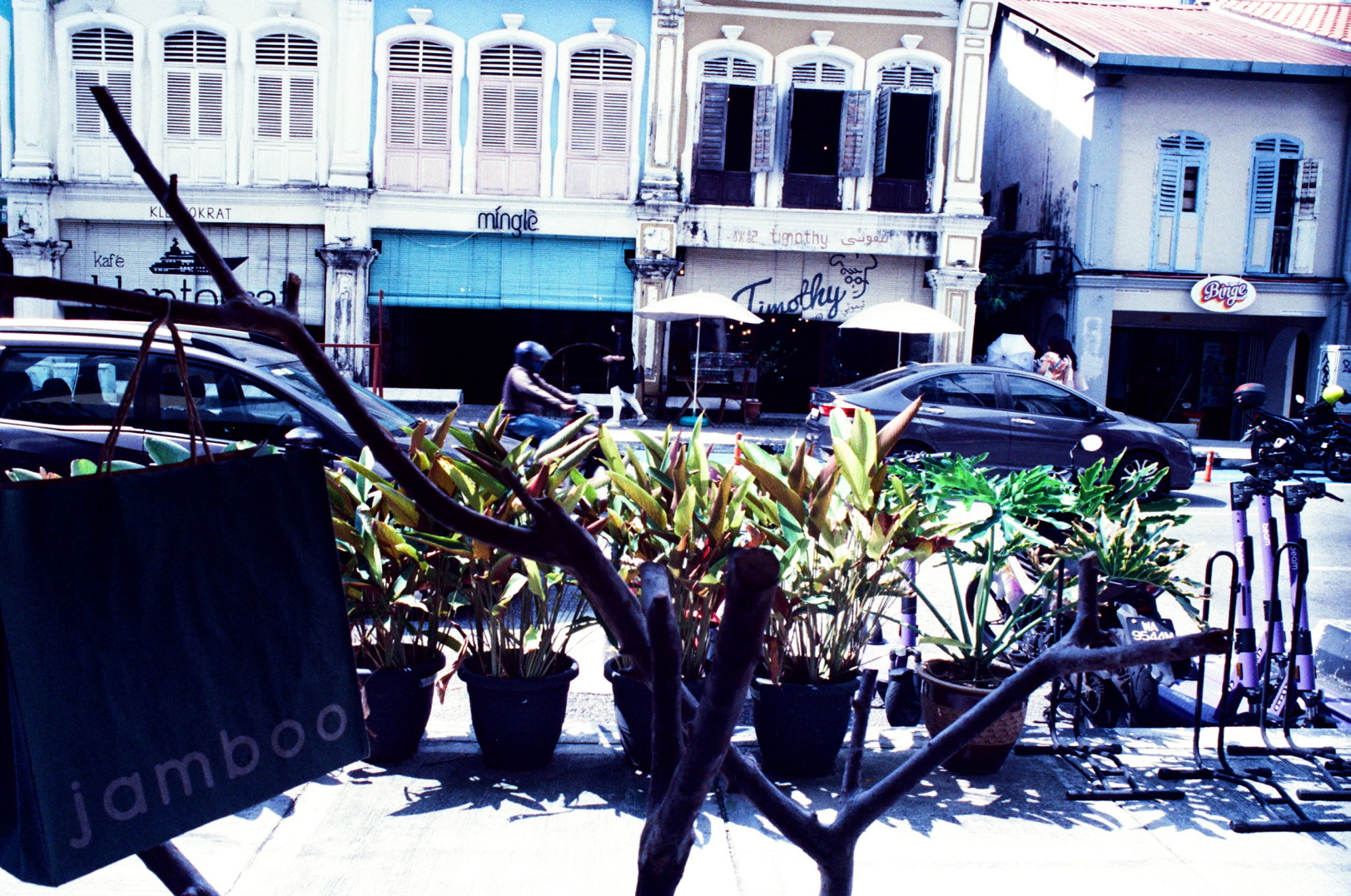

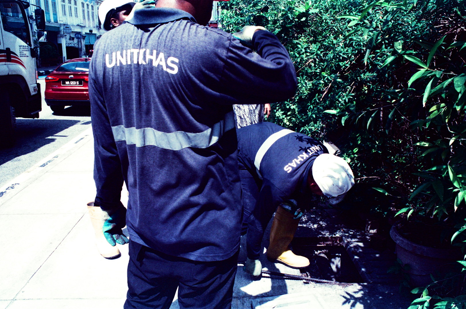

2nd : using KV3 500T
timing : CD 3'15" -- > BL 3' -- > Fix 3'

There is still a misunderstanding. You are using C-41 chemistry and you MUST follow the steps for this process. No matter you develop ECN-2 film. To use the ECN-2 process, you MUST use the appropriate chemistry. There is no "official" supplier of such chemistry BUT Kodak have published the recipe which is very simple. Separately - there are quite a few kits on the market that are more or less based on the Kodak recipe.
In your case - you need to develop on C-41 3:05 min at EXACTLY 38.00 degrees Celsius.
It appears to me, that the dark sections in these scans show much less reddish glow than in your first test run. Is this correct?
