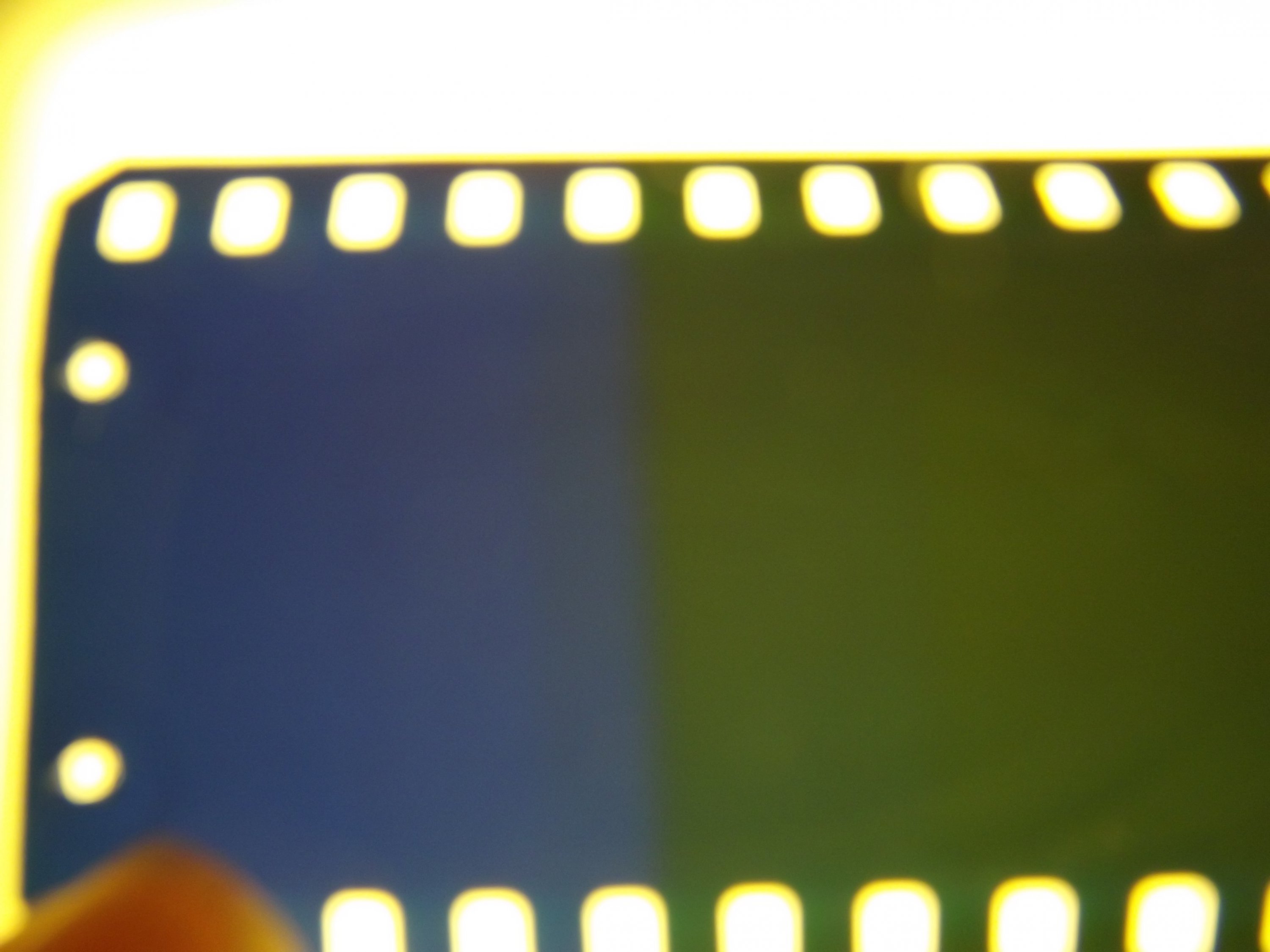

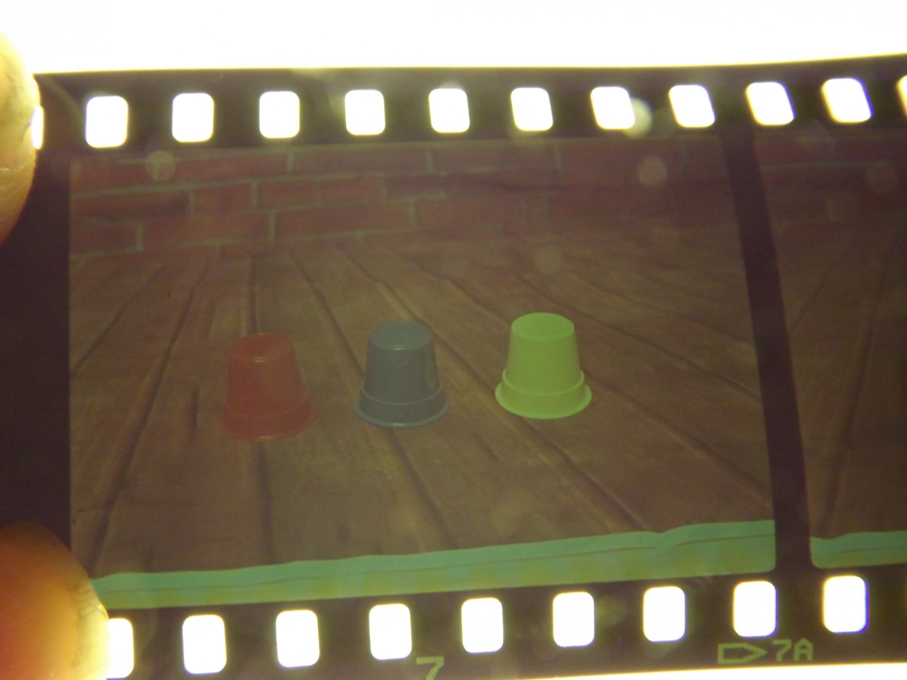

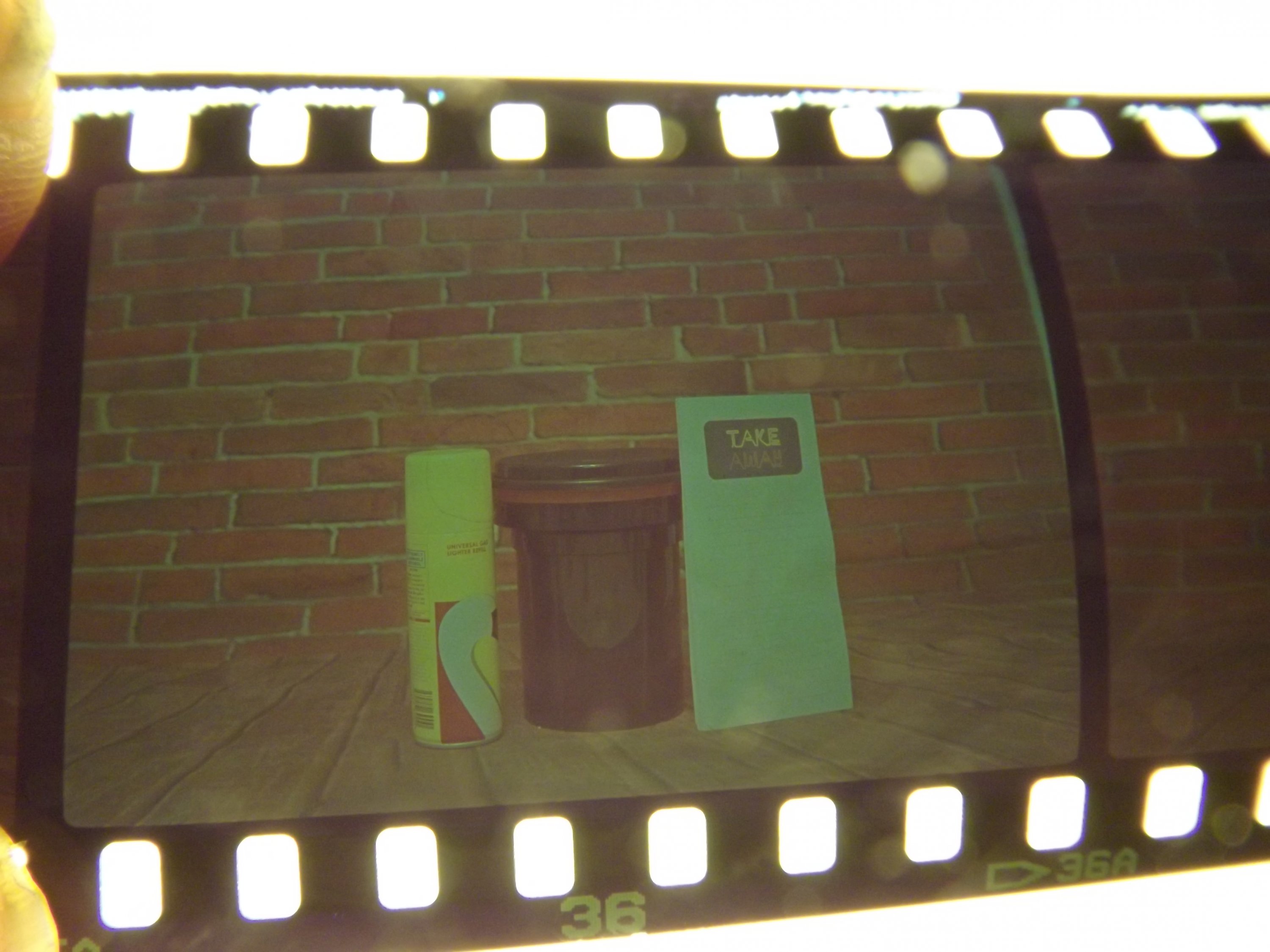

Hi PE,
I have been using ecn2 chemicals for this process, first developer...rodinal. The colours are very good, the problem is the film is really dark, needs the Cree led torch to see the images.
I have tried power exposing the film and also extending developer time, all at 38c. The attached precisa so far has given the best result, yet still very dark.
As I understand it slide film has no mask and should be white translucent in the film leader area. Mine are a range if colours. A deep Blue on the Boots slide film, the Kodak elite chrome has a dark brownish leader. The agfa slide has a dark grey mask!!!.
I have not tried c41 as yet, I have a large amount of ecn2, as I say the colours are pretty spot on, just the darkness of the film to deal with... Any ideas?.
Could the problem be in using rodinal as a first developer ?.
Would Derek Watkins first developer help with the issue?. If I can get/afford the ingrediants.
Any pointers/comments are more than welcome, would really help me.

The tests we have started on Provia 400 and Velvia 50 medium format.
The camera was a Lubitel 2.
I made hundreds of samples pulled gusset exposure and processed differently.
When we arrived at some pretty good results I bought a Kiev 60.
The best tests I showed them to a friend who has a photo center for analog film.
In Romania is about the only photographer who made classic photo.
After seeing tests tells me that it is better to do a test with fresh films.
I took from him E100GX Kodak - two films and he exposed for me with his camera.
The films exposed to gusset exposure, normal and ± 1 amperture.
He developed an film in original set Tetenel E6.
Me, I cut the end of film one piece for my experiment on the my E6 process .
My process compatible E6 does not go the same with any color slide film.
I presented the discussion here, post 20
Images here:
https://www.flickr.com/photos/21121448@N06/30599998764/
My process compatible E6 have a loss of sensitivity to the standard process.
Increasing time in black and white developer can solve this problem.
