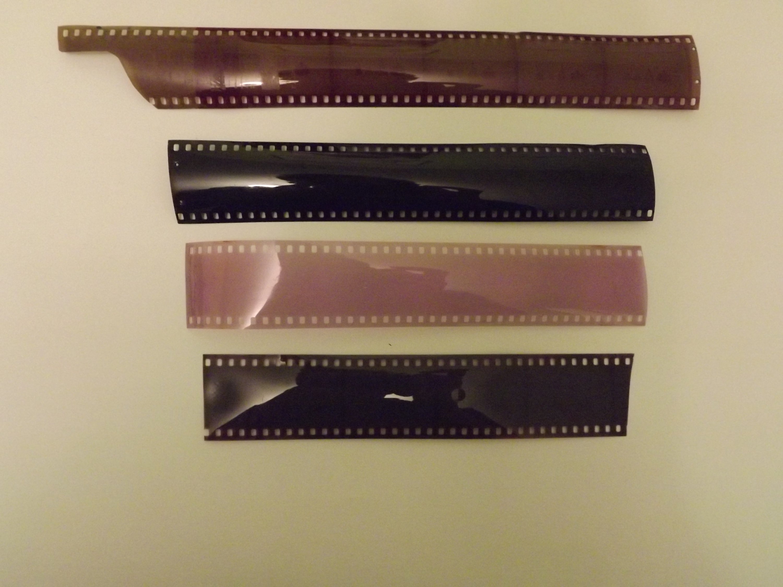

I did a few test earlier.
(266)... Rodinal 1:25 dev for 12 mins at 38c, followed by 5mins C41 dev, bleach and fix.
(268) Rodinal 1:25 with 4g sodium Thiosulphate added, then same method as first.
(267) Eukobrom 1:5 with 4g ST added, then same for rest of process as above.
(269) Eukobrom 1:2 with 4g ST added, then same as above but ecn2 CD.
(270) I get the idea that the first dev is the critical step and for the Boots Slide Film... ordinal and Eukobrom are No Good. I have used the Rodinal on Agfa slide and got much better results, but still have a grey foggy mask to the film, No whites, not even close. 2nd strip from top the rodinal, of use for a welder, or sun gazer.... not much else.

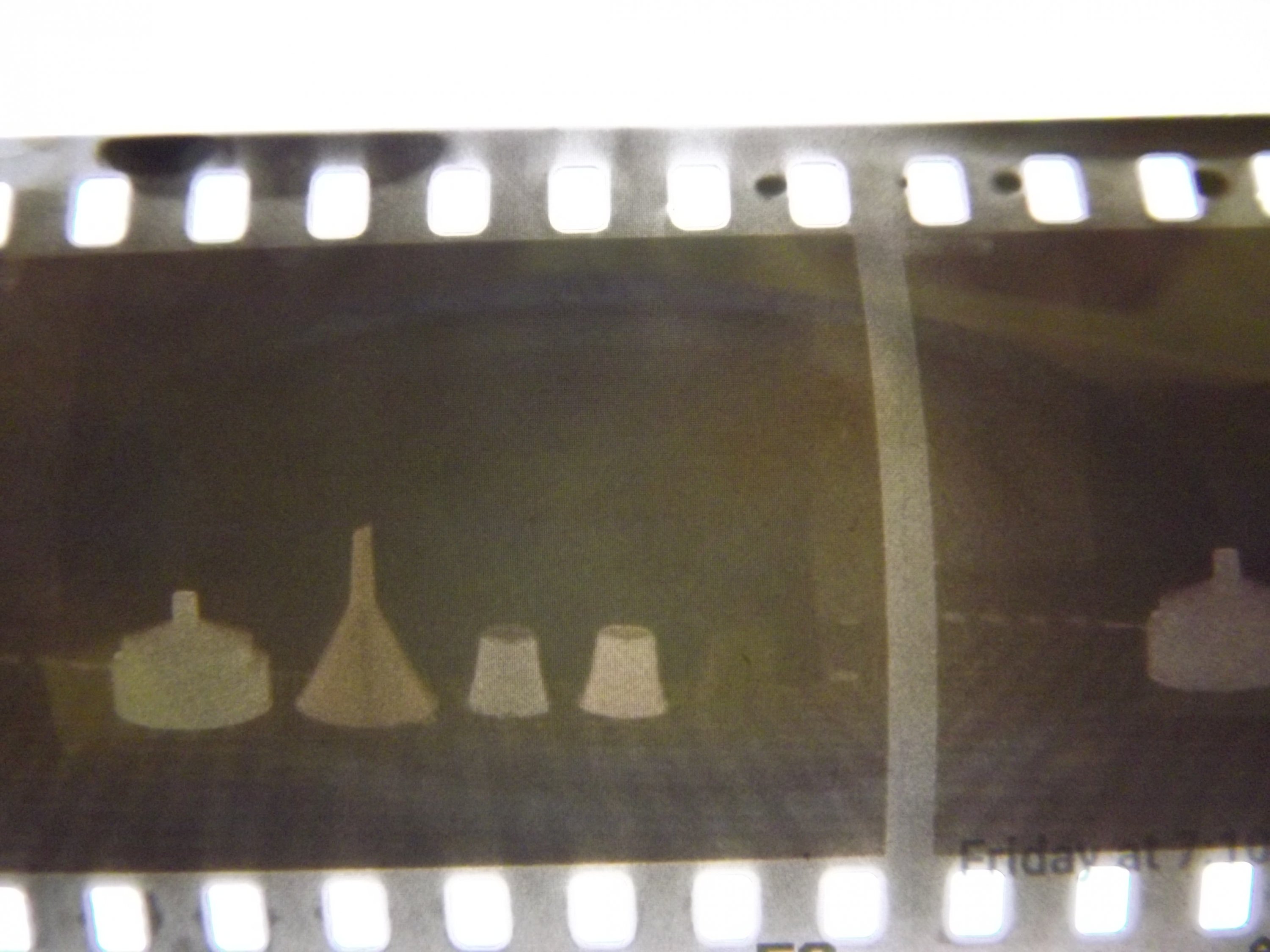

I'm having a few more attempts with the last of the boots slide film. This time I have mixed Silvermax with rodinal and added a few grains of the sodium thiosulphate. Only cannot find the thermometer so having to use my elbow to test the temp of the water. Should be alright.
To process slide film in c41 or ecn2 chemicals.
I see the sodium thiosulphate does a job of keeping the film from going dark, but it looks like it affects the yellow, takes it away. Is there something different I could use ?. I added about half a grammar of the crystals, maybe I should try even less , like .1 of a gramm.

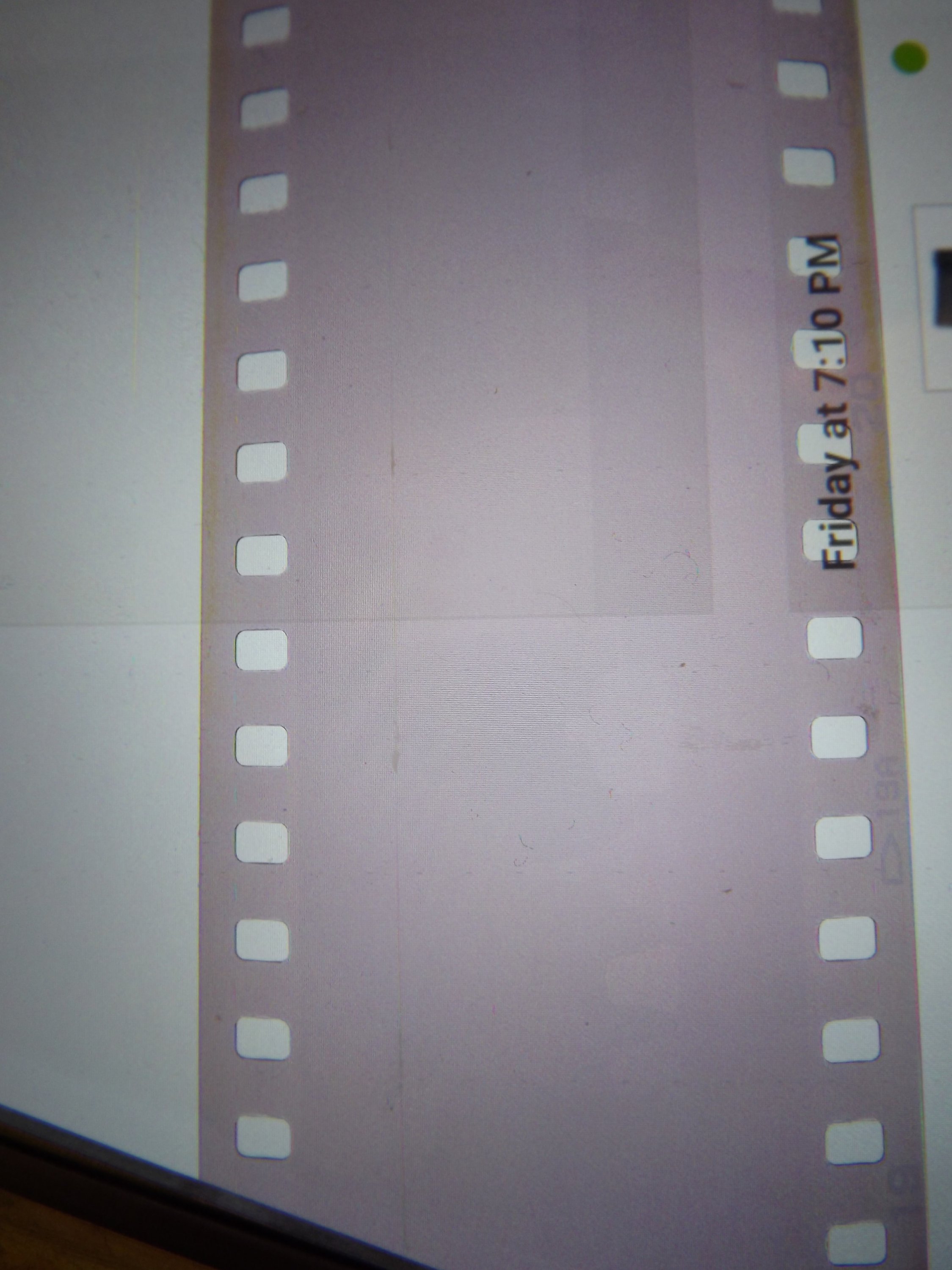

This is after the first dev.

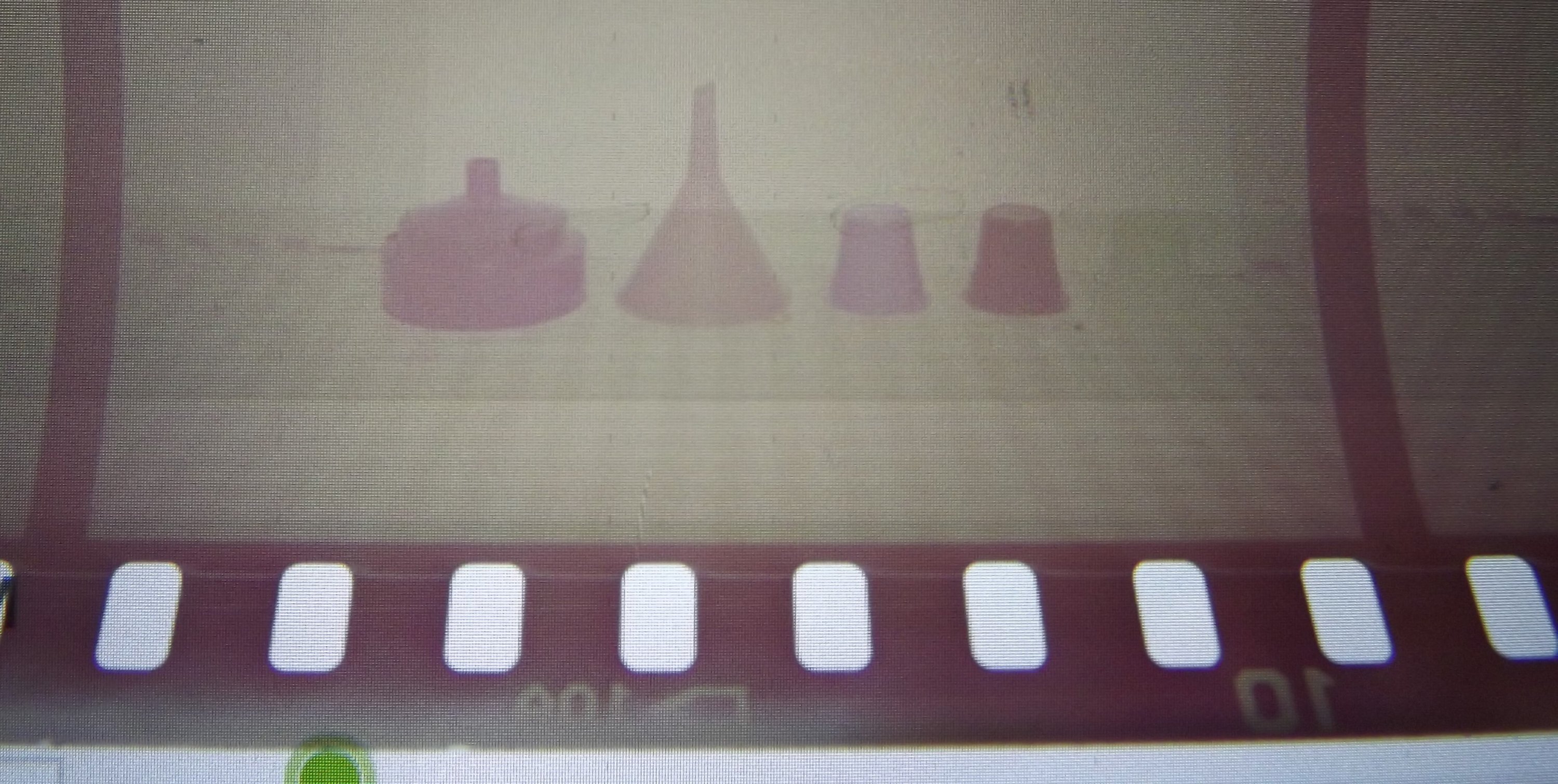

I just read that link. I would spend the $3.50-$5.00 by letting the film dry after fogging and then sending off to a lab. Now I'm really curious how well that would work rather than using a home c-41 kit.
Mogsby, that film does not look fully processed.
The clip I see posted by Mogsby looks like typical E6 film right after FD. It still contains some colloidal silver as antihalation layer and is therefore nearly opaque.
I think the problem comes from the lack of direct light in which you see the film.
After development black and white I see the film directly bulb.
Here the light is not behind the film.
Initially I thought that it is not sufficiently developed in black and white developer.
After writing Rudeofus, I realized I was missing direct bulb.
George

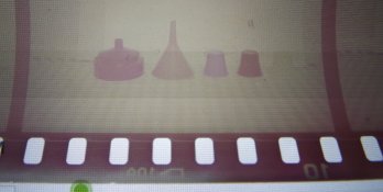

Sorry for the rubbish photos, I am looking for a low price scanner on eBay.

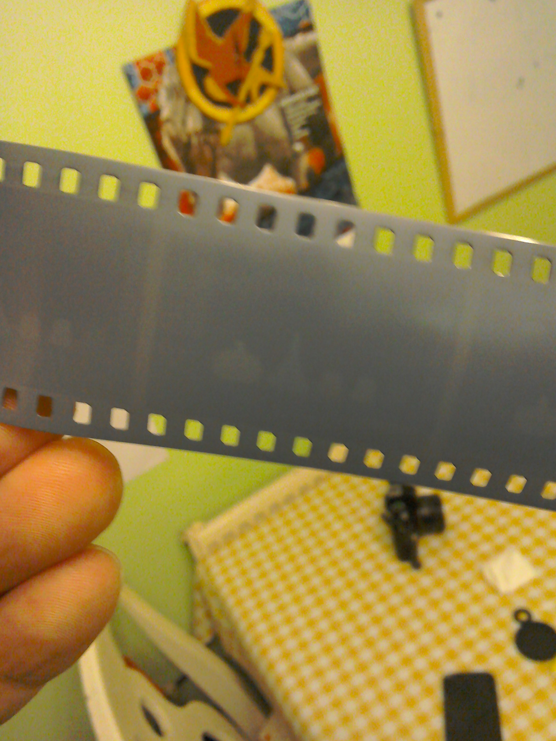

This is how the film came out after bleach and fix.

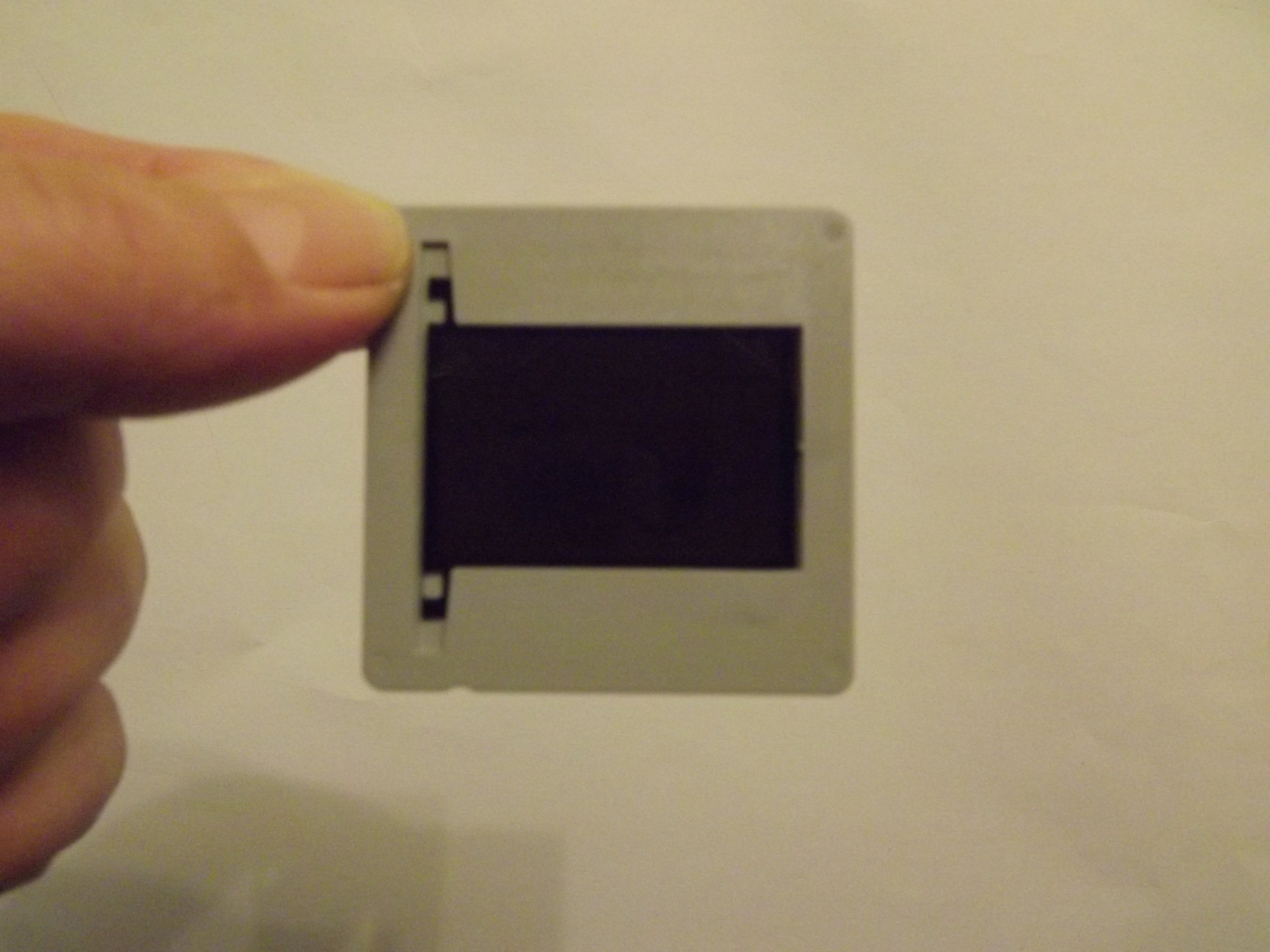

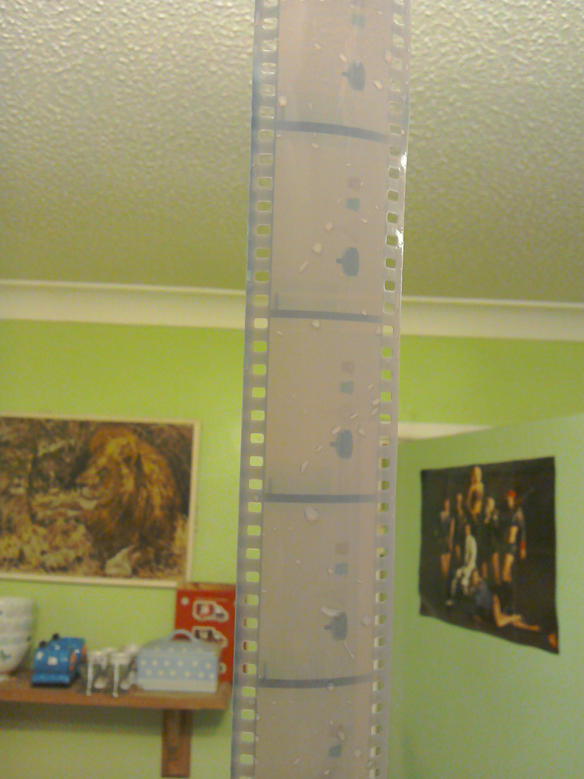

If I use rodinal without added sodium thiosulphate the images have full colour but the base of the film is very dark, no use for projection and the whites are not true white. If I add the S T to the rodinal, I get a clearer base but the colours are washed away, especialy the yellows. It gives the same result as using eukobrom.
PE
It was in the developer for half an hour, that came out looking underdeveloped. Maybe I am going the wrong way and a shorter developing time would work. Maybe I should try either a shorter dev time or greatly reduce the sodium thiosulphate.
George
I forgot to say that was the only way to show the image. With a light from behind the image was impossible to see.

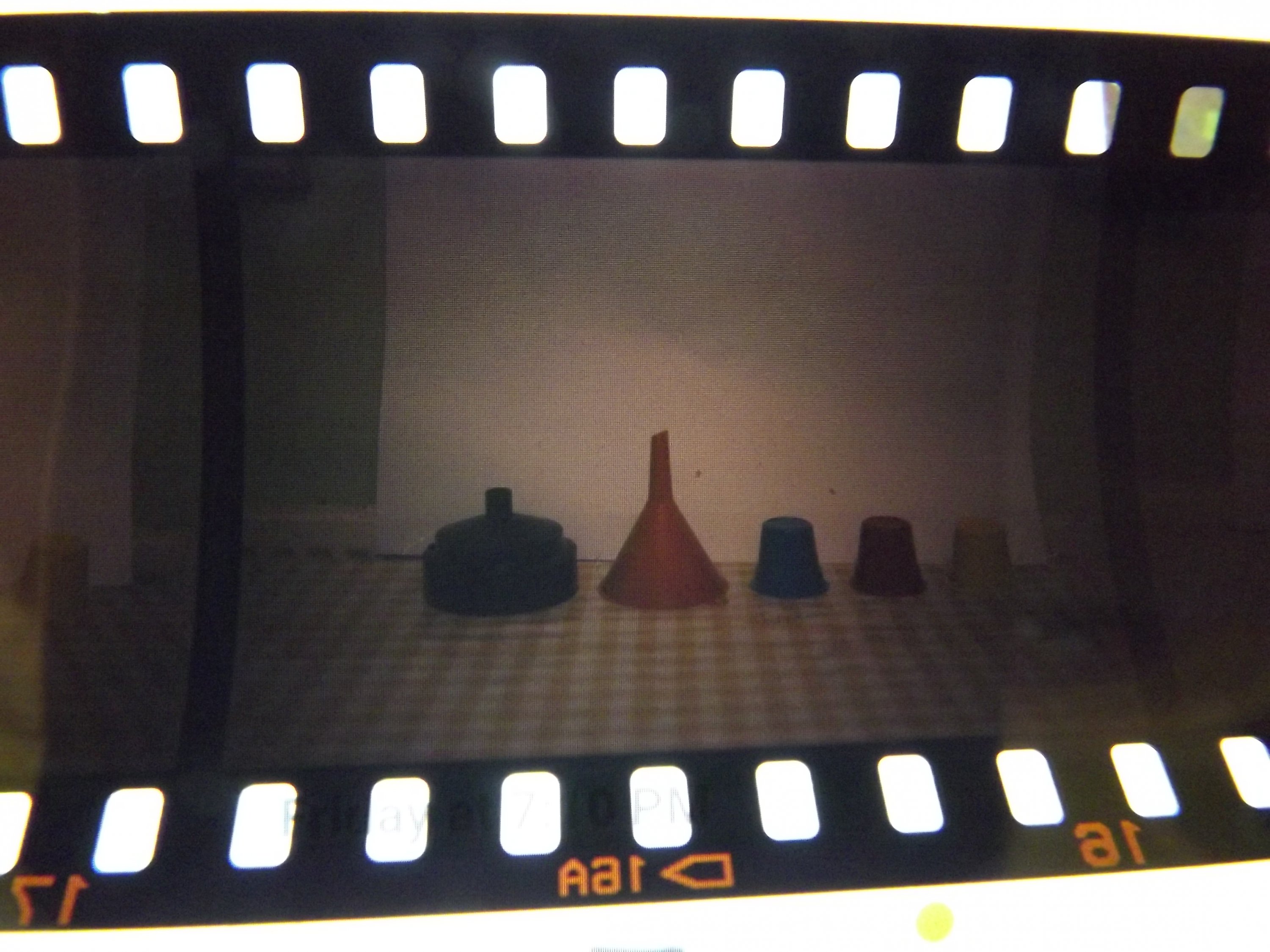

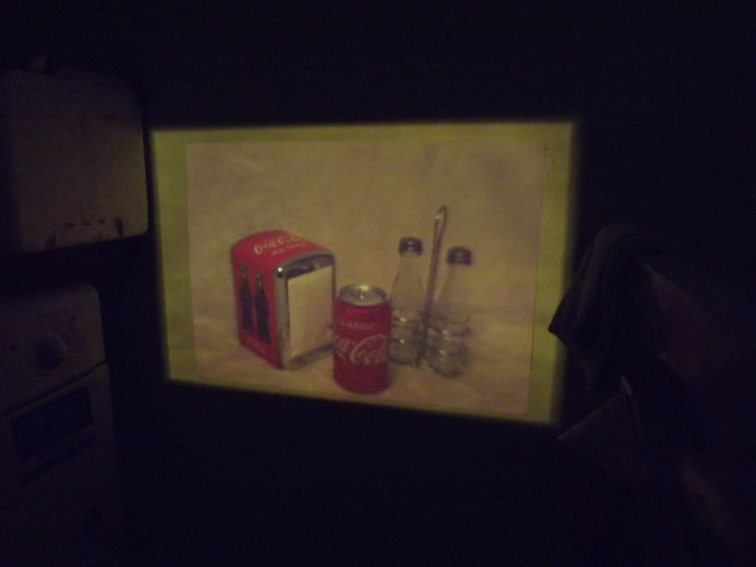

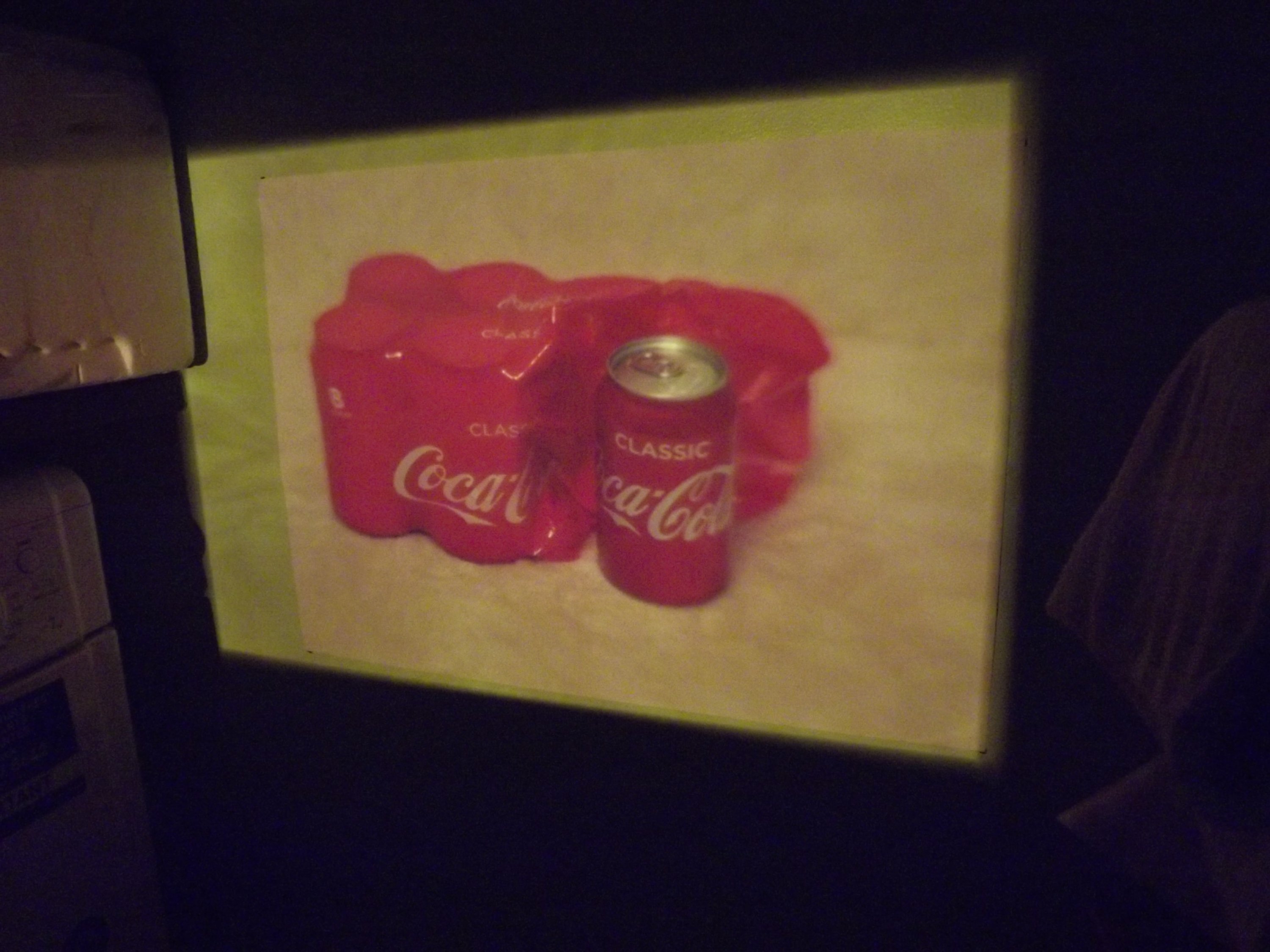

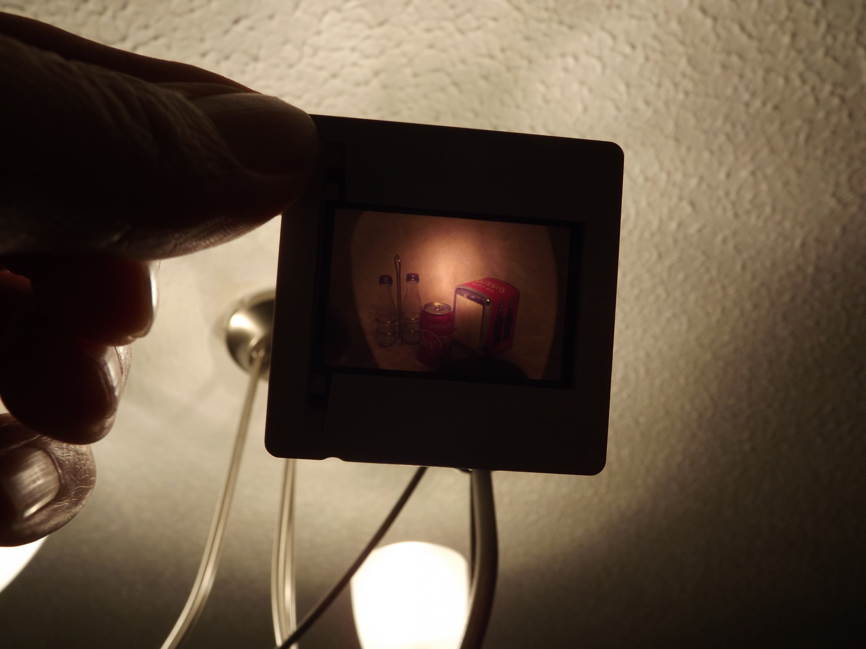

This Agfa precisa. 12 mins in rodinal at 38c followed by ecn2 process at 38c using basic ecn2 timings. The colour is not too bad, but the white is off. I think because the film has a dark mask type thing going on. The darkness is what I am trying to correct. The background on the slides is supposed to be light beige.

You continue with 4 g ST.
S T I suspect that is sodium thiocyanate?
Decrease your S T at 2 g or 1 gram to increase further your black level.
How to get a good black and white levels walk no longer in chemistry.
Give corrections only by time and temperature.
With time and temperature make small changes.
Pictures after first developer do not help us with anything as they are.
Can not draw a conclusion.
George
George

No matter what, if at the end of the process, the image is very dark then first development was weak and if light, first development was heavy. This assumes good film and exposure. That is a generalization for E6 films.
PE
