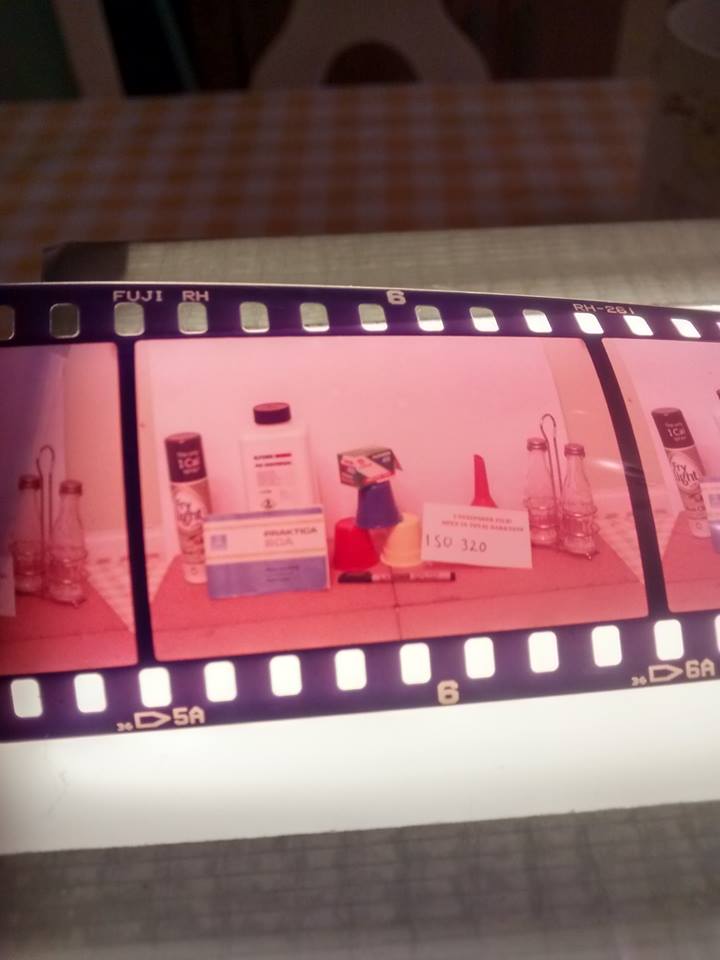

I have ordered some Atomal 49, will not be here till after the weekend. What strength did you mix the developer?, also what sort of temperature and time should I be looking at to start with, please.
Cheers
Mick
I used the standard concentrate which tells for example "for 1000ml".
Time was 12 minutes at 35 degrees C.
Isn't Atomal 49 made with CD-1? Shouldn't it already activate the couplers? (BTW A49 is my favorite BW dev, nice and fuzzy!)
I used stock solution Atomal 49 @38c for 12 mins, then another test for 10 mins.

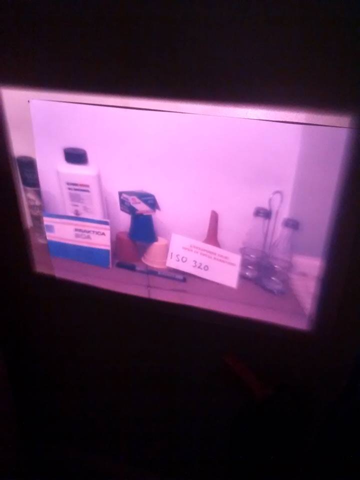

The Pink cast, yet the colours are closer. At least they are transparencies. I see after the first dev the image shows on both sides of the film under lights but not in front of lights. This is Fuji sensia. The next film I get is velvia, see how that works out.
2nd pic is 12 mins dev, 10 mins dev gave more density but a heavier cast.

We would be helpful to see a scan complete with perforation of the film.
From the pictures can not pull a firm conclusion.
You have a black open and white is purple?
To increase the black decreases the temperature or time in the first developer.
Purple dominant may come from contamination after color development?
You carry a amount of color developer in the next phase?
If we do not have a color scale speak talks.
Once you reach a good result you make and photos.
If you change the film to the next test what conclusion you can have?

I do not have a film slide scanner, because I want one, they are becoming expensive. Sods law!
I am glad you the Black is open, it has pink/purple in it. I tied a reduced time in the first dev but it made the situation worse. I am not sure of the cause.
I wash the film after every step, maybe not enough.
I do not have a colour chart to use in the photos for reference, I will look for a cheap one.
I hope soon I will get a good result, I try very hard.
I realise changing film is bad, it causes be pain, but I have a limited supply of slide film.
I have bought 6 x 36 exposure Velvia 50, I can stay with the same film for a longer time.
I keep trying till I get it right.
If you do not write to each test the time and temperature I can not guess what you did.
Logic says that shorter time in first developer give more dense film.
From you say that came out worse I do not understand.
The first investment you should do when you start doing tests is a pen and a notebook.
Scale color here and find out on matte paper - that's it.
When I make tests I was doing manually in dose and did so:
Insert the test of about 3 frames (clin exposure).
Insert the film in the first developer.
After 1.5 minutes (or as you want) put on a spiral identical exposure test.
That way you get with a single processing two different samples.
I could have a sample 7 minutes and one at 5.5 minutes.
If you do not have a scanner, put the film on a monitor or another source of diffused light and make photos in digital.
