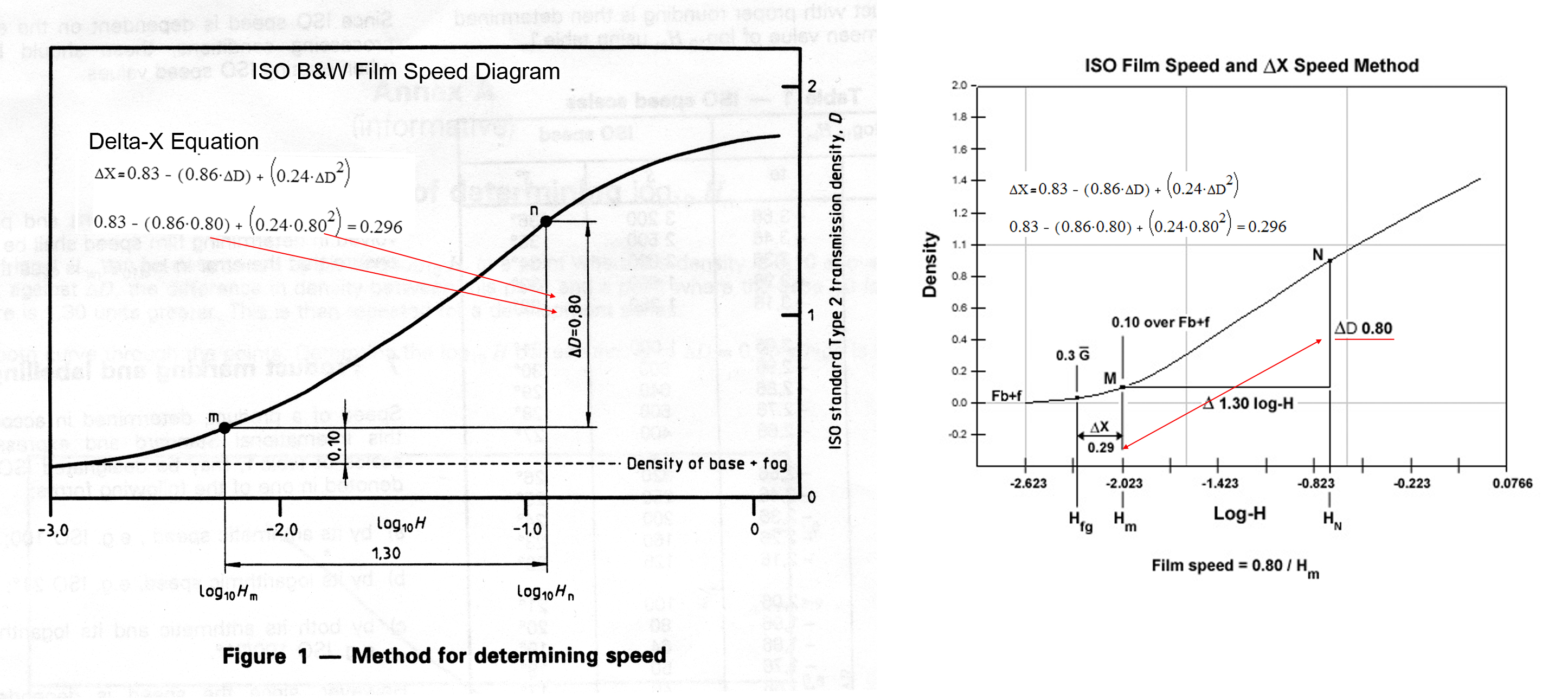

The ISO Film Speed Diagram is used to determine film speed and not exposure placement. It is a graphical method of the Delta-X Criterion. Fractional Gradient speed point is derived by psychophysical testing and produces the most consistently accurate B&W film speed. When the ISO diagram's parameters are adhere to, the difference between 0.10 over Fb+f is always Δ0.296 log-H from the fractional gradient speed point.
Any point of density is not an adequate way to determine consistent print quality.
If you are interested in better understanding film speed, I suggest checking out these two papers. This forum has a number of ways you can obtain them.
Nelson, C.N., Safety Factors in Camera Exposures, Photographic Science and Engineering, Vol 4, No 1, Jan-Feb 1960.
Nelson, C.N. and Simonds, J.L., Simple Methods for Approximating the Fractional Gradient Speeds of Photographic Materials, JOSA, Vol, 46, No. 5, May 1956.
Of course the ISO method is not perfect... Probably the ISO method was designed to provide the greatest conceptual simplicity still offering the important information for most of the films. This Delta-X Criterion looks a more refined way, but the ISO method says the exposure that (in standard conditions) places -3.33 spots at 0.1D (over F+B) providing a very plain explanation, IMO that conceptual simplicity is the strong point of the ISO method. Also ISO method is the one.
My understanding is that the Delta-X Criterion can have an advantage if we want to understand what happens when pushing.

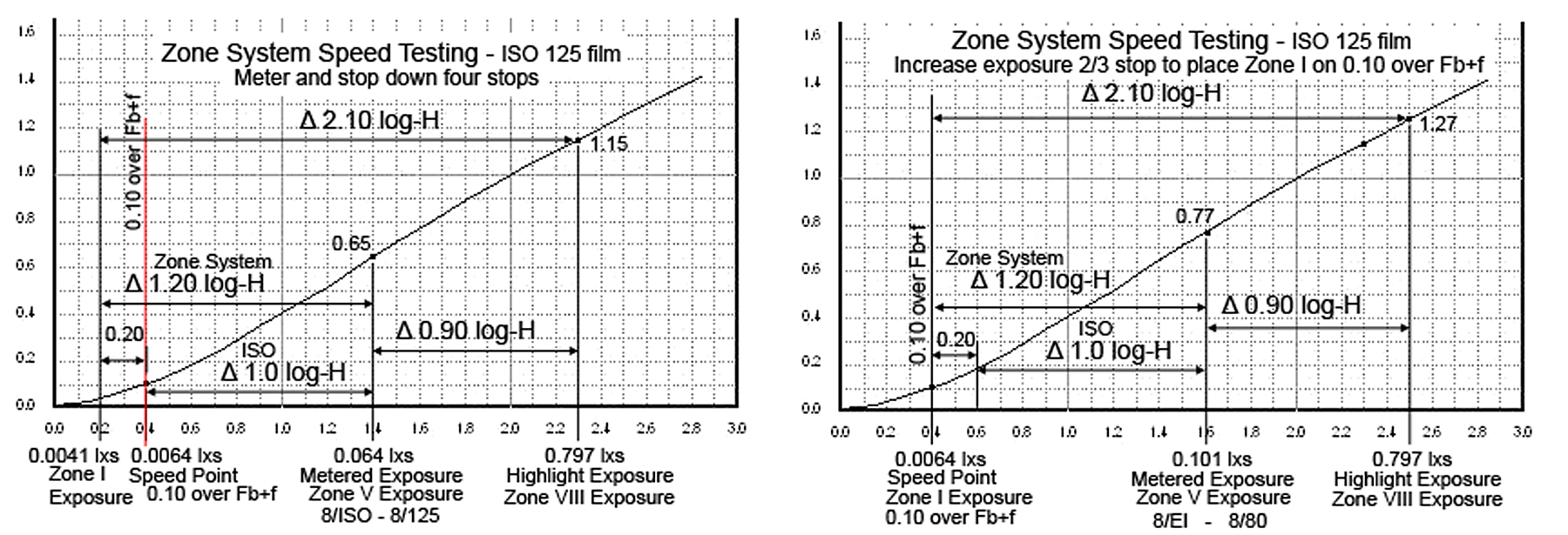

Bill, what is clear is that today the ZS table is inconsistent with box speeds... in nominal terms. (if we use a personal speed then we simply do what we want)
Z-I was stated (by Ansel Adams himself) to have 0.1D (over FB), if we use Box Speed and we meter for Z-V (stated to be a 18% grey card) then our Z-I won't be at 0.1D as it will be pure black, a -4 underexposure is lower than the the Speed Point exposure by a fair amount, you in particular are proficient in film calibration, so no need to insist in that...
Even if metering/exposing very accurately, even if performing a lab grade ISO calibration... we won't get the Z-I detail if we use the perfectly calibrated ISO speed for ZS, we have to shift a zone or to use half the EI!
IMO that speed change generated an incredible amount of confusion for the ZS, as ZS table was not changed we have 3 choices:
1> Using (Nominally) half of the Box Speed.
2> Exposure compensation +1
3> Shifting a zone, so expecting start having detail in Z-2 instead Z-1 which will be pure black.
Nominally:
With 1 and 2 we expose like Pre 1960, we overexpose the neutral 18% grey by +1 (in modern terms) and we have 4.33 stops shadow latitude.
With 3 we have 3.3 stops shadow latitude, and our 18% mid gray is exposed 0+/-. Our Z-1 is in the speed point so staring to have detail.
The question is: Do we aim a 3.33 or a 4.33 shadow latitude ?
These two graphs might help visualizing the situation. The graph on the left shows the relationship between the metered exposure point and the 0.10 over Fb+f, but mostly where the Zone System's four stops down from that point will fall. The graph on the right show what needs to happen to bring up the Zone System Zone I, four stops under the metered exposure, in order for the exposure to fall on 0.10 over Fb+f. Everything shifts to the right. As 0.10 doesn't necessarily represent the ideal shadow exposure and in truth there really isn't one. Notice flare isn't factored in. Interesting enough, Zone System in camera testing with a single toned target in effect doesn't incorporate flare either, but while one does eventually factor it in (with ISO film speed, it is part of the underlying determination), Zone System never does.

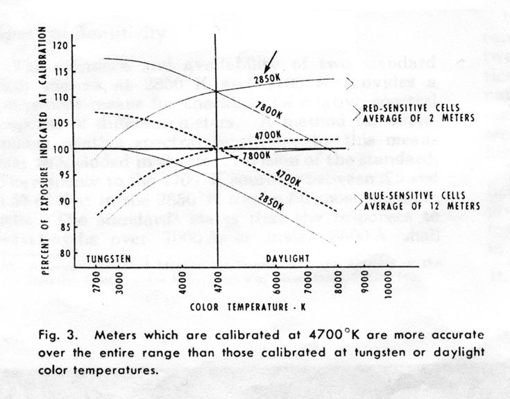

As far as I know, The Zone System never defines the type of light for the test. Some shot outside in the shade, some in the sun, and some indoors with incandescent light.
Another is the use of a meter. Adams had a conspiracy theory that the meter manufactures nefariously incorporated a K factor into their meters. Whereas the K factor is a variable in the meter’s exposure equation to compensate for light loss inherent in the system and introduced by the physicality of the exposure meter. The camera exposure equation uses a variable (q) that factors in assumed average conditions. If the conditions differ, so does the test results. This doesn’t generally matter in actual shooting conditions, but testing needs to eliminate as many variables as possible.
Through the lens metering doesn’t require the same type of K-factor because it measures the actual light passing through the lens. All meters use some material that has a photo-voltaic response to light. None consistently respond the same to all wavelengths.

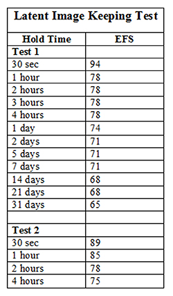

And finally, there is hold time. Film speed will tend to drop off in the period between when the film is exposed and when it is processed. Most of this occurs in the first few seconds, but it will continue at a reduced rate and then plateau. The ISO standard prior to 1993 had a hold time of 2 hours, but the currently ISO standard has a hold time for professional film of between 4 hours and 7 days and 5 to 10 days for amateur film. Zone System testing never mentions a hold time.

@ChristopherCoy I just pick little bits here and there.
For example hold time... I knew there was a hold time but hadn’t seen how many minutes or hours it’s supposed to be.
Bill,
I did a latent image keeping test years ago. Sheets of T-Max 100 4x5 were sensitometrically exposed using a calibrated sensitometer at the intervals listed below, and stored at room temperature. All the film from test 1 was run together, as was test 2. They were processed in a Refrema dip and dunk using seasoned T-Max developer.
Stephen
