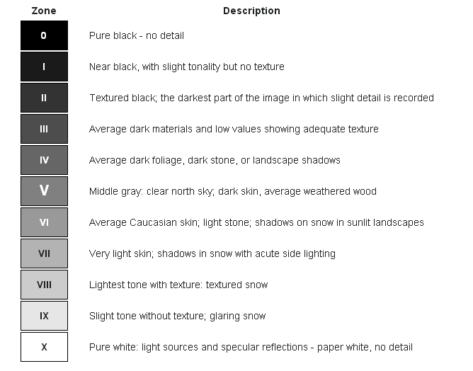

Michael, at the end we disagree only by 1/3 of stop... but ZS table specifies middle gray for Z-V, this is the key reference IMO:
Obviously that table became obsolete post 1960 because of the Box speed change in the norms, because the meter started aiming x20 the light in the speed point instead x10, so IMO formally for ZS metering we have to use a full 1 stop correction, not 2/3. Pre 1960 photograpers were instructed to meter Z-V at 0+/-, not +1/3 ....
So historically and formally (IMO) the correction is one stop, still using that 2/3 will underexpose (compared to 1959) by 1/3 stop, which is mostly irrelevant in practice.
Obviously that table became obsolete post 1960 because of the Box speed change in the norms, because the meter started aiming x20 the light in the speed point instead x10, so IMO formally for ZS metering we have to use a full 1 stop correction, not 2/3. Pre-1960 photographers were instructed to meter Z-V at 0+/-, not +1/3 ....
... So ... let's see ... First, the Zone System speed point is a fixed density above film-base+fog. It has nothing to do with pre- or post-1960 anything. It's its own thing and, as Michael points out, deviates from ISO speed (and earlier ASA speeds) due to the different methods of determining the speed point. It is a convenient simplification of film-speed testing that delivers good negatives. Don't try to correlate the ZS speed point with other, differently determined, speed points.
Second, Zone V falls where it falls after you've determined your speed point, established a working E.I. and found a development time for "N" that puts Zone VIII in the right place. It, by itself, is not a calibration point, and can, in practice, vary from 18% middle grey significantly, even with "N" development. Additionally, Zone System expansions or contractions are going to move Zone V around by a lot; a Zone or more with extremes. Anyone who has made Zone Rulers for their particular film/developer/paper combination knows this just from looking at the stripes on the paper.
Your chart is an idealized description of "N" in the Zone System, not an actual print of anything. Still, as far as a guide to what "N" development should be (according to this 10-Zone model) it is still perfectly valid and relevant, regardless of the change in "box speed" determination around 1960.
