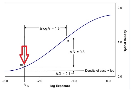

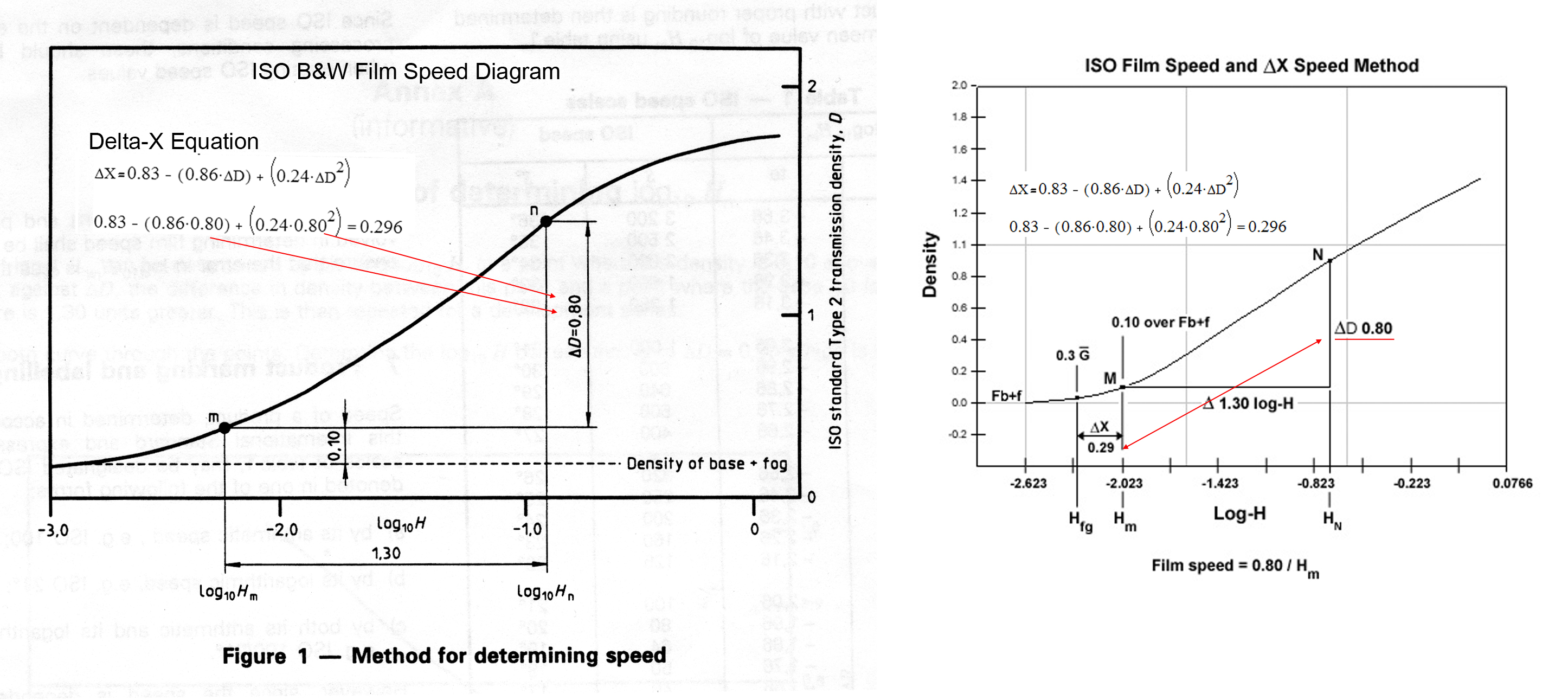

>Today we calculate speed like this:
> Pre 1960 that 0.8 was a 0.4. Impossible to tell it easier. If Z-I is 0.1D + FB... then you have to rate film to the half to conserve 0.1 at Z-1. Kid's math...

>> B+F for Z-0, no detail
>> 0.1+FB for Z-1
If standard ISO development:
>> Add 0.185D for each additional Zone
>> For Z-V add 0.8D to the density in Z-I...

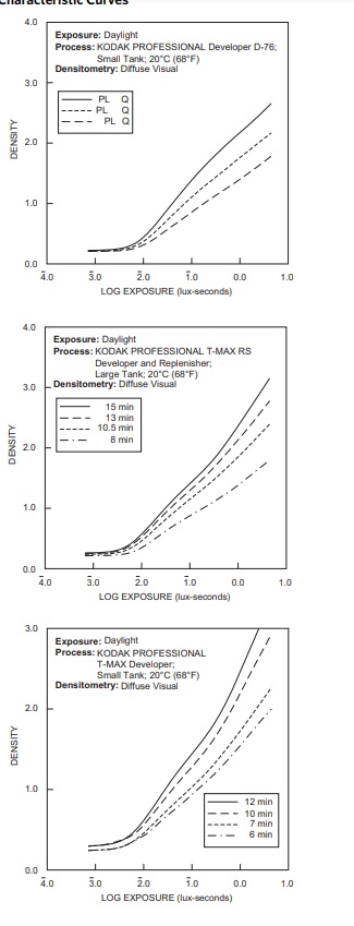

Doremus, the ISO speed provided (by principal manufacturers) do apply perfectly, Kodak graphs in the dataheets have absolute Lux.Second units, so it's totally precise information.
Of course your particular procesing may vary the Speed Point (exposure for 0.1D+FB) by some 1/3 stop exposure, but not by 1 stop or the like, what probably you adjust.
Kodak tells you that (developed with D-76) gray spots at 3.33 underexposure will deliver around that 0.1D+FB, and belive me, they are not wrong. If you use HC-110 then it would be 3 stops, and if you use Xtol it would be around 3.5.
Of course one may test all what he wants to correct his own repetitive errors...
What you don't understand in these graphs ?
They tell you exactly at what exposure you'll get the Z-I in lux.second, so what your meter has to aim. It's about knowing how to read datasheet, and predicting the (max) 0.3 stop shift from the developer kind, at that point we all know if a particular developer will gain or loss a (mostly irrelevant) 1/4 of stop.
We may have some variability for the constrast index (agitation, temperature, etc)... but Z-I exposure is precisely known from datasheet !!!

Doremus, the ISO speed provided (by principal manufacturers) do apply perfectly, Kodak graphs in the datasheets have absolute Lux.Second units, so it's totally precise information.
Of course it's totally precise information. The thing is, it doesn't necessarily apply to a particular practical application. I don't have Kodak's meters. I meter real-life things in lots of different lighting; my readings aren't going to be anywhere close to as precise as Kodak's when it comes to getting the same amount of photons onto the film. I'm aware of that. I certainly believe Kodak gets the results they get. I simply cannot duplicate that. Nor can you.
Of course your particular processing may vary the Speed Point (exposure for 0.1D+FB) by some 1/3 stop exposure, but not by 1 stop or the like, what probably you adjust.
Just one of many variables that can influence the total outcome and just another reason to do one's own testing and arrive at a personal E.I. FWIW, some contractions require even more than a stop of compensation. But even if we're talking "Normal" development, developer choice and agitation method can deviate from the ISO standard development by a significant amount.
Kodak tells you that (developed with D-76) gray spots at 3.33 underexposure will deliver around that 0.1D+FB, and believe me, they are not wrong. If you use HC-110 then it would be 3 stops, and if you use Xtol it would be around 3.5.
Yes, I believe Kodak can do that. And, with my much-less-precise metering, etc. I can easily get within a stop or so of that. I'd just like to refine that a bit. You seem to think that we photographers have equipment and conditions that can duplicate Kodak's laboratory results. That's simply not true. We're lucky if we come close.
Well, I don't know if I'd call deviations from Kodak's lab results "errors." I do as well as I can with what I have. My Pentax spotmeter has flare that influences the shadow readings. I'll bet Kodak didn't have that problem. I've also got flare from other sources (camera bellows, enlarger, etc.) that needs to be compensated for; Kodak didn't have to do that either. Etc., etc... The point is, I'm not "correcting" anything, but compensating for the real-life situation that I find myself in. If I have to rate my film a couple thirds of a stop differently than ISO standard to get consistently better results, I'm going to do it.
I understand the graphs. They're great for comparing films and learning about a specific film's characteristics. Still, they don't help me with a choice for rating my film speed in my particular situation.
They tell you exactly at what exposure you'll get the Z-I in lux.second, so what your meter has to aim. It's about knowing how to read datasheet, and predicting the (max) 0.3 stop shift from the developer kind, at that point we all know if a particular developer will gain or loss a (mostly irrelevant) 1/4 of stop. We may have some variability for the contrast index (agitation, temperature, etc)... but Z-I exposure is precisely known from datasheet !!!
I really do believe that x-amount of lux-seconds will get my x density on x film with x developer for x time with x agitation. Really, I do. I'm just not able to measure light and expose that precisely in the real world. My meter isn't Kodak's, and it doesn't read the same nor is it as precise. (If you've got a light meter that works that accurately in practice, I'd love to get my hands on one!)
So, how do I get my meter to match Kodak's? Well, I can never be that precise, but I can come up with an average value based on lots of metered shadows that allows me to find a factor to change my meter settings so that, in general, I get similar results. It's called a personal E.I. It is not based on sensitometry, but from my personal negatives and my particular meter.

The ISO Film Speed Diagram is used to determine film speed and not exposure placement. It is a graphical method of the Delta-X Criterion. Fractional Gradient speed point is derived by psychophysical testing and produces the most consistently accurate B&W film speed. When the ISO diagram's parameters are adhere to, the difference between 0.10 over Fb+f is always Δ0.296 log-H from the fractional gradient speed point.
Any point of density is not an adequate way to determine consistent print quality.
If you are interested in better understanding film speed, I suggest checking out these two papers. This forum has a number of ways you can obtain them.
Nelson, C.N., Safety Factors in Camera Exposures, Photographic Science and Engineering, Vol 4, No 1, Jan-Feb 1960.
Nelson, C.N. and Simonds, J.L., Simple Methods for Approximating the Fractional Gradient Speeds of Photographic Materials, JOSA, Vol, 46, No. 5, May 1956.

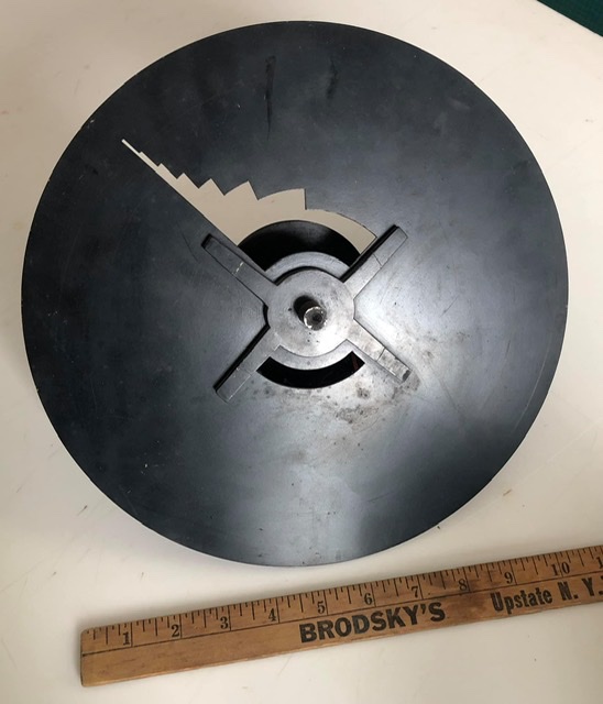

I’m still looking for a print of Willow Pond, but Mark Osterman retired from George Eastman House. He was my best bet for possibly finding one.
He did sell me this nice sector wheel though... I am thinking of using it under my enlarger driven by an 8mm projector to make “test strips”
Years ago I tried to get a print too, but even before the digital revolution, Kokak was cutting back. They no longer had an archivist or librarian. No one knew where to look. I did get a nice information packet on Loyd Jones. It included a head shot of Jones.
