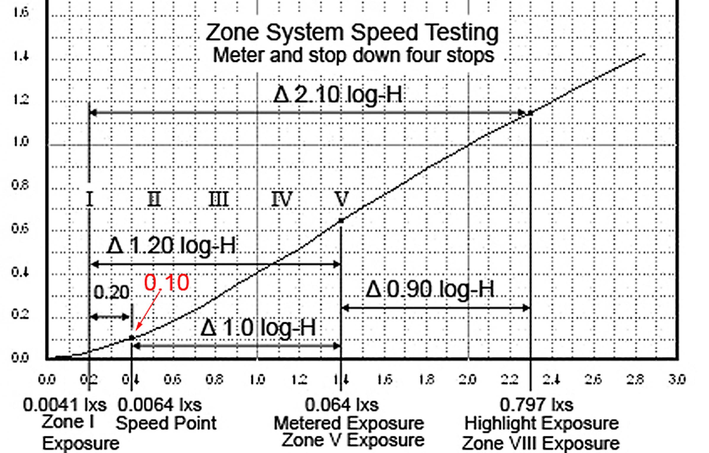

All I've been saying is that the level of precision with ISO speed testing is far greater than what any photographer can do. It also takes into consideration variables that I'm pretty certain most people don't. What's wrong with using the ISO speed as a knowable starting point. I believe this approach can yield a good working EI fairly quickly.
I'm not advocating ultra-precise testing methods or criticizing people who do their own testing. Although there are good tests and bad tests. Just because someone comes up with a result doesn't automatically make it a good test. How many times has someone claimed that their picture test showed film A was contrastier than film B in a certain developer, yet they never actually determined the contrast / gradient of either film. The obvious answer is that film A was developed to a higher contrast, but unaware our intrepid tester confidently walks away with his new hard earned knowledge. I try to make people aware of the strengths and weaknesses of different methods so they can make an informed decision.
How about Clutter's personal EI test. He didn't indicated his testing method, which is rather important for interpreting results, but my money is on the Zone System (the ISO prefix indicates that the standard was followed so we know how ISO speeds were determined). I've explained and shown multiple times that the Zone System methodology is different from the ISO methodology and the ZS testing will usually result in EIs around 2/3 of a stop slower +/- 1/3 stop. Which appears to be the case in this instance.
Speed Point - Metered Exposure Ratio - Zone System c.jpg (This example is for informational purposes only. It's presence in no way endorses the use of curves in testing.)
Has the personal testing actually determine that the film speed is different from the ISO, or does their test simply use different testing parameters? So what does Zone System testing really tell you that simply opening up 1/2 to 1 stop from the ISO doesn't? How much is a test worth that doesn't produce results that can be trusted or aren't properly evaluated. If they were why are there so many claims about a "true speed" or conspiracy theories about the ISO speed?
I uploaded an exposure vs quality curve earlier and indicated on the curve what could be considered a Goldilocks area. How precise does the exposure have to be if +/- 1/2 stop doesn't make any difference in quality?
What about the results of Clutter's contrast test? This is a separate topic, but in my opinion, determining development is the more essential of the two tests and the test people should be most concerned with. It's also a test that is easily done in any darkroom.

Develop film as per normal, and then measure density of each negative, aiming t.o get a Zone I at 0.10 and Zone VIII at 1.30.
Could you please define in quantifiable terms the purpose of the above test and how the results are applicable?
Here is an evaluation of the 1.30 test result for normal development.
Why a 1.20 negative density range? The idea is to find the negative density range that will fit onto the paper's log exposure range (LER). As this is a test for normal development, that usually means a paper grade 2, which has an average LER of 1.05. Obviously, the numbers don't match. Is this an example of a bad test or is there something else occurring here. Determining the film gradient (Rise / Run) might produce some answers. Why a film curve? Because the two values from ZS testing don't offer very much information. Zone I - Zone VIII is 7 stops.
1.20 / 2.1 = 0.57
This is just about what Kodak uses for Normal development. But the resulting negative density range is supposed to fit the paper LER. It should be 1.05 and not 1.20. Why is the gradient fit but the tested variable doesn't? Simple, there's a missing variable. While Rise / Run defines the gradient of the curve, it doesn't account for flare. Flare will effectively reduce the subject luminance range at the film plane. Instead of the film seeing 2.10 for one stop flare conditions, it only sees 1.90. That makes the equation:
1.20 / (2.10 - 0.30) = 0.667
That isn't the gradient for normal. We know ~0.57 is the gradient for normal in order for a normal subject luminance range to fit onto a grade 2 paper with an LER 1.05. Yet the tested negative density range is 1.20.
The answer is the 1.20 negative density range is a misinterpretation. Instead of counting to the right 2.10 log units from 0.10 on the film's characteristic curve, then searching for the density at that point. Subtract 0.30 for flare from 2.10 and count only 1.90 log units. Now find the density at that point. Chances it will be around 1.15. 1.15 minus 0.10 = 1.05 which is the aim we are looking for. These values for the variables reflect reality. An aim negative density range of 1.05, and a log-H range of 2.10 - 0.30 = 1.90.
1.05 / 2.10 - 0.30 = 0.58
In short, flare conditions needed to be applied to a non-flare test. So how do we know the test that produced the 1.30 value is a non-flare test? Wasn't it shot in a camera?
