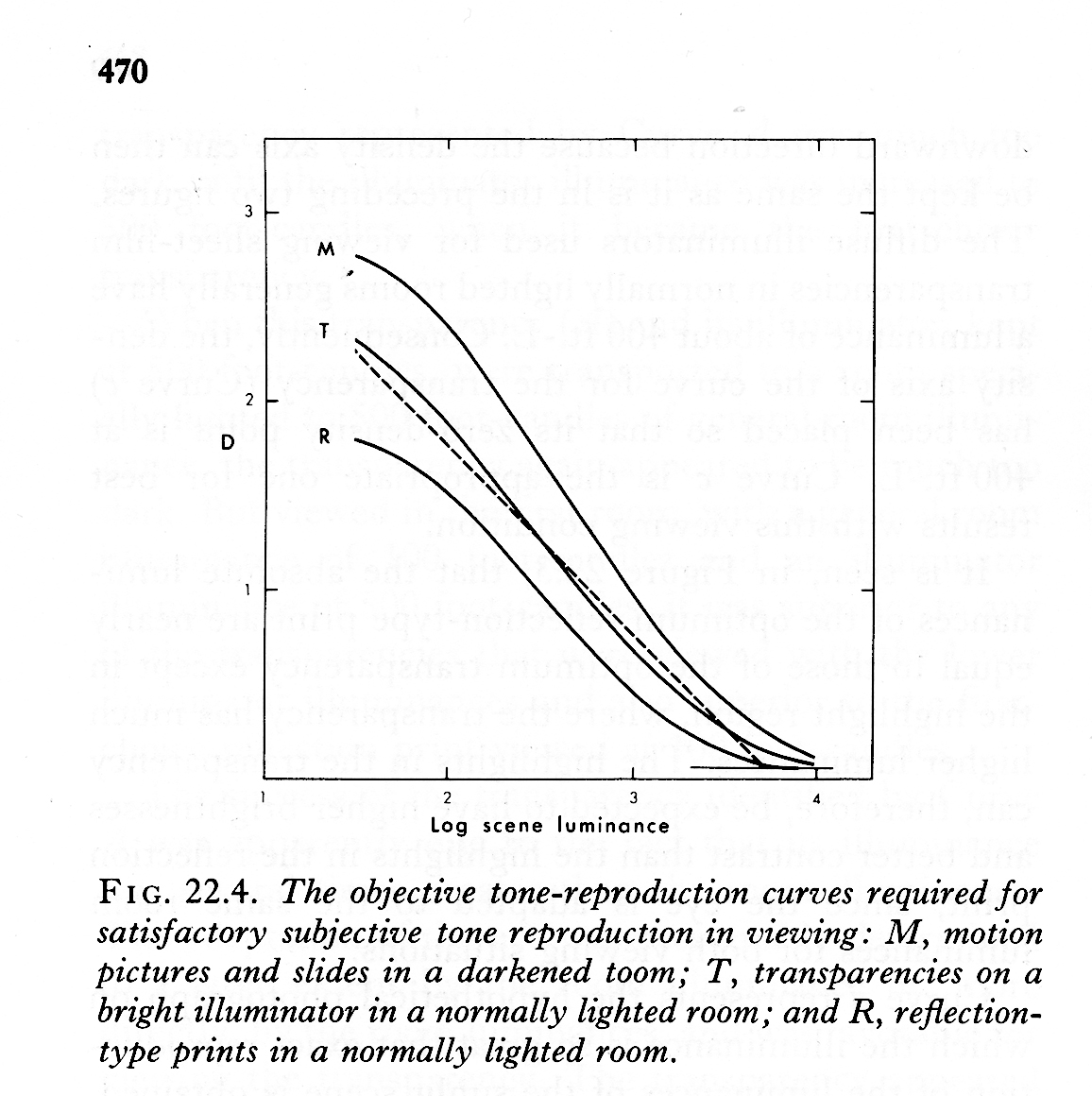

The pre-1960 ASA standard weighted shadow detail more heavily than highlight detail.
The post-1960 ISO standard is strongly based on print evaluation data, which reflects a preference for highlight detail. The prints used in the supporting research were un-manipulated - think of the output from commercial photo labs.
Those of us who print in the darkroom tend to prefer extra detail in the shadows, because of the availability of print manipulation tools and other factors.
The change in the standard reflects changes in materials, and careful evaluation of viewers' preferences.
You may very well prefer the results obtained when you lower your EI, and therefore give your film more exposure.
But I would suggest that you pay close attention to how the highlights display when you print the negative appropriately, before you decide.
MattKing, I think you might be a little mistaken on your thoughts here... I think the print study results were used before 1960, and I got the impression there was a definite preference for a certain minimum amount of shadow detail. I agree with your other points.
But the thing I find interesting - and which influences what I do - is that although the prints were "unmanipulated", I think they were carefully matched in the darkroom to paper contrast and print exposure. I think the studies might have found thin negatives printed on grade 4 were best. I don't know if that information was provided it's just a gut feeling when I read that they made "the best possible prints".
So if one wants more shadow detail ala the pre 1960 style then shoot at half the box speed since around 1960 most film speeds doubled. Hence no testing is needed if this is what you want.
Bill:
Your points don't match my understanding, but they may very well be correct.
I really doubt, however, that the standards are based on grade 4 paper. In the 1960s, most (35mm) films were relatively grainy, but 35mm was certainly becoming more main stream.
A thin 35mm negative printed on grade 4 was unlikely to yield "the best possible prints".
From The Evaluation of Negative Film Speeds in Terms of Print Quality, "Having obtained a series of test negatives for each of the four negative materials, prints were made therefrom. Those responsible for making these prints were instructed to make the best possible print from each negative by using any one of the six contrast grades of developing out papers. In order to do this, it was of course necessary to make a series of prints, in which the printing exposure was varied on each of two or three of the contrast grades...From each group of such prints, one was chosen as being the best that could be made from that negative with any variation of printing paper contrast and printing exposure. In this way a series of twelve prints was obtained for each of the four negative materials."

FYI, there are different requirements for positive material projected in a darkened room than for prints to be viewed in a lite room as well as different requirements for color and black and white. Not that the note in the link about underrating film isn't applicable to black and white, it included a distinction, "Although similar, EI is not the same as the ASA or ISO speed used for still films." Let's not forget the motion picture release print is multiple generations removed from the original camera negative and there's quality loss with each generation.
Finally, you are confusing film speed with personal preference again. Don't know if you noticed, but I'm not suggesting people should exposure at the ISO rating. It's the part of your argument that the film speed method is somehow wrong because you like to the results from underrating the film is what I find credulous.
