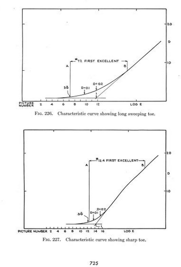

I wanted to show from page 725 of Mees, an illustration used to explain why the minimum useful gradient does not always correlate to fixed density criteria...
Long sweeping toes useful film speeds don't correlate well to the usual fixed density criteria.
