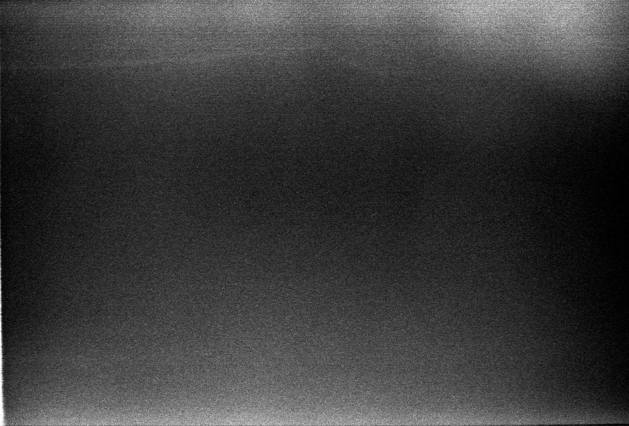

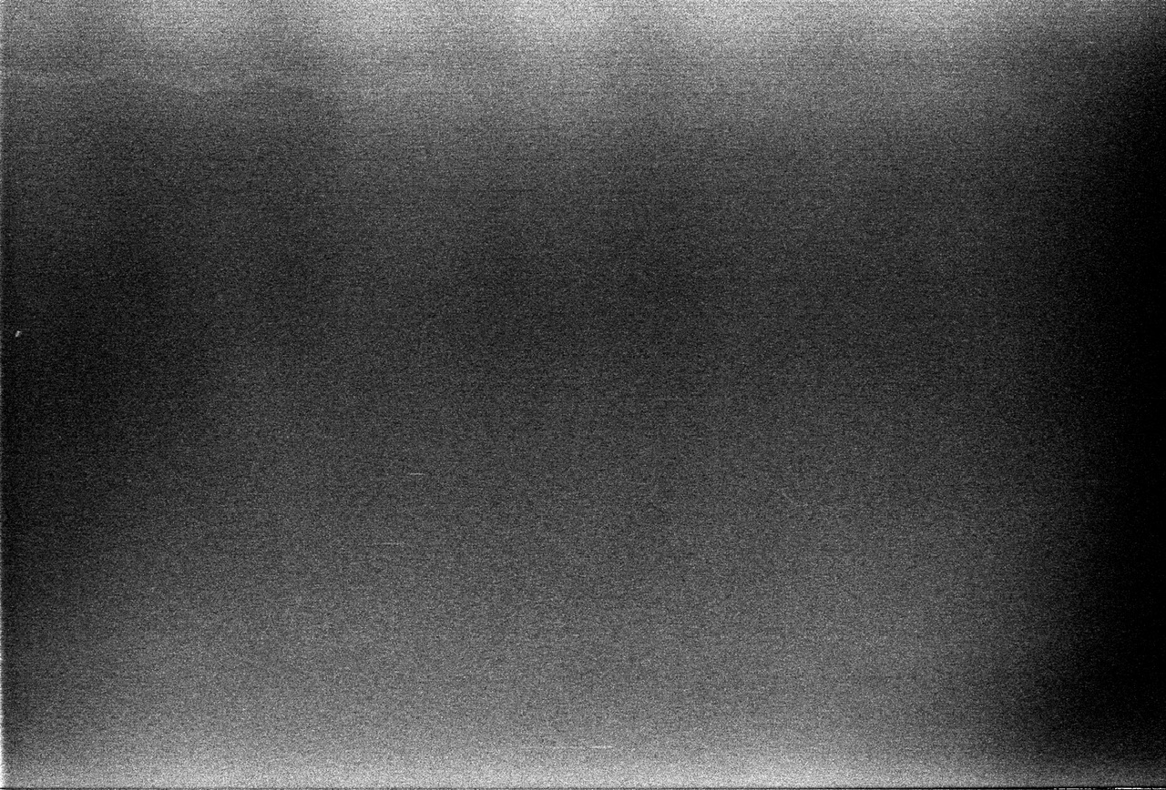

I mentioned uneven development.
First two frames of one of the rolls in that tank are I think shots taken pointing at the sky. When scanned, the scanner tried hard to create a gray balanced picture. You can see with contrast exaggerating the tones, the dMax varies. It would not be very evident in most prints except the top and bottom higher density tendency is visible in some pictures if you look for it.
p.s. Looks like a tiny bit of capping. I have been struggling with this ES-II and this is a tell-tale sign I need to go deeper into CLA territory than I wanted to go.
Bill, looks like you have a little uneven developing happening around the sprocket holes holes, too.
Two words: Unsufficient Agitation. I couldn’t get rid with a less pronounced gradient in 120 and had too switch from Jobo 1500 to Jobo 2500 where the spirals have a greater distance to each other. That fixed it for me.
