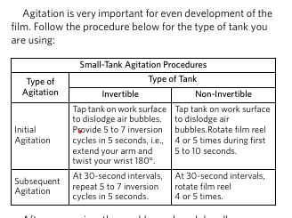

And as for providing instructions, this is what Kodak says:

Interesting...5-7 inversions in 5 seconds is a lot more vigorous that what I generally do. I guess that not a problem if Kodak says so, but I generally do 5 inversions in 10 seconds (one second invert and twist, one second return to upright and twist--5 times. It helps if I have some music on that is 60 or 120 BPM. The scherzo to Beethoven's 9th synphony works well since each measure is 1/2 second, so two measures upside down and two measures right side up.)
