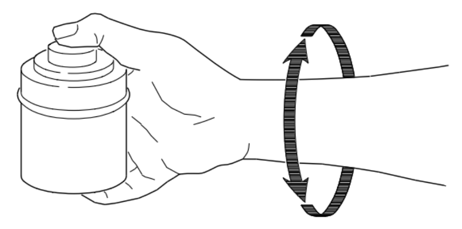

To highlight that point, here's the diagram from Kodak instructions --- I forget which product this is from; probably a Kodak-branded chemical made by PSI.

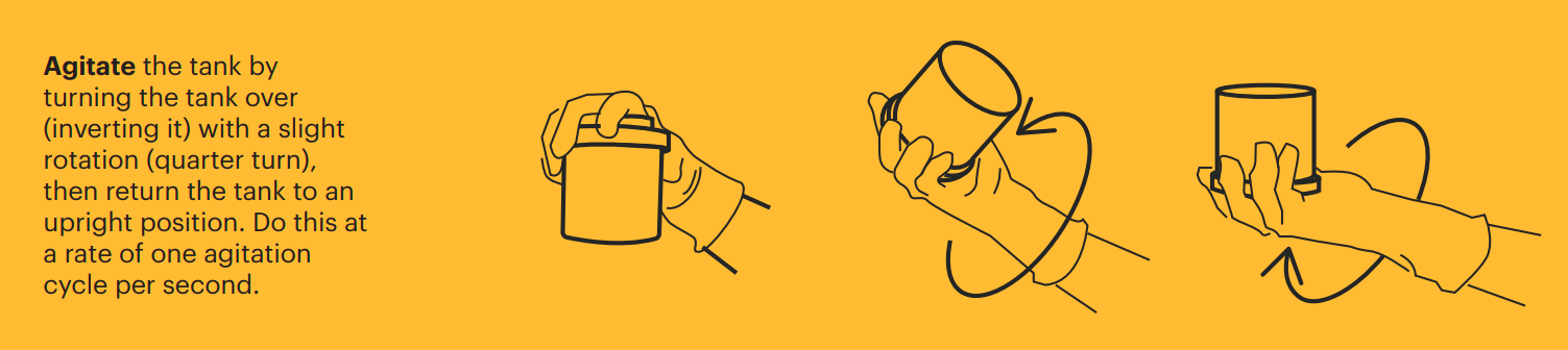

Here's a similar diagram from the C-41 kit:
Clearly, a simple inversion is perfectly sufficient. The fact that some of us are discussing more complex rotations doesn't mean that complexity is necessary.
Note that the illustrated tank is a small one, easily grasped in one hand.
I usually use a 1 litre Paterson tank, which is a bit harder to agitate with a single hand. Sometimes I'll use an even larger tank.
The two hand method works for a range of sizes, and allows you to be consistent in the amount of chaos you add to the process - and yes I notice the irony of that observation.

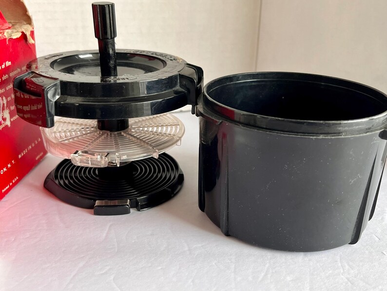

I still have my Dad's old Elkay Bakelite tank. That's what I started with. Then came the "English Invasion" once the patents expired and Paterson started selling tanks into the US market. I thought I had died and went to heaven 😁

That's how we agitated with the old Kodakcraft and Ansco, maybe Yankee tanks as well. Most of the 50s and 60s consumer plastic, backbite, tanks did not have caps, or cap leaked so badly that the the figure 8 motion, or the Anso tanks that came with a cheap thermometer that could be to turn the reel inside the tank. Here is an image of one with a regular turning insert. I think the thermometer was extra?
I remember those. I think Ansco had a patent on the "toothed" reel that allowed one to ratchet on the film similar to Paterson.
