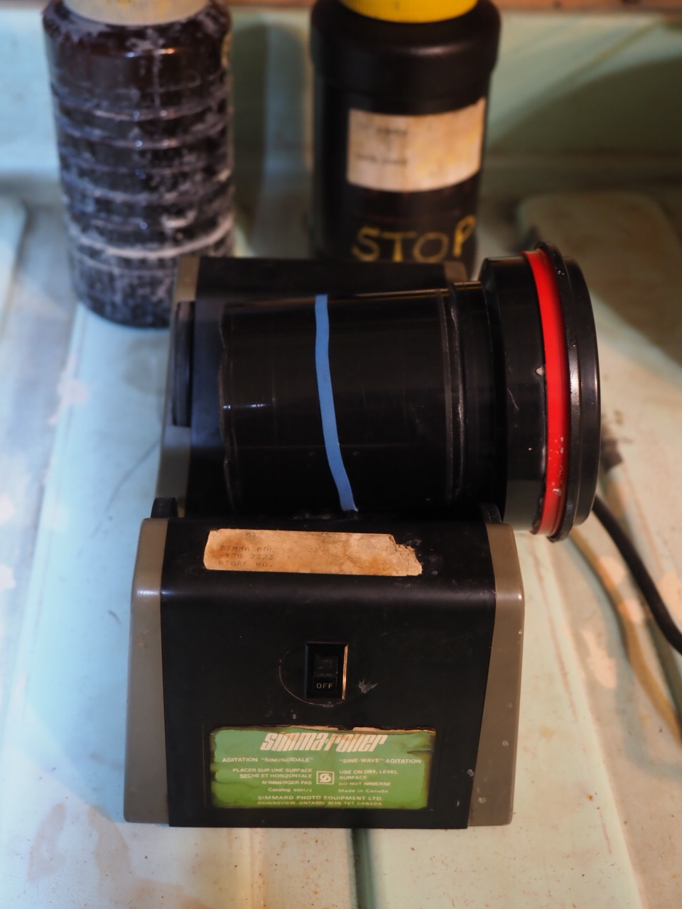

I spared no expense on my film roller.
As I often use dilute developer , this is most convenient.
Not questioning your setup, looks nice.
Jobo tanks hold the Jobo plastic reels locked in place to insure the reels rotate along with the Tank. No variation .
You definitely want to have a device that reverses tank rotation as well. Like the Unicolor to name one.
