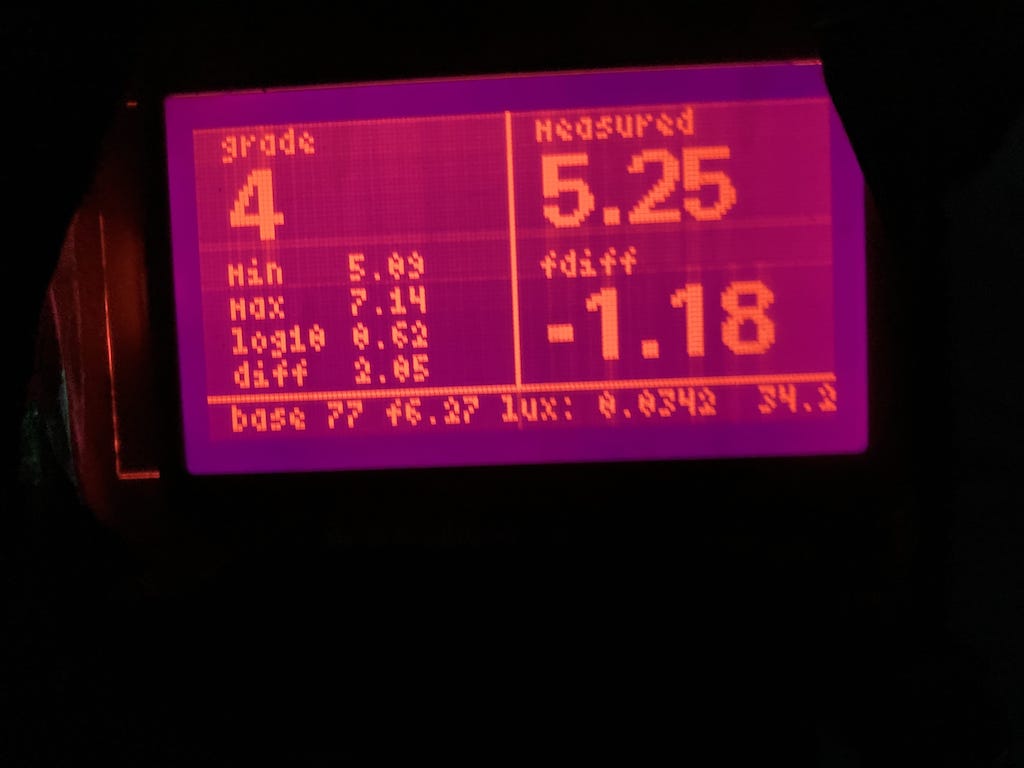

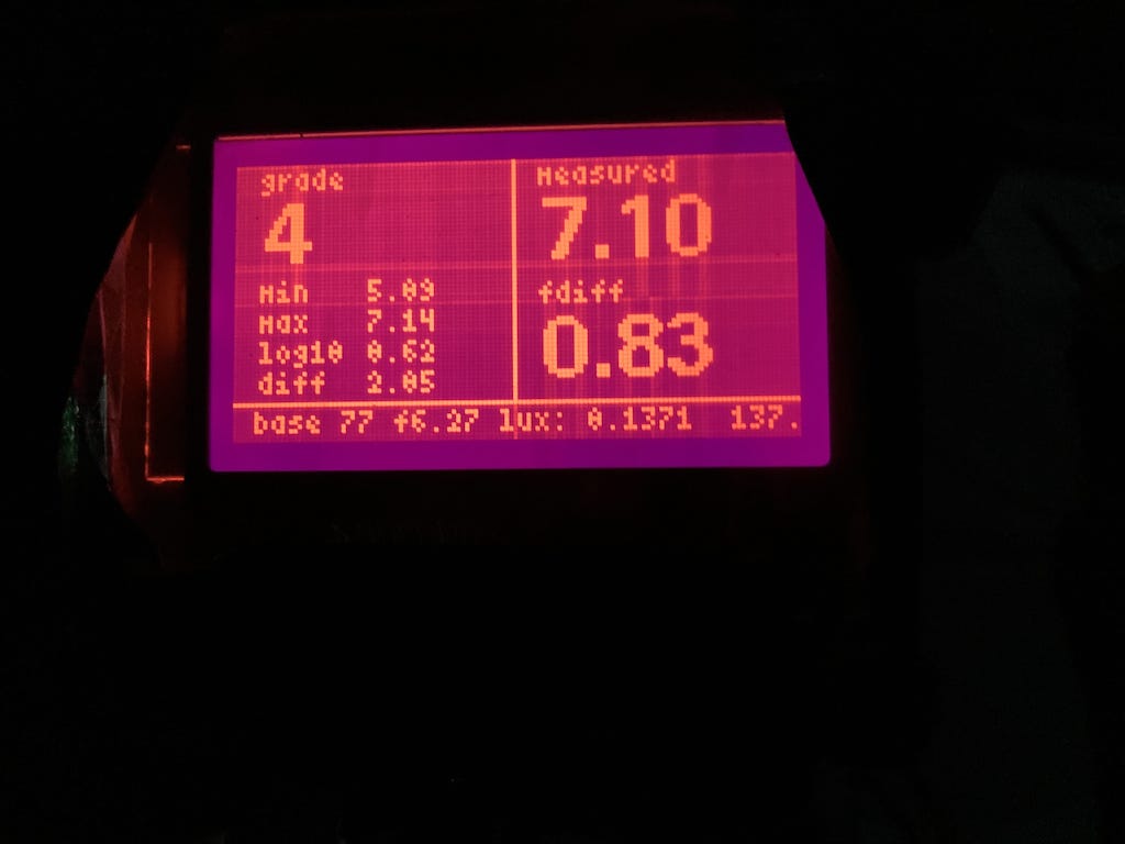

I made some measurements after long pause and I've been thinking of developing my UI a bit. However here are shots from my measurement (highlight & shadow):
You can see that in that frame the shadows are at lux 0.0342 and highlights at 0.1371 lux. Just for reference if anyone is doing similar device.
That measured frame has 2.05 stops range and density 0.62 (if I've calculated right..).
Maybe I have to explain a bit.
The "measured" value is in f-stops so luxes converted to f-stop (log2). To get some positive f-stop numbers I multiply lux by 1000.
"fdiff" shows this currently measured value against EEPROM stored value. Of coure it is meaningful to set this to the value that gives first details in highlights, aka "almost" white.
What is still a bit stupid is that I need to know the exposure time which I used. So I need to manually calculate that. Lets say I exposed for 4 stops to get correct exposure when making the "calibration". Now I change the negative and for example end up with "fdiff" of value 1, I know that the highlights on this second negative pass more light to the paper. I now know I need to decrease the exposure by 1 stop and expose for 3 stops.
This is how it works in theory.. Feel free to question this :smile:
