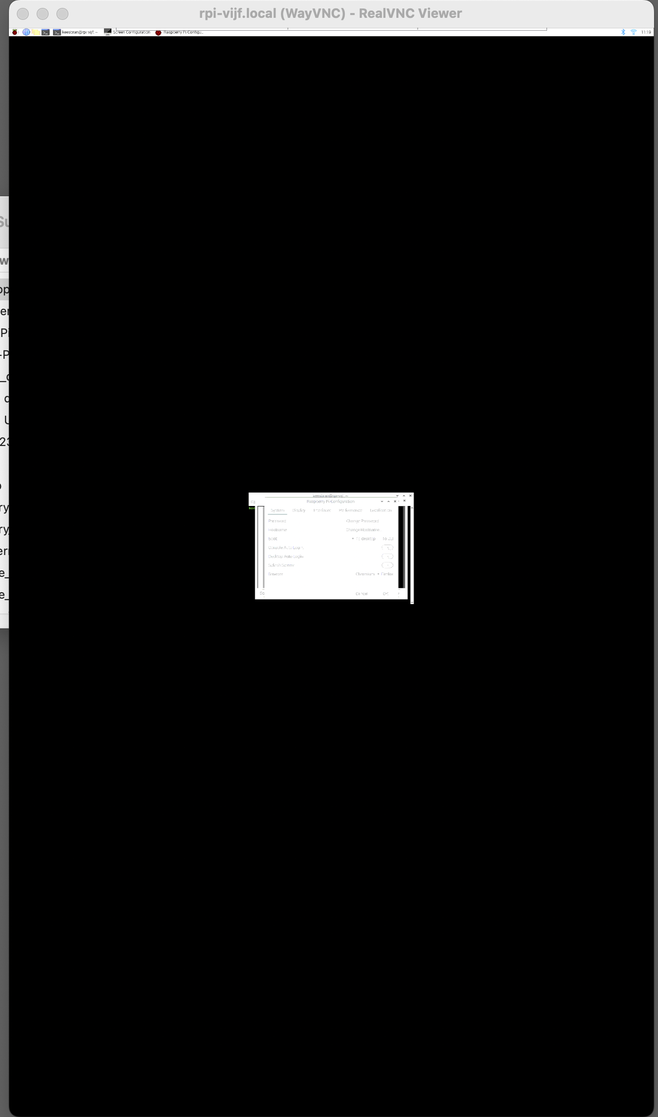

Nice! I am experimenting with rpi5 now and with the standard config.txt and after adding video=HDMI-A-1:2560x4320@23 in cmdline.txt the screen resolution is recognised! This did not work on the rpi4 though.
HDMI-A-1 "Chimei Innolux Corporation 0x6301 (HDMI-A-1)"
Physical size: 330x180 mm
Enabled: yes
Modes:
640x480 px, 59.939999 Hz
640x480 px, 60.000000 Hz
720x480 px, 59.939999 Hz
720x480 px, 60.000000 Hz
2560x4320 px, 23.010000 Hz (current)
Position: 0,0
Transform: normal
Scale: 1.000000
So the 2560x4320 is now recognised as current screen size.
With VNC Viewer I actually can see it. The screen itself is still dark. Now I will add the config elements from the sumaopai config.txt for the hdmi timing. Looking more carefully to this config.txt one sees some copy paste mistakes. Like a double entry for dtparam=i2c_arm=on and two entries for gpu memory: gpu_mem=128 and gpu_mem=192. Both won't harm much I guess.

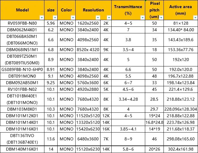

Hi All :smile:
I'm looking to buy one of these LCD screens - I've looked at the SUMAOPAI screens and those from Shenzhen Aptus - They're mostly the same specs between them.
As discussed - the screens with resolution below 12K are 8bit, and the really big ones are 3bit - I understand that we can modulate the signal so that we can get all the gray levels we need.
My question is - what do you those of you working on similar experiments think about the trade off between the added complexity of modulating the 3bit signal and getting the higher resolution, vs the comparative simplicity of the 'lower' resolution and the 8bit signal.
I'm planning on going really big with zerochromes (maybe 1.5m +) - considering registration is not going to be perfect across all layers - is the extra resolution worth the rigmarole?
This thread is awesome - thanks all for participating.
B
ps. I attach the product listing for Shenzhen Aptus which has a bunch of interesting specs for various panels.
