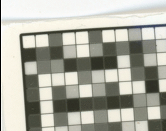

When you say light falloff - do you mean the enlarger is not illuminating the full ‘negative’ evenly?

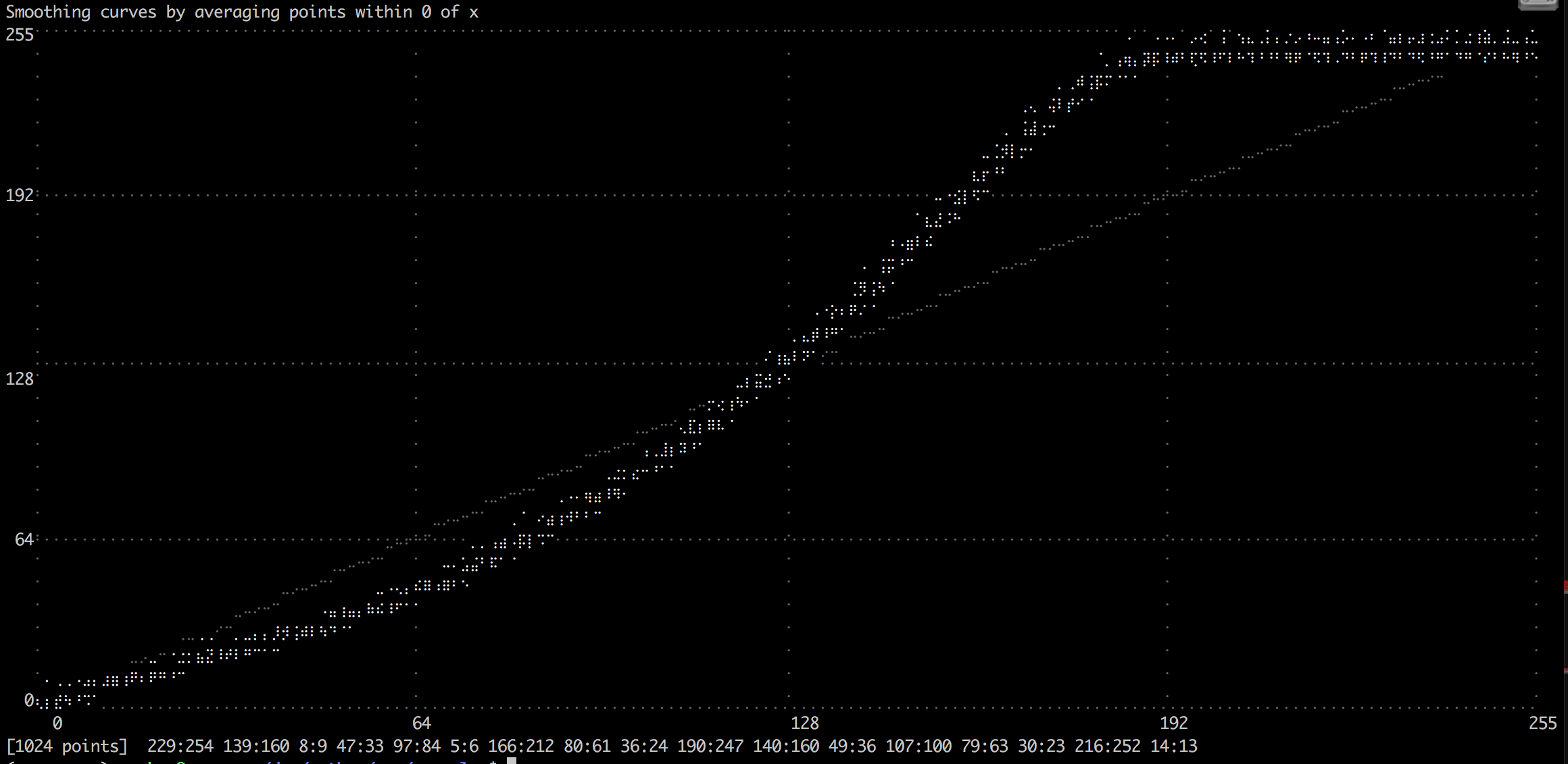

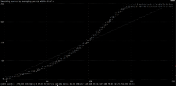

Yeah. Maybe it's my enlarger lens, or I have the the negative tray the wrong height from the bulb or the enlarger bulb is not evenly illuminated, or the lcd itself is uneven or many of the above. Look how fuzzy the attached response curve is. It's quite easy to make a good linearization curve from that. Each the neighbors of a grey level in the ramp are chosen to be quite far away on the chart. If I had used a linear ramp, the response would wiggle up and down at a much lower frequency, making it harder to find a good linearization.
I need to make a light falloff correction map too, which will help, but it is not that bad and I'll do other things first. Today's task is making my chart tool apply a correction curve to a test image and add a step wedge with blocks with image black and white, and absolute black and white.

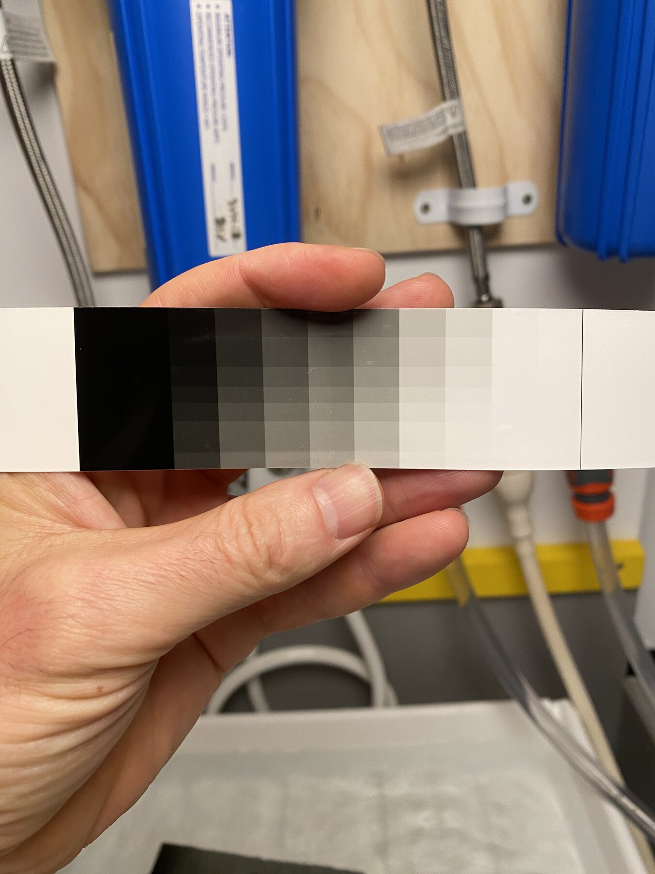

Now that I've got the distraction of publishing my curve tools out the way, I can get back to actually using them. I had been inverting my charts before I printed them, and if you do that you can't really divide out a gamma response ( you can, but you have to model the inversion too) I made a chart without inverting it and the part that remains is very straight for multigrade paper except for a gentle toe and shoulder. (I have inverted and non-inverted chart scans included in my tools release as examples) Next goal is to eliminate Photoshop from the workflow, and after that expose images with my own code.
