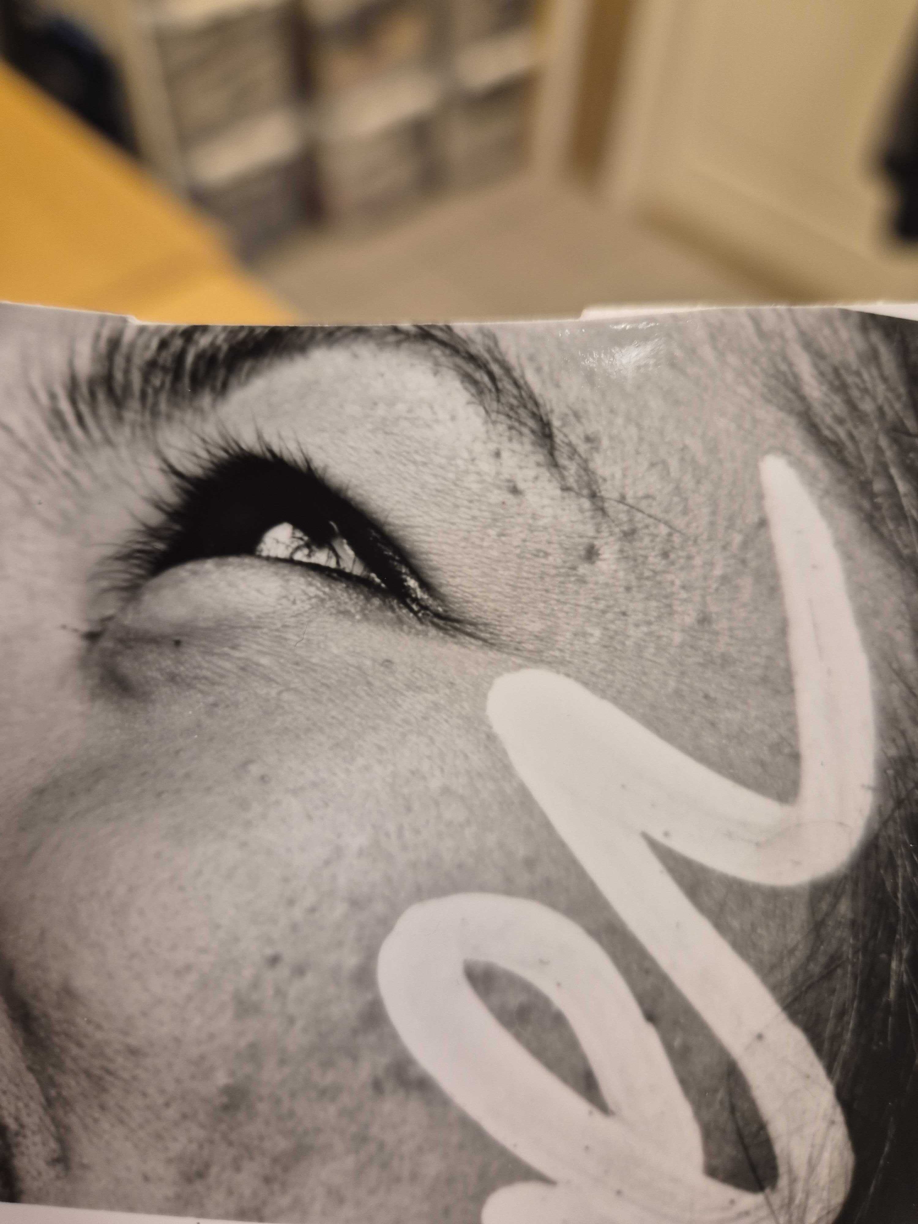

Managed to get something on paper using a Durst 1200 - looks promising!

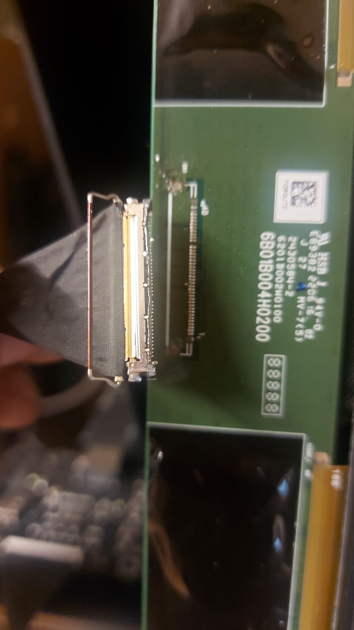

I’ve spent the summer putting my machine together and, after finally getting through the software side, disaster struck on the very first full assembly test and the eDP connector on my 8K 10.1" screen broke.
Fortunately, all the solder pads on the board survived, so I’ve ordered a new connector. For anyone who might need the info, it’s a 20455-040 type. I’ll try to solder it back and see if the screen can be revived, but I’m also planning to order a spare soon, maybe even jump up to the 16K model this time.

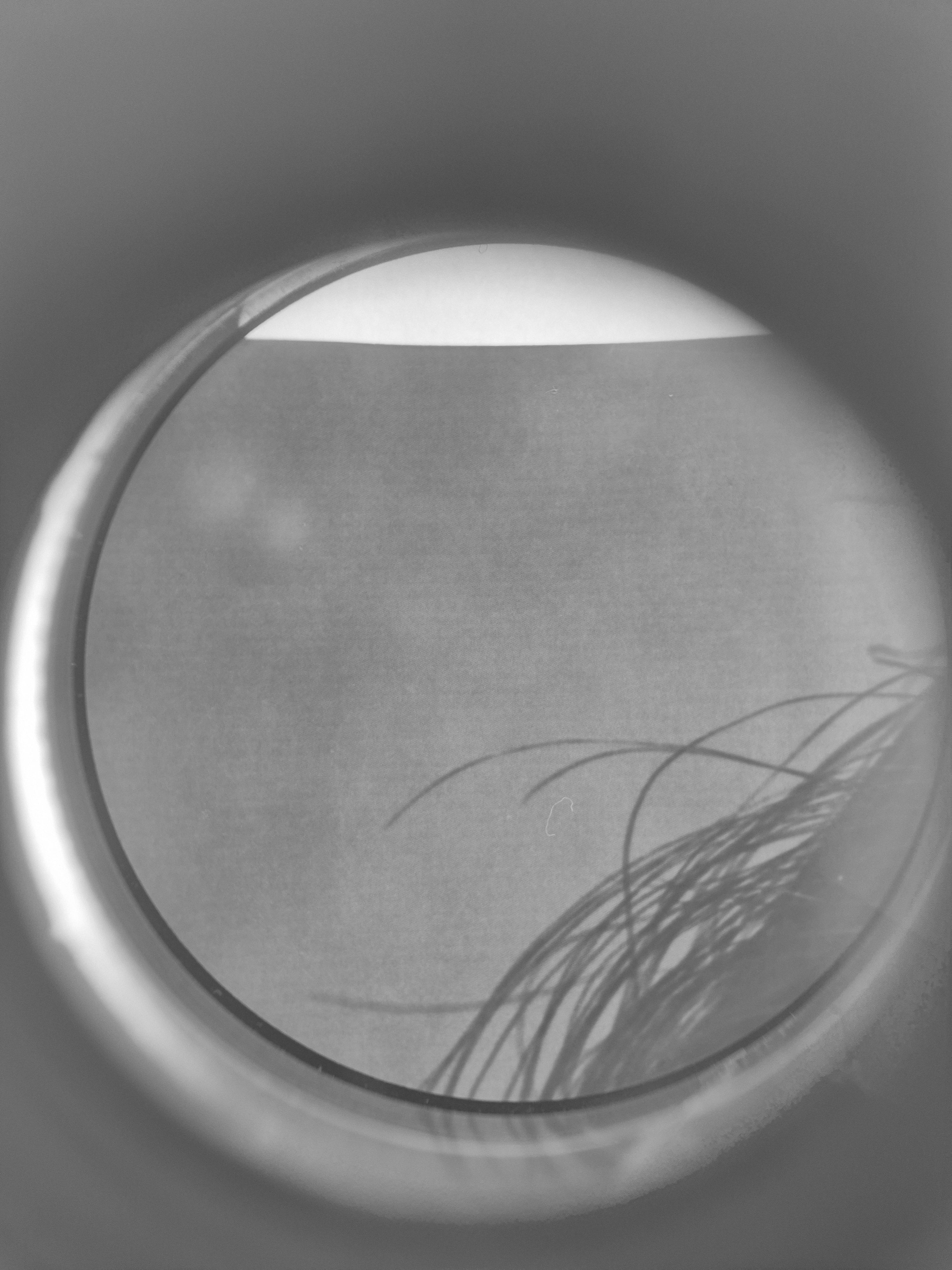

Last night I did another test printing session, using the display’s grayscale mode (as opposed to running it in 1-bit mode) with straight exposures (no modulation). In areas with less tonal variation, I noticed faint brighter lines running vertically when the display is in landscape orientation.
The protective film is still on, but I doubt that’s the cause. I’m wondering if these lines are inherent to the display itself, or if they’re related to how grayscale mode works. They seem to repeat roughly every 20 pixels or so.
Went back this morning to test - this time using pure 1-bit mode, and time modulation - do not observe the lines then. Must be something about how the display is refreshed when running in 8-bit, that causes this.

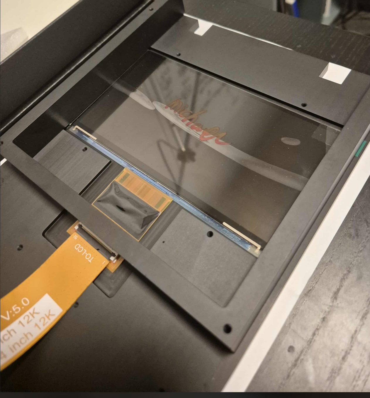

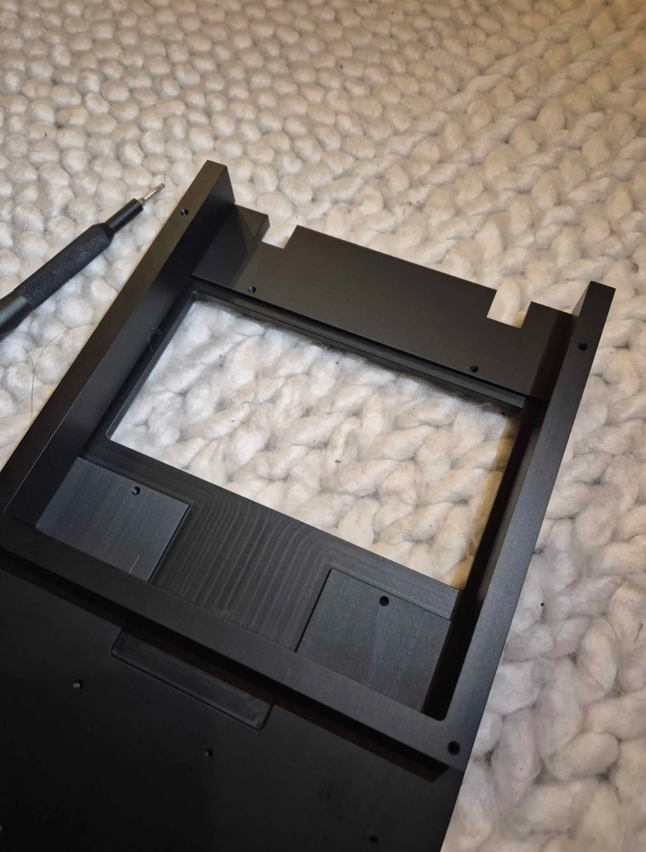

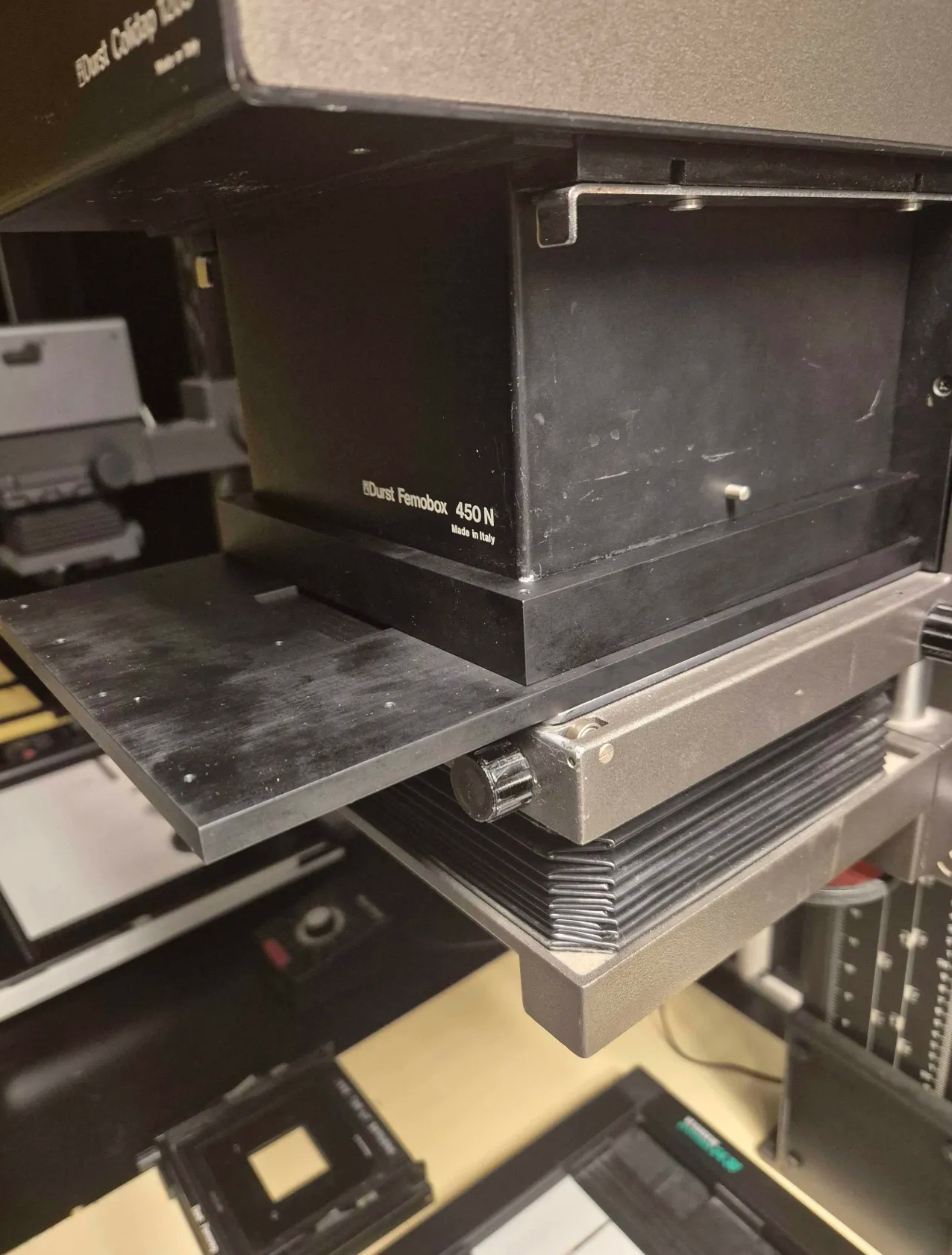

I took a hiatus from my darkroom experiments and went down a rabbit hole designing - and having CNC machined - a carrier plate to mount the LCD in anodized black aluminum. It just arrived today, and I’m excited to get back to experimenting. Looks pretty neat!
