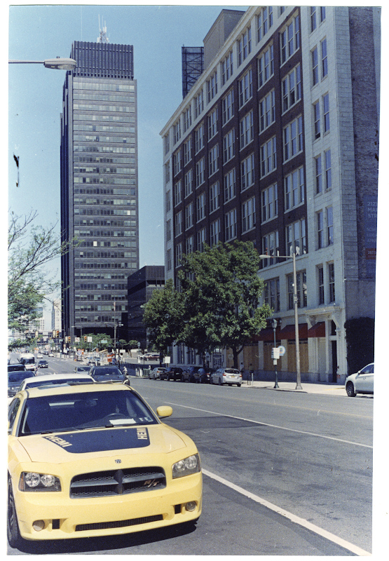

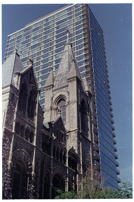

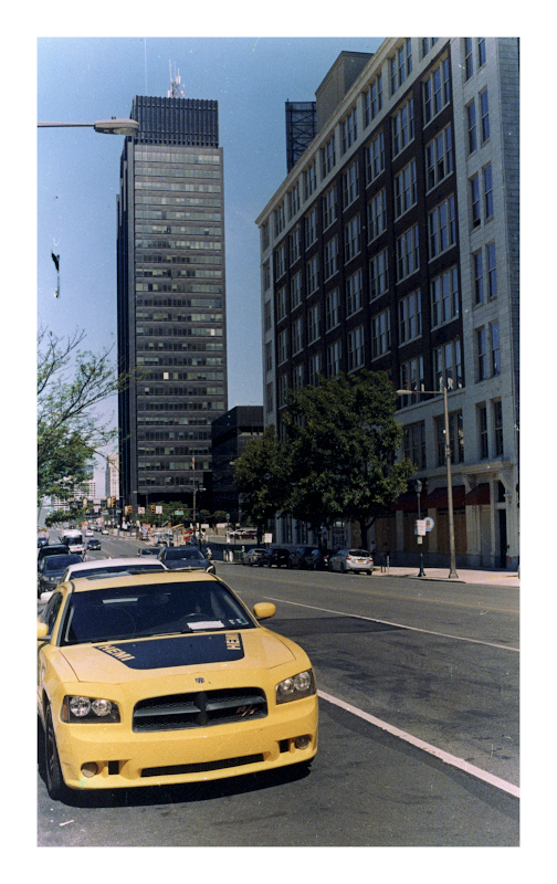

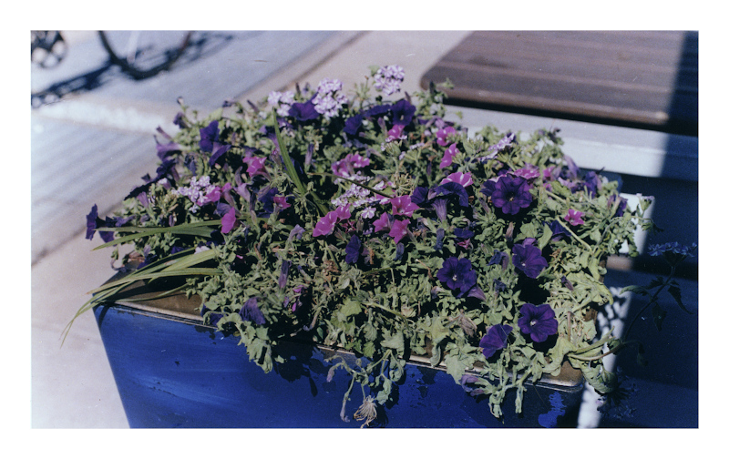

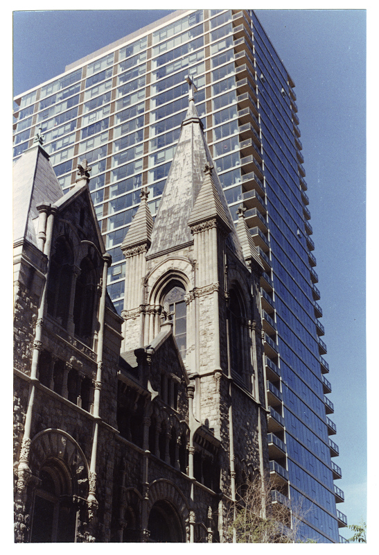

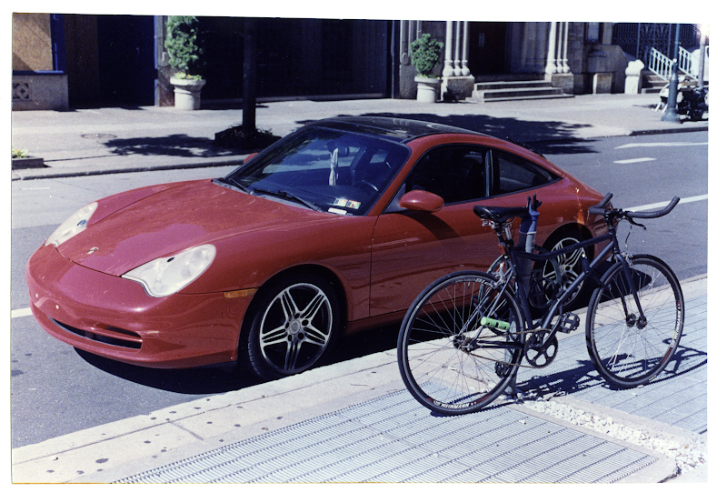

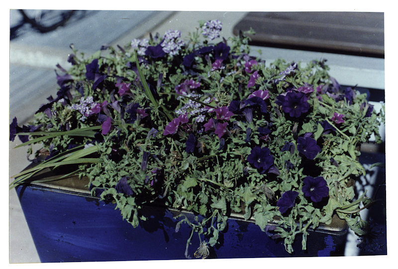

To follow up on this; as mentioned, David has sent me his prints and negatives for me to mess around with - or, rather, to have a stab at digitizing them as well as I can. This is always a challenge, so the results shown here are not 100% accurate with the physical prints, but they're fairly close.
These are the scanned prints I received:
If you're wondering: yes, they are quite cyan/blue (except the 3rd). The actual prints are rather cool in tone, fairly low in overall density and contrast.

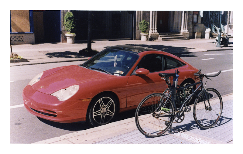

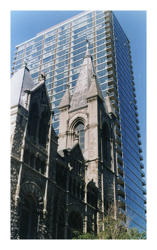

To get a feel for these negatives, I tried printing them as well:
As you can tell, I made some different decisions in filtration than David did. I think we optimized for different parts of the prints, and perhaps evaluated strips under different kinds of lighting. And then there's personal preference to account for, and I know I tend to print a bit warm usually.

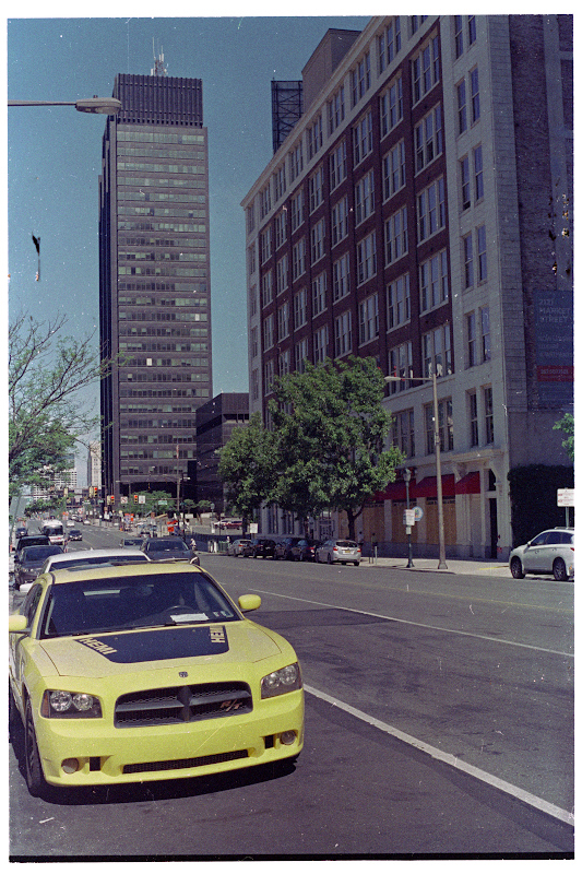

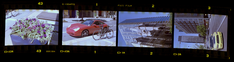

Actually printing these also gave me some insight into the characteristics of the negatives:
* Contrast seemed fairly normal compared to regular C41.
* Grain seems a bit pronounced, but it may be the film itself (It's a Fuji 100 stock, not sure which, how old, etc.)
* Overall, the negatives have a significant yellow cast, requiring much lower than usual yellow filtration. Most of this filters out OK in the end.
* There does seem to be a quite significant crossover problem, affecting hue purity and color balance. Basically, I didn't manage to get an entirely neutral looking print from these negatives. I had to compromise for certain parts and allow other parts of the same image to shift to something I didn't intend. In particular, there seems to be going on something on the green/magenta axis that is not really linear.
The above matches quite well in all respects with the results I got from my own experiment with diluted C41 developer. I'd say that David's negatives were a little less shifted on the yellow axis and contrast was a little higher, suggesting that the Kodak developer does marginally better than the Fuji at this dilution. But both seem to run into crossover issues when used this way.
Finally, I did a very quick & dirty scan of the negatives themselves, but I didn't spend much time on color correcting them. They were smacked on the scanner glass just like that, so there are some sprocket hole reflections in the images that aren't really there in the negatives; ignore them. I did a quick attempt at some color balancing, but decided quite soon that I wouldn't be able to figure it out quite to my liking; normal C41 film tends to scan rather straightforwardly, but these negatives require more advanced filtering to correct the issues.
Edit: forgot to include the film strip; here it is:

And, I have this to say: If my method is deemed to be in error, I will accept that. To me, to MY eyes, under tungsten lighting, the prints I had sent seemed fine. But my eyes, my determinations, are not all that count in this world. I fully accept koraks' output even though I think that my physical prints were better. Sometimes, there is a difference between the segue from analog to digital but, here, I am not making excuses. Indeed, if you look at the prints I had 'scanned' with my cheap digital camera, maybe some will see that the colors are better.
Again, I fully accept this output by koraks and thank him profusely for his efforts. Maybe we have all learned something from this exercise. - David Lyga

David, I haven't examined your prints under tungsten light (in fact, we don't have any anymore around the house...), but I do think that they will likely look much better under that light.
It was quite valuable to actually have a go printing these negatives myself. It says so much more than going by what people post on Flickr etc.! I really think people should do this more, exchanging prints and negatives for real life comparisons.

Thanks koraks for taking the time and trouble to do this. The prints look a lot less blue that the scans but there does seem to be a kind of a de-saturated look to them. It all depends on how closely you examine them. Looking at the prints by themselves a lot of people would browse through and not say that there was anything wrong with them. They do the job as prints. Against the prints from the same negatives but developed "normally" then I think most people would feel that there was something lacking in these prints but it would be along the lines of saying that prints from David's negs were OK but just not as good as prints from normally developed negs

Oh, there's a big difference between your digital photo and my scans of the same prints, for sure! I think the lighting conditions for the digital photo explain that difference. It's important to note that I corrected the scans against the real prints as viewed under overcast daylight conditions, so quite cool color temperature. My prints were also made for viewing under daylight/open shade.

I had a look at your pics of your prints, David. I can't see any crossover in either set of prints and the blue cast in the scans is just that, a blue cast in the scans. Not some cast that is there in the negs. I prefer some of your prints to koraks in terms of overall look except that his prints seem to have more depth in the colours. In the case of the flower tub perhaps too much depth. I think I prefer your print to his in that one. It may be that there is yet another exposure and filtration setting possible for the prints that would be better for my taste and that is what it may be i.e.taste as opposed to any process issue that is part of your process. I do not see a fundamental flaw being present here. What I have noticed when I was doing RA4 enlarger exposed prints is that a slight change of exposure and filtration can make a large difference to the look. As an example I made a print of the centre of Malahide, a town in the Republic of Ireland and it looked fine to me. Then out of curiosity I changed the filtration setting by as little as a couple of units on the dichroic head. Then I made 3 more prints of the same neg in the form of a ring around and with all four front of me I could see that a change of 2 units on a head that runs from 0-130 so not very much change created by 2 units, took out a very, very slight magenta cast that was visible because the central square in Malahide was grey block paving. It just not visible without the comparison present
So I am less sure now of what I said in my earlier post about whether the normal C41 process would have made any difference. It may well be down to exposure and filtration under the enlarger.

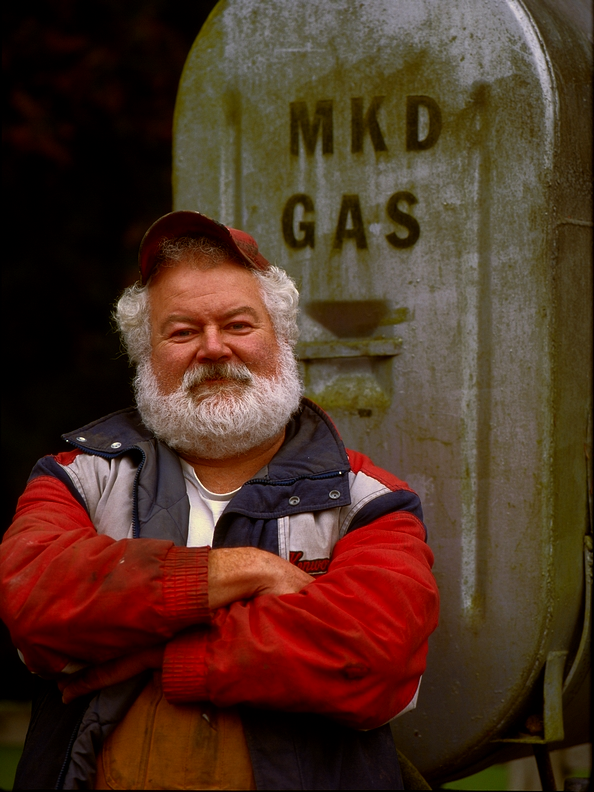

I have one question - are there any negatives in that batch that include pictures of people?
I ask because in my experience, photos of people are the ones where crossover can be the most disturbing.

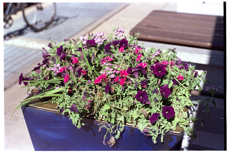

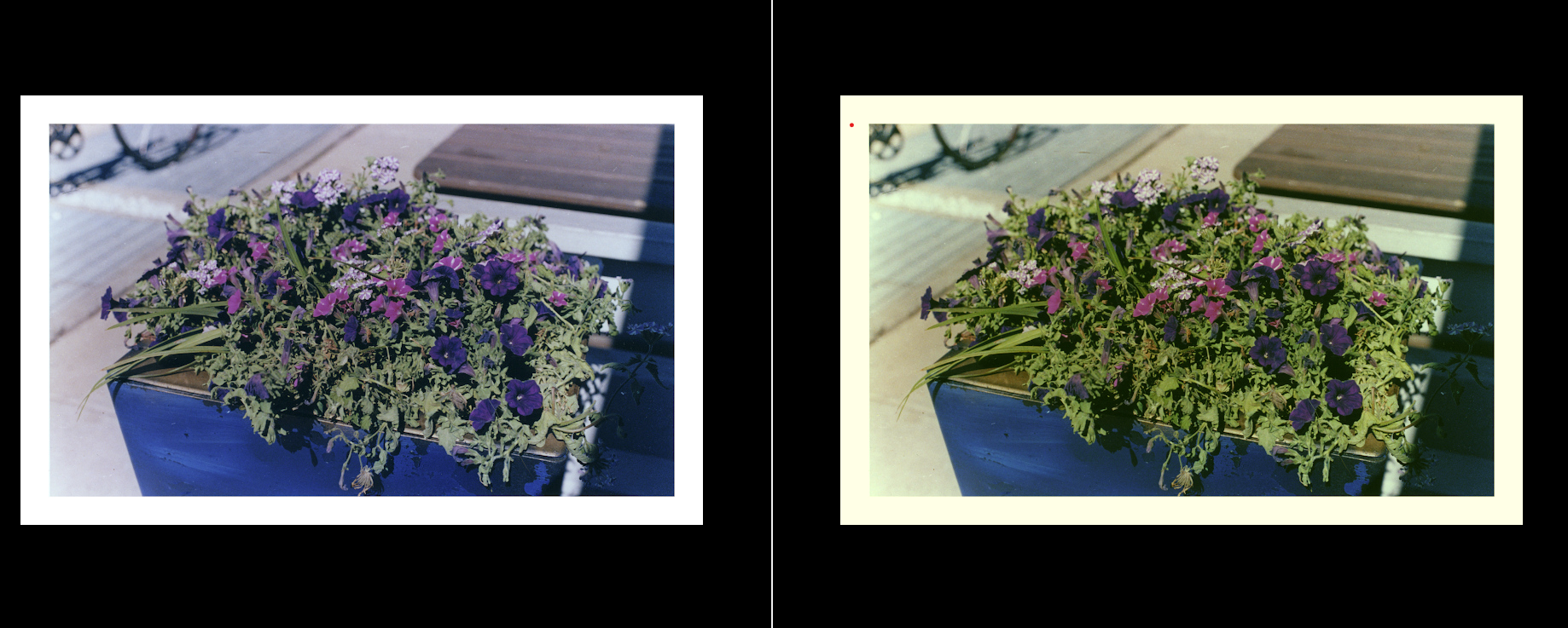

I played a bit with the picture of the flowering plants. Giving it a bit of an adjustment in the colours and gamma improves the foilage, but replaces the blue cast with a green/cyan one.

I always had thought that gray areas, like sidewalks, were the most revealing as to color crossover. We have all learned something today
It is very helpful to include grey in a photo that you are using to analyze colour with.
But it is even more useful to include grey with a bunch of other references.
This one gives me a lot of material to reference - things like flesh tones that move from highlight to shadow. Let's see if the uploader will mangle it:
Not too bad as a usable example.

Image 1 looks better to me in my print than it does on screen in the adjusted film-scanned version. The digital version could easily be modified further.
Image 2 just works better in the film scan. There's no way I see (without color masks) to make the red come out like this in a real print without the rest of the scene turning into pink or orange.
Image 3 is like #1; I find it looks better in the actual print than it does in the film-scanned version. Just like #1, the digital file could fairly easily be further optimized.
Image 4 is very saturated in the film scan, and much more muted in the actual print. I prefer the latter version.

Look at e.g. my print of the yellow car. The tarmac is green, while the yellow of the car bonnet leans towards magenta.

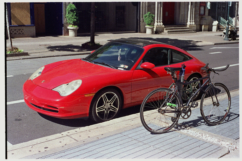

In my print from the Porsche, the right side of the tarmac (behind the car) is fairly neutral, on the left side it's also magenta/yellow.
Other than that, it's mostly the hues themselves that aren't quite right. The church building is impossible to filter for a neutral sandstone in the sunlit area while keeping the shadows cool without them tilting towards green.
It's often difficult to accurately put into words, but you really notice it when printing such negatives. You make a strip, decide that some part is a bit too magenta or green (e.g. the skies), so you adjust it and then a new problem pops up in a different area. This is also why some crossovers are in practice a little less obnoxious than others. If you have for example a blue/yellow crossover with dark areas going blue and highlights crossing over to yellow, it's sometimes not very noticeable if you print a sunlit scene, where the shadows will always be cooler than the sunlit areas. The fact that there's crossover in such a case is masked by our perception of the scene. However, if you then try to print e.g. a portrait from the same roll, problems do occur...

I note that in the far pavement side of the road in the red car scene the colour doesn't change in any of the prints or scans but David's prints look overexposed
in much the same way as in a scene of a car submitted by Bormental. In his case crossover was suggested as well due to what is alleged to be overexposure I say alleged as Bormental is yet to submit his exposures. As far as I am aware Bormental does not use David's processing method and while his picture does look overexposed it doesn't look so overexposed to create crossover. Unless Ektar 100 ( the film in question in Bormental's case) is different from most C41 film then I had thought that its latitude was +4 stops in the overexposure direction? The water, certainly in the case of Bormental's alleged overexposure, is muddied by, in his case, deliberate scanning manipulation to make the scan look like he wants it to rather than a reflection of the actual negative.
