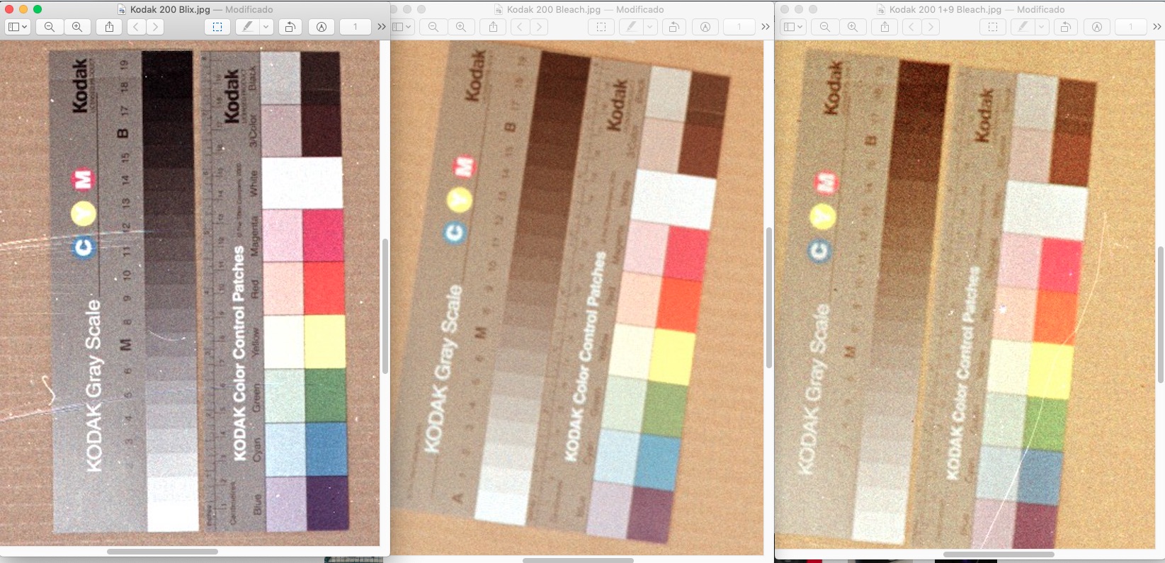

The problem nowadays is that so much of what we see as prints are in fact scans of neg which are then reversed and that brings in scanner setting etc
The images in my first post are indeed negative scans, converted to positive en photoshop so all scans are exactly the same, If I use all the "restore colors" and "film profile" in vuescan this is what I get.
The colors in the diluted form doesn't bother me, but the grain is coarser (but could be the scanner, it does not have much resolution)
Yes, the grain in the right scan looks quite a bit coarser, but is there a chance, that sharpness is also slightly higher? Both effects would be the expected results of developer dilution.

very insoluble silver salts, which are very difficult to fix
Before doing this I fixed a piece undeveloped color film in some ilford rapid fixer 1+4 and in cleared in one minute, is this test enough? Or could the film be clear and still have silver salts?

there is an evil contamination that takes place, turning the film green, if there is so much as a molecule of developer in the film when it hits the potassium ferricyanide.
In some post that I can't find PE said something about the C41 developer reacting with the ferricyanide, maybe that is the green color as a result, to avoid that reaction I used the steps suggested here (by PE himself :blink:)
Regarding equipment: I do have many things needed for and hybrid workflow but everything is ancient, for 35 mm negatives I use a Nikon LS-1000 and for 120 an Agfa Duoscan, all that connected to a PowerMac G5, so top notch tech... 20 years ago!!
Back to the topic of C41 developer I did the test because I was curious and could not find some side by side comparison and for an economical reason, I live in Santiago (that is in Chile) here you simple can not find C41 developer locally (I'm sure that the few lab that remain have some kind of secret society because I could not find an importer of Kodak or fuji chemicals).
Not just here in photrio but in many US base forums some members say "just go and by some more developer or whatever" that is completely understable but for me and probably others that is not so easy, for example: the 1qt Arista C-41 liquid kit that I bought from freestyle was $25 + shipping, as is ORM-D it must by ground to Miami, where a forwarding service send it to Chile, then there are taxes, import fees and whatever but in the end that kit cost me $75 USD, and the 4 liters RA-4 that freestyle sells for $50 to my house was $145 USD. (of course the powder C41 version is cheaper, but it is nowhere to be found)
In conclusion I'm very interested in every way I could make the most of that developer.
Now that I know that the ferricyanide bleach works maybe the next time I'll buy some 5L flexicolor developer and starter.

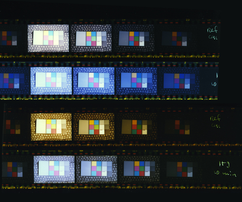

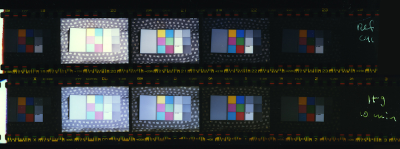

I did a quick test earlier today with some very old Superia 200 in Fuji minilab C41 diluted 1+9 developed for 10 minutes at 37.8C and then contact printed onto RA4 paper. I also did a test strip in regular C41 to compare. The results are fairly consistent with the ones you showed, with a few additional observations:
* Contrast is a fairly close match, but a tad on the low side. 10 minutes development at 1+9 dilution is certainly not too long in any case. I'd recommend 11-12 minutes if normal contrast is desired.
* Fog is higher with the 1+9 dilution. Not a big deal; it can be simply 'printed through'.
* Color balance for the 1+9 dilution shifts dramatically towards blue (in the positive/print). I could mostly correct for this through filtration, although I needed to go lower with yellow in my filter pack than I have ever had to do with any kind of film, no matter how experimental or messed up.
* There was some crossover, and while it was moderate, it didn't look very pretty to me. Highlights remain cold/blue with a hint of magenta while shadows go warm and tend towards green. In RA4 printing this can of course not be fixed.
I also noticed the developer oxidizes like crazy. When I mixed it, it was virtually colorless with the slightest hint of yellow. When it had warmed up to processing temperature, an hour or so later, it was a straw/yellow color. Of course not only the developing agents and activators are diluted, but also the antioxidant (hydroxylamine). Looks like it gets below a critical threshold in this dilution, which means that this dilution is definitely for immediate use after mixing and one shot only. This brings the question if it's really such an economical approach; it's quite likely that a replenished system will be more or less the same in terms of costs, but of course would operate within official specifications and allow the normal C41 development time.
All considered my conclusion is that it is not a perfect approach and the flaws seem pretty inescapable, but the results may still be acceptable for some photographers. It's definitely not a horror story from an amateur/hobbyist viewpoint. Most amateur photographers would likely qualify the color problems as minimal after correcting the huge yellow/blue shift. Those with a critical eye for color, however, better stick to the official process parameters, as this is definitely a compromise. Since C41 developer is still quite cheap around here if bought in somewhat larger volumes, and I've got quite a bit sitting around here still, I think I'm going to keep it at this for now with this route of experimentation. I was curious to see for myself if it works, and it does, of sorts. I can easily see why many people who try it would be enthusiastic if they have difficult access to a reliable supply of C41 developer.

First, 'normal' negative contrast does not apply to color. The hue differences make up the 'contrast'. The correct color negatives look 'low' in contrast, unlike with B&W.
My 10 minute 1+9 negatives exhibited less difference in optical density between highlights and shadows, lower gamma - call it whatever you want. Contrast, as far as I know, is a perfectly accurate term.
Second, the straw color change I do not think was the result of oxidation within one hour. The colors of the developer solution change with the addition or water. I think that the straw color was the result of the chemistry 'settling'. I know that that explanation sounds terribly naive, but that is what experience tells me.
Immediately after mixing the 1+9 dilution the solution was nearly colorless. After an hour it was yellow. The regular working strength C41 developer from Fuji that I use is also straw yellow immediately after mixing and remains that color unless it oxidizes. When exposed to oxygen, the yellow color deepens and eventually the stuff turns brown. Obviously it's way beyond usable at that point. The yellowing I saw today in my testing definitely is oxidization.
I do wish to say this to Rafael who noted drop in resolution with dilution. This I vehemently deny. I have never noticed this and maybe there were other reasons in your experiment. - David Lyga
I don't think he saw a drop in resolution, but an increase in apparent granularity. I did not test for this (at least not yet) as I only contact printed the strips so far.[/QUOTE]

So I went ahead and scanned the test that I did yesterday. Judging actual prints on a monitor is always tricky, so please bear that in mind when looking at these scans/comparisons. I tried to match as closely the prints I have in hand, but it'll never be perfect.
Again, I essentially did 2 strips of Superia 200 which I rated at 160 for this test and I exposed frames at -2 stops, 0 stops, +2 stops and +4 stops to emulate the dynamic range of a typical daylight scene. Lighting used was a single strobe with softbox positioned to minimize reflections off the checker; all ambient light was blocked. The exposure steps were done by changing the taking aperture, excluding variations in light temperature across the frames. The same equipment was used for both strips. The strips also came from the same individual 36 exp. roll.
The contact prints were made on glossy RA4 paper (no back markings, to be honest I don't know which paper this is...) developed in Fuji minilab chemistry in trays at room temperature (around 21C). Prints were scanned at the same time: both sheets on the scanner glass next to each other, so guaranteed to be scanned with identical settings. The black point was set a little below the curve to make the deepest shadows a little easier to compare. The white point was set a little to the right from the dmin of the print for an analogous reason.
Here's the overview. This is a composite of two contact sheets, so you're seeing 4 strips of film, but in reality it's just the 2 strips mentioned above, but contact printed twice, while adjusting the filtration settings for both prints to try and (sort of) match the colors.
The order of the frames, from left to right, is -2 stops, +4 stops, +2 stops, 0 stops, -2 stops.
The order of the strips, from top to bottom, is C41 regular processing, C41 1+9 dilution @ 10 minutes, and then the same thing again: C41 regular processing, C41 1+9 dilution @ 10 minutes.
I tried to match the bottom strip (so #4 counting from the top) to the top strip (#1). In doing so, I mostly looked at the 3rd and 4th frame, so the +2 and +0 stop frames, as they are the closest to what is likely to be the optimal part of the film's curve. To get the +4 frame decently in view, the contact prints were overexposed by about 2/3 of a stop. In reality, the +4 stop frames are somewhat closer to white than the digital scan suggests, but not all that much.
I also cut-and-paste a second comparison with the color corrected strips adjacently to facilitate comparison between the regular and 1+9 development:
  • The massive yellow/blue shift is the first thing that becomes apparent. I printed this on my DIY led enlarger so I can put filter pack values here, but keep in mind they're not comparable in any way to typically encountered dichroic head filter cc's. The regular C41 processed strip was done at 120Y + 150M, while the 1+9 dilution at the bottom was printed at 32Y + 134M. On the magenta channel, 16 cc's may sound like a lot, but my led head is designed for substantially higher filter resolution, and those 16 cc's translate into something like 5 or 6 cc's for a typical Durst dichroic head. The difference between 120 and 32 on the Y channel is therefore also much smaller if you translate it to dichroic terms, but printing normal C41 negatives, I never need to go below 80Y with this head. This gives a bit of an impression how far out of normal bounds the 1+9 dilution negatives are.
  • Notice the difference in density between the +4 frames in the color-corrected comparison, suggesting that the 10 minute development time for the 1+9 strip was on the low side.
  • The top half of the first image also clearly shows the difference in fog between both strips. The 1+9 developed strip has significantly higher fog. This is also visible to the naked eye if the negatives are viewed on a light table. Due to the age of the film used (it's beyond its use-by date by about 15 years), it inherently gives substantial fog to begin with, which is exacerbated apparently by the long development time with the dilute developer.
  • Looking more closely at the second image, you can see that the +2 and +0 stop frames between both strips come fairly close in terms of color rendition (notice in particular the background with the lighter grey squares on the darker grey fabric), although the match isn't perfect. I could have gotten either the +2 or the +0 steps matched better, but I would have had to make choices: optimize the large 18% grey patch, the underground, or any of the color squares? A perfect match between them was evidently impossible, emphasizing the differences in color rendition between both strips. Conclusion: you don't get the same colors from the film if you dilute 1+9, and no amount of filtering will entirely correct this.
  • The pattern highlighted in the previous point becomes more apparent if you compare the +4 frames. Here, the color rendition of the 1+9 frame is much colder than the control strip, while at the +0 frame (second from the right, which is printed quite dark), the difference is not so great, although it depends on what spot in the negative you're looking at.
  • Worth looking at in my experience is red, which always is the most challenging one to get right. Here, the control C41 patch at +0 stops shows a fairly OK tomato red, whereas the red patch in the 1+9 strip is a little more washed out. Earlier experiments I did with homebrew C41 chemistry also suggested to me that red is the tricky bit, as it just always seemed to do just a tiny bit better with 'official' chemistry.
  • Now look at the frames of each strip from dark to light: the control C41 strip seems fairly linear, although not perfectly so, up to the +2 stop frame, but the +4 stop frame seems to shift into a more warm rendition across the board. This is in a large part due to the scanning as it's much less apparent in the physical print, where the +4 frame remains quite neutral. The bottom 1+9 developed strips does something different: this goes from a somewhat greenish rendering at the +0 stop frame (again, check the fabric underground on which the color chart sits) to a blue rendition in the +4 frame, although the big 18% grey patch seems to lean a bit more towards green than it does in the less exposed patches. Some other stuff happens as well; the cyan patch in the 1+9 version remains significantly darker than in the control strip, and so does the magenta patch. The red patch shifts to purple in the +4 frame, while it racks reasonably OK (with a little less saturation) with the control strip in the +0 frame. In the deep shadows, notice the big 18% grey patch, which is similar in color rendition within the C41 control strip looking at the +0 and -2 frames. Looking at the 1+9 strip the same patch goes from the fairly cold rendition I chose for this print to a distinct green rendition in the -2 frame. The overall suggestion is that neither strips track perfectly linearly across the density range in a single print, although the control C41 strip does quite OK up to the lightest frame and could be filtered for whatever exposure is chosen with a tendency at least on this paper for somewhat warm highlights, whereas the 1+9 strip shows some crossover from green shadows into blue highlights, suggesting more significant problems when printing contrasty scenes.
All considered, if you were to just process a roll in 1+9 and balance prints for it, I'd say they would come out reasonably OK if you're not too critical. However, if you compare directly to regularly processed film, there will be differences and it's likely that the prints from 1+9 processed film show deficiencies in color purity and exhibit crossover issues. As long as you're not deliberately looking for these, they may go unnoticed and the approach may be acceptable. If you're critical and try to get it just right, you may find that the 1+9 frames never quite seem to come out as you want no matter how you subtly change filtration. I'd rather not run that risk personally, as I know how it feels and how easy it is to waste a lot of time and end up with something that still remains kind of 'meh'.
