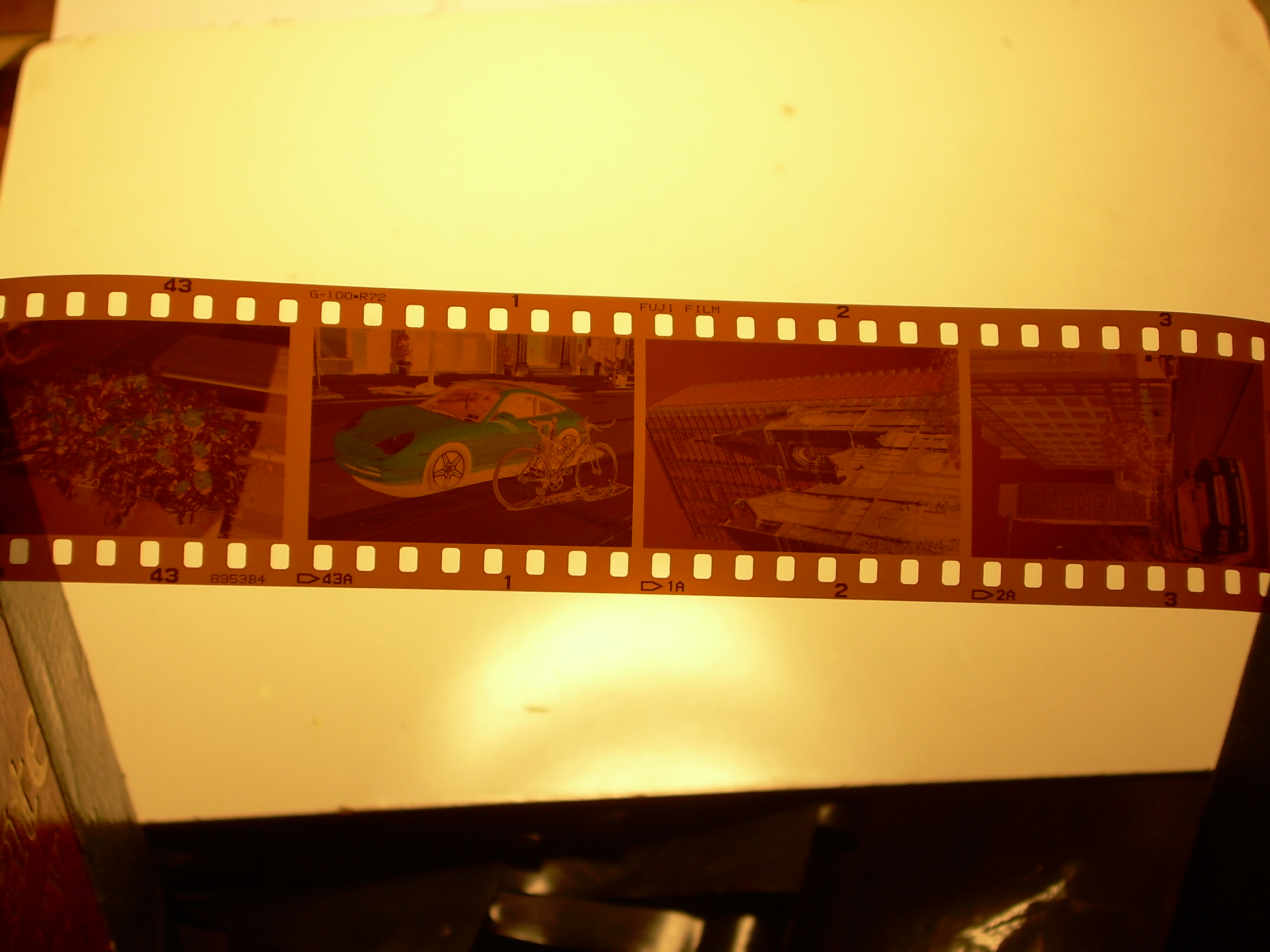

Here are the negs I processed this morning. (I shot the negs with my cheap digital camera, so the shot is lousy.) I have neither the software nor knowledge to pretty them up, but you can get an idea. If you need yet more and more proof it would be better for you to heed with others say rather than what I say. Makes life simpler. - David Lyga

I used Kodak developer in my tests. The curves were so wonky, I can't see extending development times would help. It never helps with low temperature processing tests, using normal dilutions, to improve the curves. It is all because of the delicate nature of the mult-layer C-41 film and diffusion-critical process. The closer you get to the standard development, the better the results.

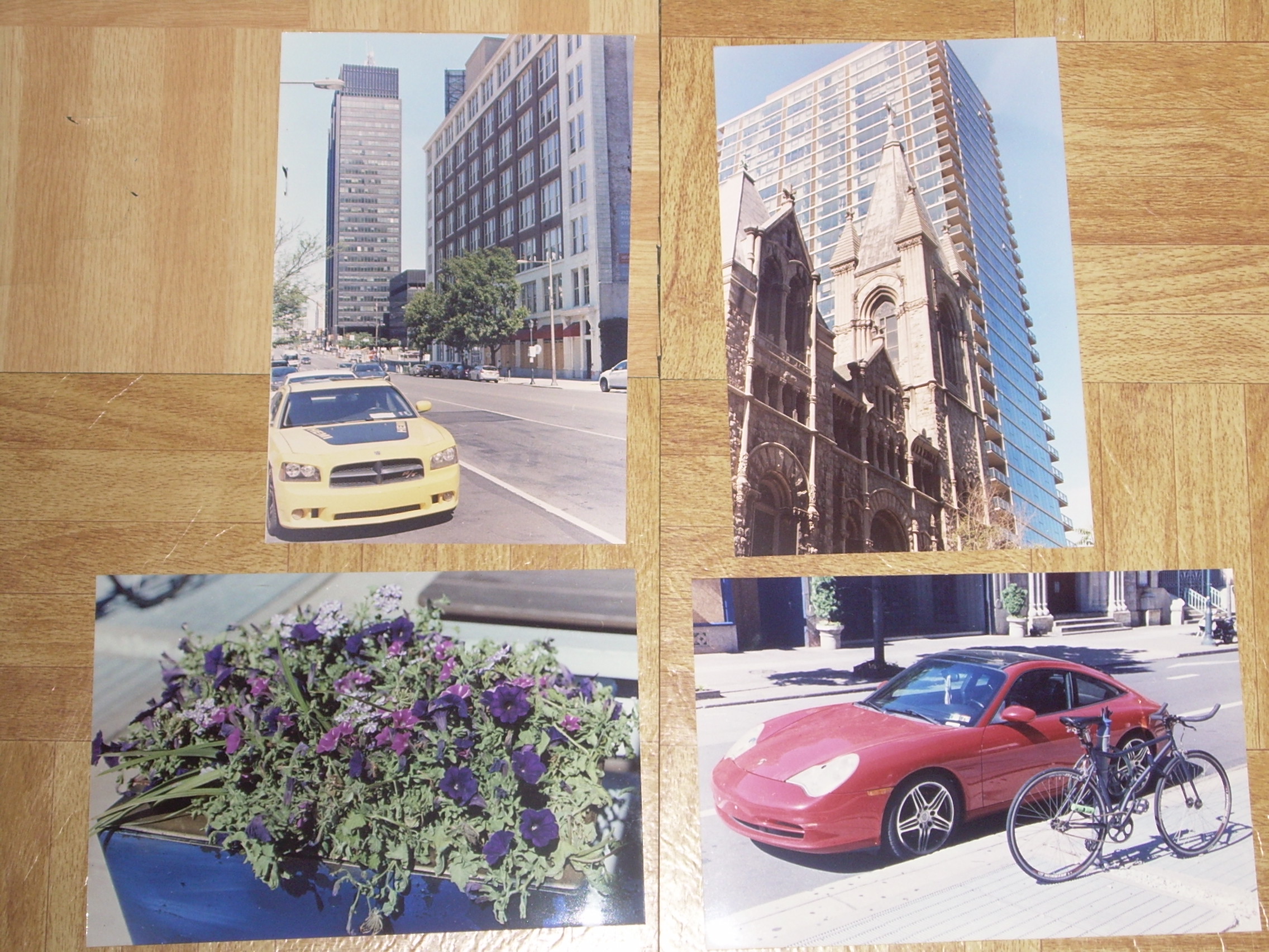

I just sent the photos. Warning: just sending four 6 X 8 photos across the Atlantic costs $14.50 the cheapest way and it takes a whopping 16 days to get to Europe. Before I sent the photos, I shot them with my very cheap digital camera so you will know what to expect.
I processed the negatives in 1 + 9 Kodak C41 for 9 minutes at 100 F. I processed the prints at 1 + 9 Kodak RA4 and developed for three minutes just to be certain to get full development. Nothing is a winner here, but you will see that the photos are halfway decent. Next time I had better shut my mouth. - David Lyga
