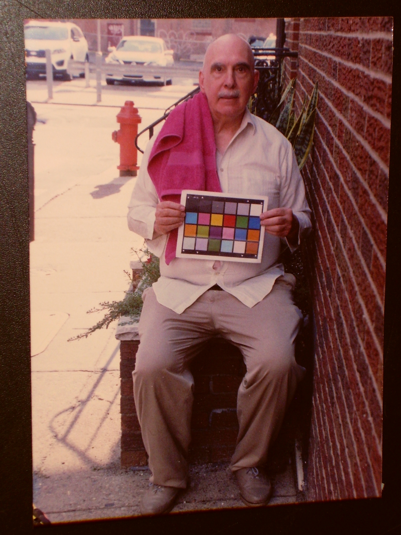

For what it is worth, I took my picture last week. I tried to get as much color as possible, and I made certain to get shade (me) and sunlight (on my right and behind). It was taken on the same film (Fuji Super G+, expired 1998, ISO 100). I rated it a bit slower (maybe one stop) and developed it in C-41 Kodak Flexicolor 1 + 9 for 9 minutes at 100 F. The print was processed in Kodak RA-4 RT 1 + 9 for 3 minutes at ambient (80 F): Fuji Archive. I took the picture of the RA4 print with my cheap digital camera, so do not expect the highest quality. But you can get the idea.
I would also like to make a comment about RA4 prints, in general: The contrast level for negatives to be printed on RA4 paper must be somewhat truncated in order to obtain detail in both shade and sunlight. I remember that when Cibachrome came out in the 70s, we all marveled at the fantastic and vibrant print colors. But there was a price to pay for this magnificence: Contrast was, at times, unbearably extended. The reason why I am bringing this up is because, sometimes, a sacrifice in the tonal range of detail is mandated when we are after vibrant hues which scream out at us. With B&W, sometimes mid tone separation is more important than capturing the last details of both dark and light extremes. With color, if the negatives are somewhat overdeveloped, the sacrifice wrought by the excess contrast is mitigated by the bounty of having colors that are very saturated; again, the tonal extremes would be compromised, deficient of detail.
In sum, there are two different ways of looking at this imaging aesthetic, whereby one emphasizes hue saturation (or mid tone separation with B&W) AND the other emphasizes 'capturing it all' but comfortably conforming to the paper's rather narrow ability to register the complete tonal range. Sometimes this restriction makes for a somewhat drab print. This decision, more than any other factor, stresses the advantages that sheet film has (individual development) over the need for 'average development' of roll films. - David Lyga
