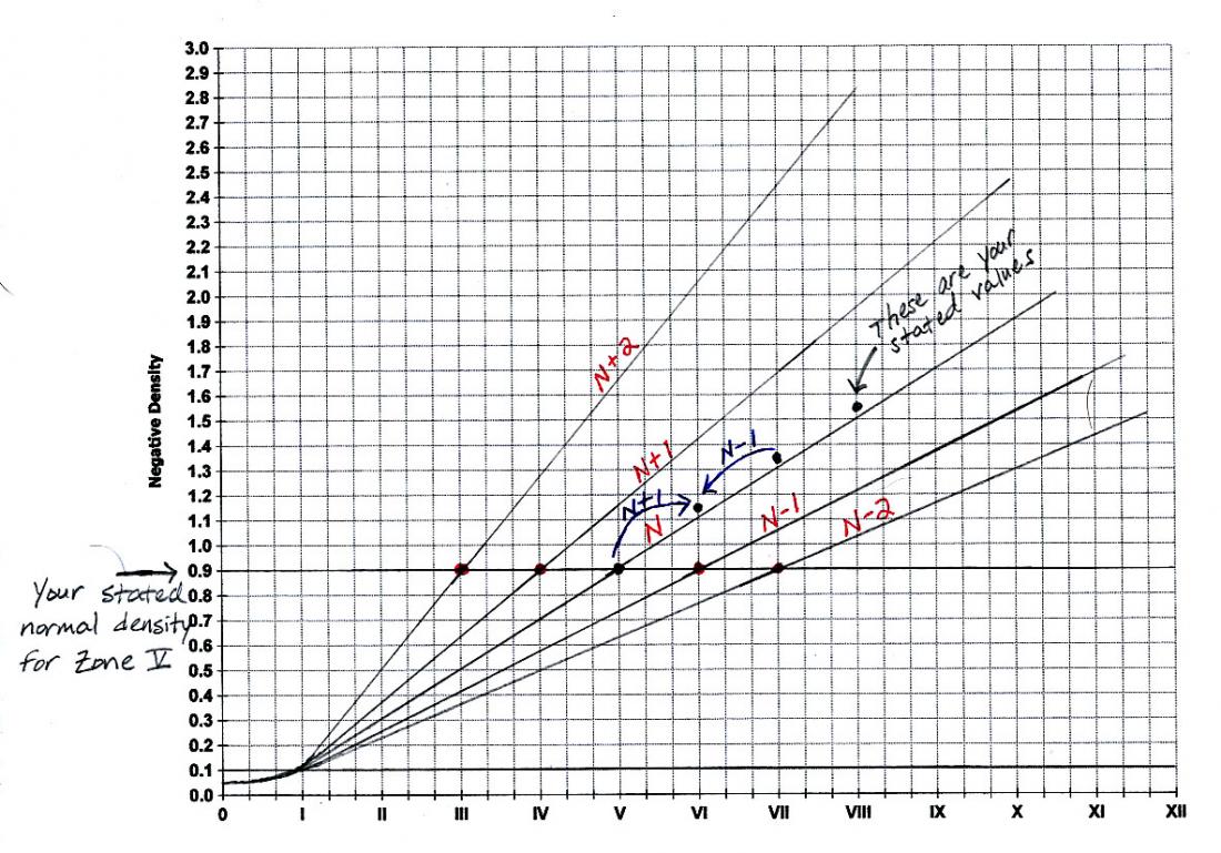

With my definitions I mean an N+1 is Zone V placement yields a Zone VI density in the print and so forth. N-1 is a Zone VII exposure yields a Zone VI density in the print and so forth.
I fully believe that when commenting publicly in these forums that we should be prepared to be challenged in what we say. So, I'm challenging you on this one particular assertion that you are making as it is the one single thing that is sticking in my craw in this discussion.
You have already stated that your "normal" calibration is based off a Zone V density of between .85 to .95, or .9 to take the middle------ok, that's your choice, I don't understand it, but that's your choice. But your discussion of expansion and contraction of the negative is patently wrong as it relates to the ZS as I see it---your "definitions", as you call them, are a mutilation (no disrespect intended) :wink:.
Any film/fev/dilution combo has one "normal" development time that achieves a desired negative density at a particular zone. In my case (and most that I've seen) it is a Zone VIII density of 1.3; I saw on Alan Ross's website that he is experimenting with calibrating his normal development time based off a Zone IX density of 1.45. You have stated that yours is a Zone V density of .9.
You appear to be stating that your expansions and contractions are occurring along the same curve using a single stated development time of 8 minutes with whatever film and developer it was. This is impossible if you claim it is the ZS-----each expansion and contraction has its own curve, defined by a development time needed to get the curve to cross the target density line at the proper zone.
To back up what I'm trying to say, I've included a graph to try and illustrate it. It's a simple set of simulated straightline curves that assumes the correction for EI (hence the reason all the curves merge at Zone I). The "red" indicates what I'm saying and the "blue" is what I think you are saying; the solid black dots are the densities you stated earlier for those zones.
Larry Bullis
May 23, 2008
1,265
White Rock, B.C. Canada
Sorry, Chuck. I'm lost. What your curves are showing me is that what he's saying is not at all what your "blue curve" shows. What I think he's saying is more like the whole set of curves you are showing. I think you guys are talking across each other's bows.
