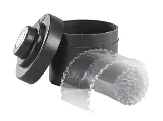

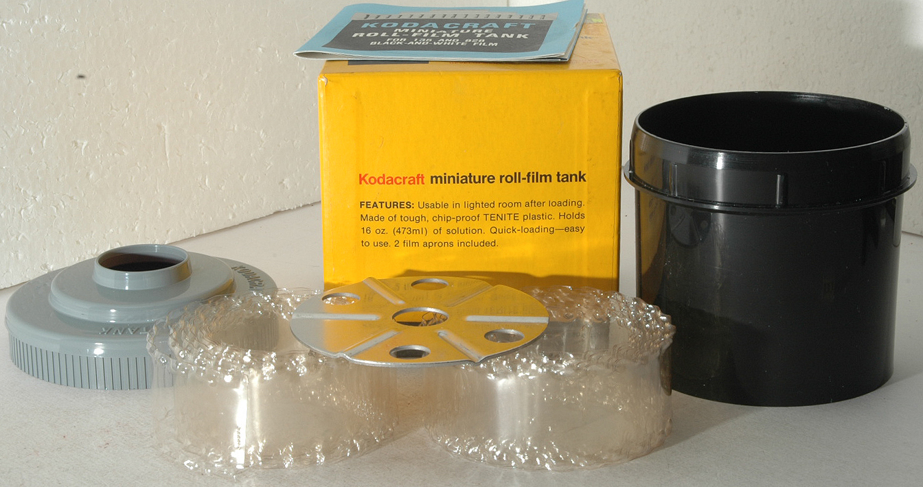

OP was posting about the Kodak system with did not use a reel, film was rolled up into the apron inserted into the tank and plate was set on the apron to keep the apron from floating up in the developer.
These are the types of film developing aprons I've seen before...
Thanks for this - I wonder if anyone has used the dark apron - I just purchased a type B tank with an apron that looks like the one in the attached photo. I hope to use it for Washi Y film emulsion on kozo paper

That apron is old enough to be historic!
Same for the reel.
I've seen references to them, but never a photo of one "in the flesh".
