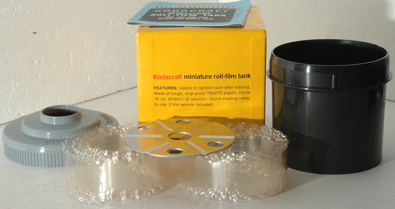

Sounds useful but I cannot envisage what an apron looks like that makes it perform the function of a reel but is easier to load. Can you show pictures of it?

I began my darkroom "career" with a Kodak tank which used aprons. IIRC my Father and I had aprons for 35mm, 120 and 127. What do they look like? Imagine a transparent piece of lasagne the length of the film plus a little, with a small roll at one end secured with a rivet. In total darkness the end of the film is put against the rivet, and the "lasagne" with its frilled edges, is wound up with the film, forming a sandwich. In the Kodak tank a slotted metal plate held the whole thing down; I additionall used a properly sized rubber band around the roll of film/apron. No inversion agitation. The device worked well; with 35mm the perforations hid the tiny spots of contact with the apron, on 120 am 127 the spots might be visible depending on the film gate of the camera. I used the tank for Ektachrome processing, the one with reversal via photoflood lamp!
Something like this?
They are easy to use and was indeed my first tank back when I was 12 years old. Sadly they are not very durable. Plastic tend to become yellow/brown and become brittle with use. At least they did for me. Also, almost positive they started to degrade with color film and E6 chemistry.

While in high school we used Kodacraft tanks and aprons. The metal plates sits on top keeping the apron from floating up and it allows for one more than one roll to be process at time. We had both 35mm and 120, the tank held 2 35mm or one 120. They were great for high school kits, never lost a roll due to poor film handling. Our process was to load the tank in the dark then add the developer and put the top on then turn on the white lights. With use they turn brown. Not long ago (within the last 10 years) I saw a new third party apron and tank on one of the film sites, might have been Freestyle.
Certainly a new piece of kit to me. Thanks all for the explanation and pictures. It isn't immediately obvious from the picture of the apron but from GRHazelton's explanation it sounds like the edges of the apron have raised bits to ensure that the film doesn't stick to the apron which might prevent development. Have I got this right?

Yep - the raised bits keep the layers separated, and the film "floating" in between.

Quite right! Dried lasagne pasta was the best example I could come up with. I don't know what happened to my old tank....

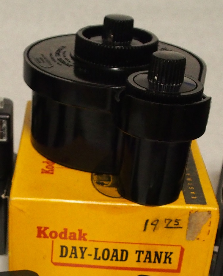

I have this Kodak Day-Load Tank that supposedly you can load a roll of 35mm film without needing a dark room or dark bag. It uses an apron like the one mentioned above but somehow you load the film into the small chamber and then turn a knob to feed the film into the apron. Obviously I haven't tried to use it yet, I need to look at the instructions.
