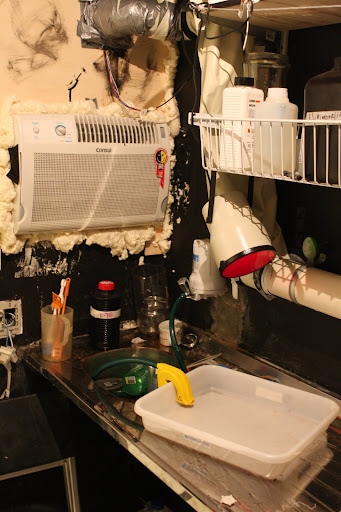

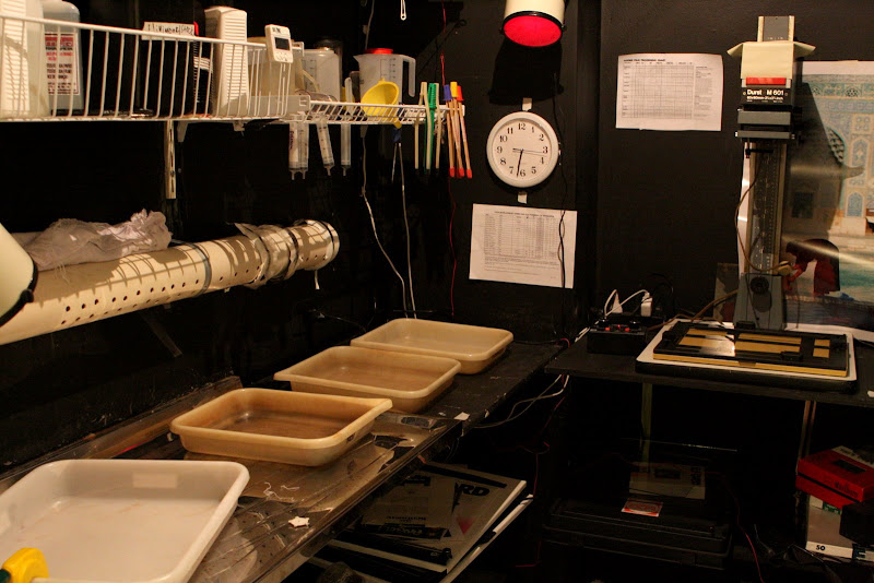

Hey guys, this is my lab that I made in a small room at my apartment.

Thats quite a large air conditioner unit Yan, must be freezing in your darkroom.

MIke. it can get really hot in Brazil in summer and an air con like that is what you need when temperature reaches 30c, 32c degrees.

Hi Yan, Well it looks like you are well prepared,I just used my air conditioner for the first time this year for a short while today temp. reached 97deg. f. Lately I have been printing early in the morning on weekends and days off from work,I like that better than staying up till 1 or 2 in the morning.Nice darkroom Yan stay cool.

Thanks Mike. I´m trying to work during day hours too, but is hard with all this pressure to work more and more that we have today.
