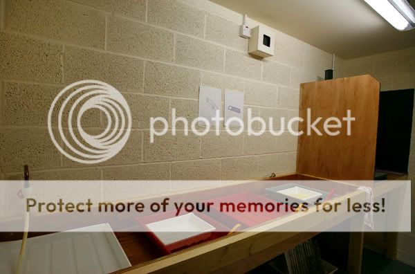

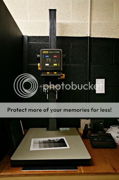

ic-racer Your darkroom looks great. Was that Durst baseboard ever used as a door at any time in its life :) ?[/quote said:
Well spotted. The baseboard was not in good shape when I bought it. There were a few custom switches and some old wiring coming from the side which I removed. I filled some holes, sanded it back and painted over the original laminate finish but maintained the original alignment compass thingy in the middle. Still haven't figured out how that works!

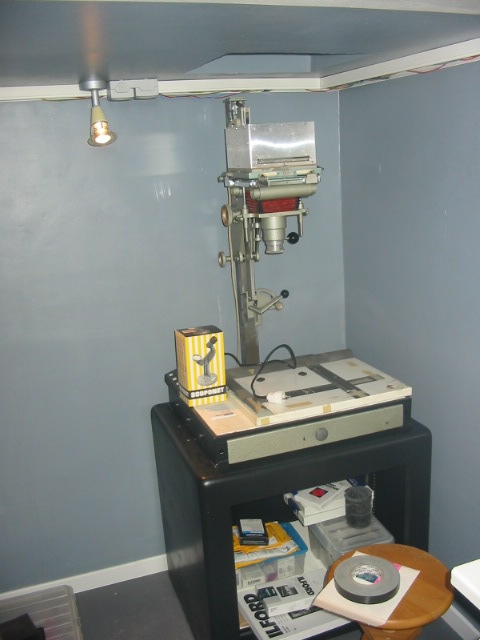

It's been a while since I've posted mine, and in fact I think my photos from this thread have been deleted a long time ago, so I might as well post again.
It's been modified a fair bit (well, almost as much as you can do given the space) to accommodate my 4x5 enlarger and allow me to print up to 16x20 (still gotta get the trays). I picked up the 16x20 easel that's under the 4x5 enlarger a few weeks back for $1 (I still can't believe it!)!
I'm also meaning to get some lens boards machined up for the 4x5 enlarger, because they literally don't exist on any market, but that's easy enough to do. Also need a plug for my smaller enlarger so I can get both up and running again. It's been a while now since I've printed anything.

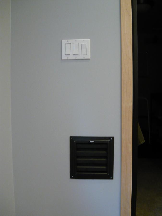

Doran louvers
ic-racer,
I do have a ventilation fan. And it finally occurred to me, after I posted my question, to look for installation instructions in the box with the louvers. The emphasis however tends to be on installing the fan, rather than the louvers. And the drawings also indicate that one should mount the louvers in the LOWER part of the wall rather than the UPPER, where I'd planned to. My husband is an engineer and says that the positive air from the air conditioner in the adjoining room will be cool and will tend to fall. I hope it will be okay. The ventilation fan will be installed just above the back splash of the sink.
I really appreciate your response.

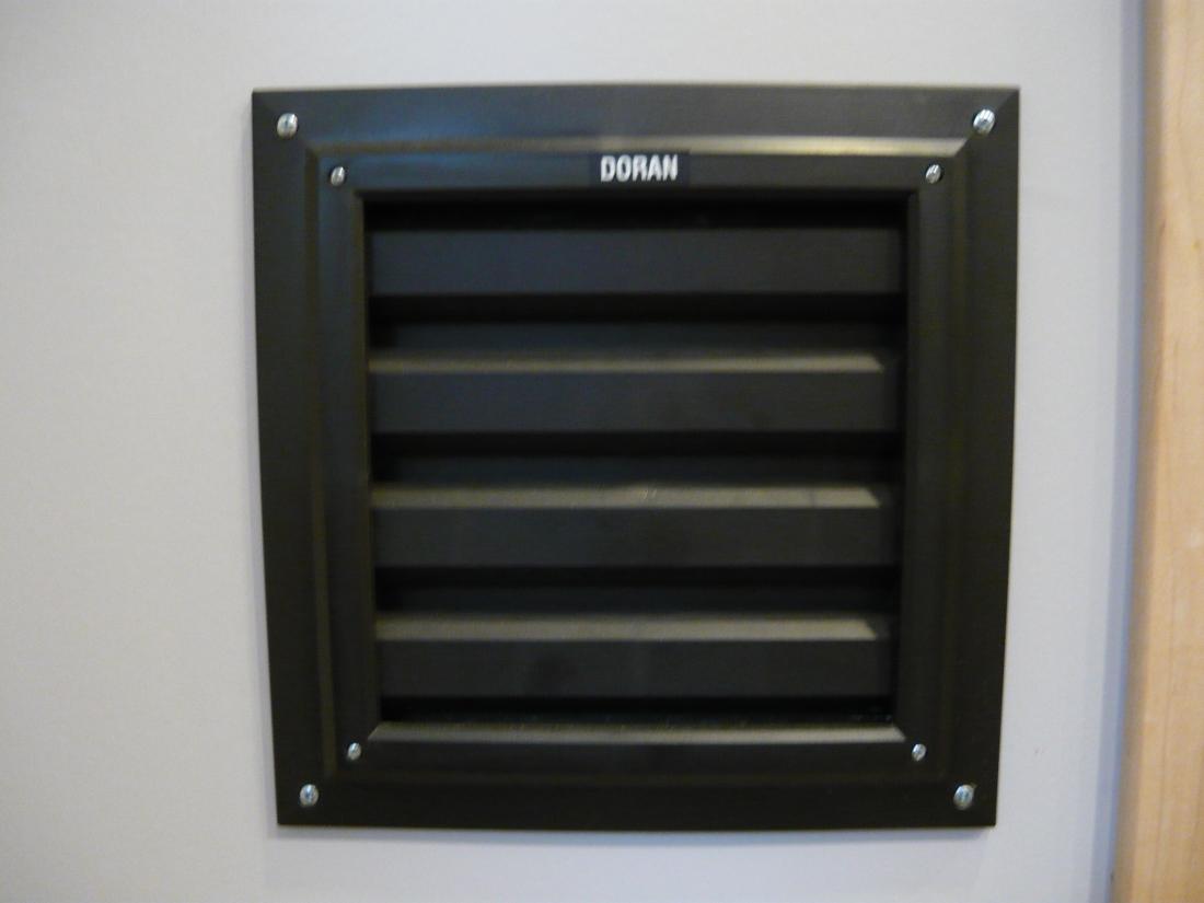

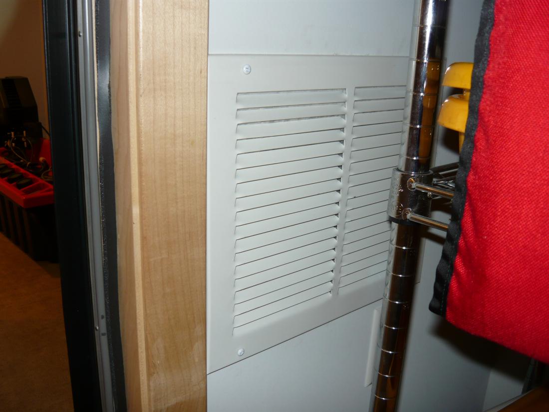

Here are a couple of pics of my Doran Louver.

Jerold,
I had seen the website below a month or so ago and had forgotten that this was why I had decided the louvers should go higher on the wall:
"By pushing the chemical vapors in the sink down and back towards the rear of the sink, it keeps them out of the respiratory system of the person working over the sink. So, its important to place the light tight louvers above the head of the printer, and not what is typically found in most darkroom as shown below. Note 2 indicates that make-up air should enter the room at the eight (8) foot level."
Dead Link Removed
Not sure how much difference this will make but I'll keep the framing where it is (higher), rather than change it.
I like your solution for the inside-the-darkroom vent cover and appreciate the photos very much.

I went to Home Depot to get a vent cover for the interior of the dark room (like Jerold's) and found it, but couldn't find a filter that my contractor had talked about: blue, plastic (or fiberglass?) ,washable, and which probably would have to be cut down from a larger sheet. So I bought the only 12x12x1 filter that is not washable, but seems to fiter down to very fine particles (mites and pollen and mold spores). It's a Natural Aire Standard with an 8 rating. It's white and fibrous. I hope it isn't so fine as to block the flow of air or that fibers will blow around.
Can anyone recommend a filter for the louvers to combat dust?
Sara
Sara
Sara
Not a direct answer to your question, but I use one of those recirculating HEPA filter units that I keep running to suck up the ambient dust.

With the relatively small amount of air flow, you won't need to change the filter much. I have not changed mine in three years.
The HEPA filter is a good idea. I don't have one but most people say they work great. If you happen to have a central vacuum system, use that for cleaning so the dust is not simply re-circulated.

I have recently installed three Doran 12X12 louvers in my darkroom. Two high and one low, mainly because that is where I could place them without getting in the way of something on the other side. There is a finishing piece that can be placed on the other side. I took some black foam board and built a box between the sheetrock, taping it carefully with gaffers tape to prevent sucking insulation/dust in from the void between the walls. Can't tell you how it works yet, as the project continues. Should be up and running in a few weeks. Bill Barber

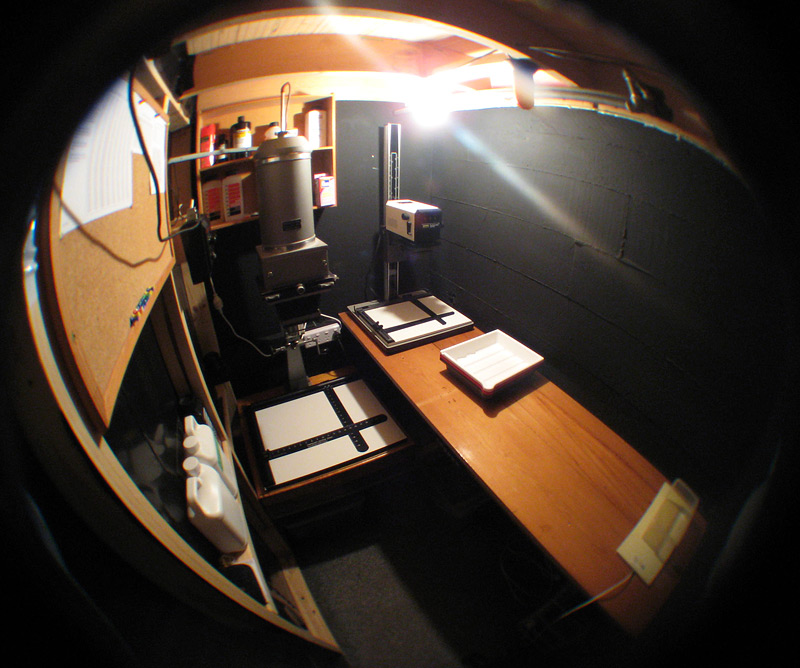

This is my -almost finished - darkroom.
The place is still a bit cluttered and messy, but it works...
I'm adding a new cabinet next to the enlarger, on top of which I'll put the time and other stuff..
The sink is a bit small, but deep, and at this end I can print there.
