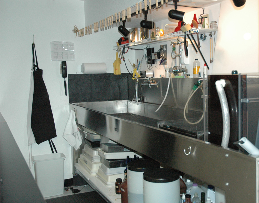

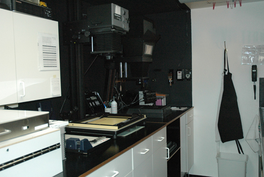

My darkroom is about 9 x 15 feet. The photos show the working sections. The dry side includes two enlargers: a LPL 4500 with Super Dichroic head that is used for negatives up to 4 x 5 inches; and, a Zone VI with the 8 x 10 head that I use for 5 x7 (I have the 5x7 head, also), 4 x 10, and 8 x 10 (infrequently) negatives. The darkroom is on the lower level of the house (aka, basement) and the ceiling in the darkroom is less than eight feet, so the bench under the Zone VI enlarger has a drop down top. I used assemble-yourself cabinets from Home Depot, but put them on a platform that raises them up six inches. It makes a much more comfortable working height. The cabinets are deep because I didn't want the easel to hang over the edge. I'm six feet tall, so I don't have a problem with the depth or the height.

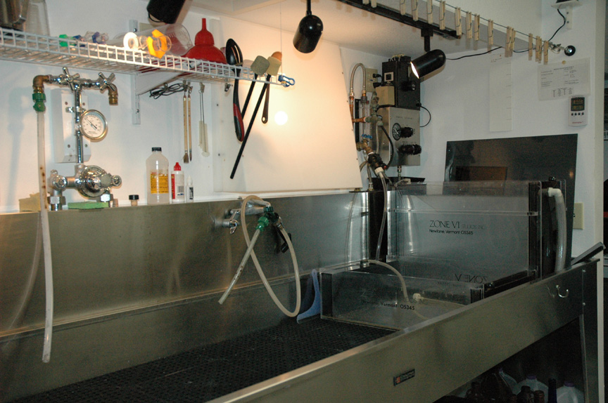

The wet side features a 10 foot stainless sink, two thermostatic valves (one for the print and film washers, and one for tempering water for mixing chemistry and other tasks), as well as two standard mixing faucets, all downstream from in-line water filters. The sink is also raised about six inches; otherwise, it would be very uncomfortable to use.
In addition, there is lots of storage, very adequate counter space, satisfactory ventilation, a comfortable rubber mat on the floor, and speakers tied to an adjacent sound system that I can control with a remote from the darkroom. I could almost live in here.

My seven year old daughter just said, "Now that's a nice darkroom". I'm in total agreement :smile:

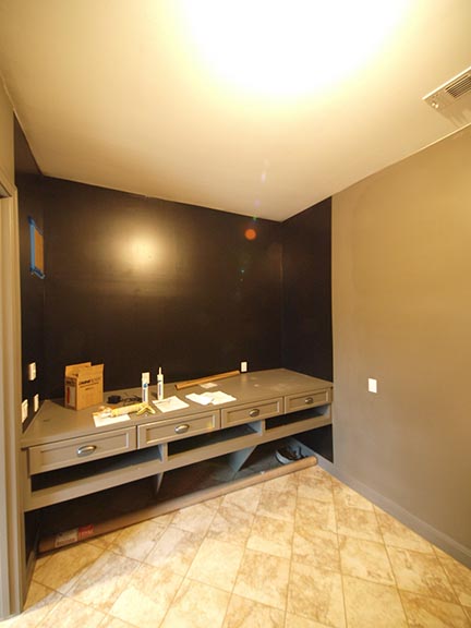

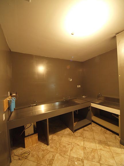

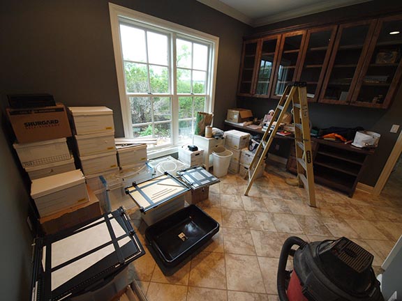

After living most of my life without a personal darkroom, that is about to change. For several years I've been hunting and gathering in anticipation of building a retirement home with a wet darkroom. This past weekend I finally got "wet" with the hekp of a plumber. There is still a bit to go, however the construction part is more or less complete. Here are a few photos of the space (about 9.5 feet wide on one end, 12.5 on the other, 15 feet long and 10 foot ceilings) and some of the stuff that will go in it. Most equipment was purchased used. I'm excited. The proof is in the pudding and I plan to post some of my images in the gallery section when it becomes operational. Bill Barber

This is one of my favorite threads. Good luck Bill, thats going to be a fantastic darkroom.

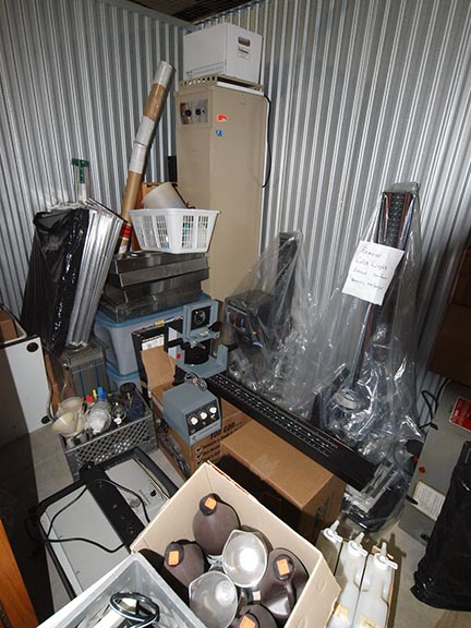

Bill, I'm laughing my butt off right now. Your third picture looks exactly like my basement work-out room has looked for the past 6 months. My wife isn't sure whether she gets more exercise on the treadmill or by jumping over the light table, enlargers, jobo units, etc. Congrats on getting closer and closer. I'll be doing the same in about a month.

The last picture is of a storage unit that contains 4 enlargers, two film drying cabinets, a couple of presses, a print drying cabinet, screens, print washers, bottles, gadgets and doodads. There is actually another image I didn't post with a bunch of my stuff in a holding pattern waiting to get moved into the darkroom. One of the nice things about our new house is I have a separate space for my stuff that doesn't have to be shared. It isn't that I don't play well with others . . . Bill Barber

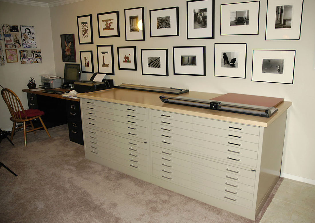

I use either a rental darkroom or my friends darkroom. I did recently get these flatfiles and made a top for them. This is set up on one side of our living room luckily which is large.

Roger, I'd love to find some flatfiles like those. What would even make it better would be if I could trade for something I had but didn't need. Bill Barber

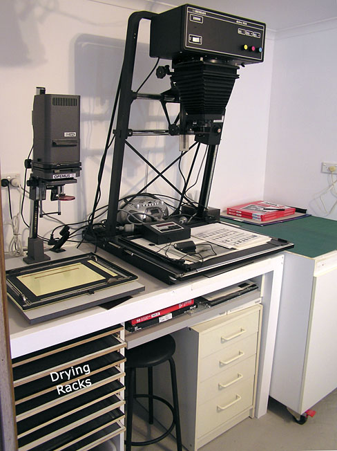

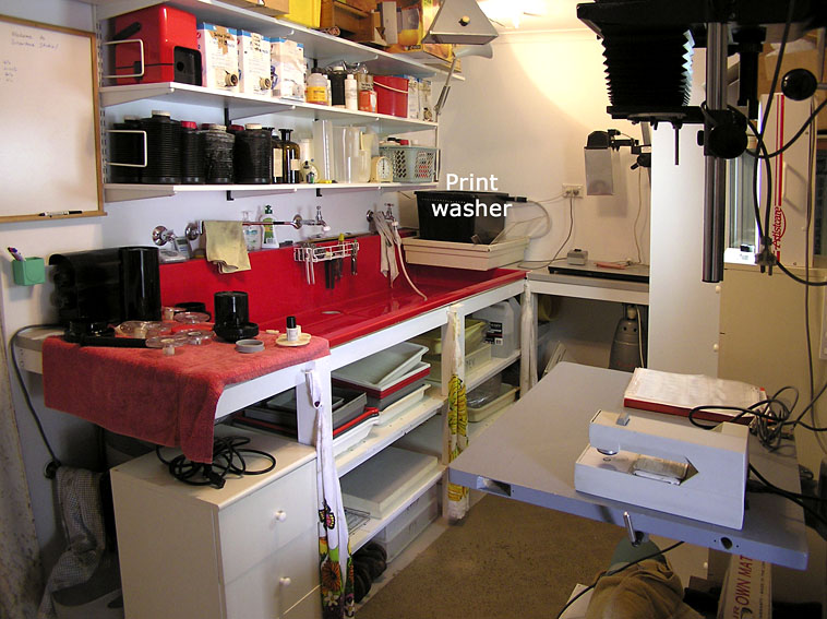

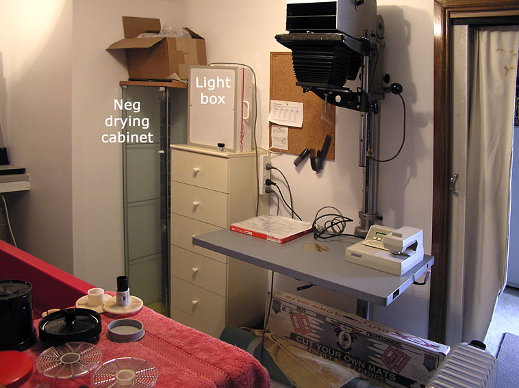

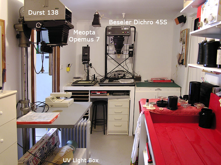

Here's my first designed from scratch darkroom. It was built inside one half of a 2-car garage and fully insulated to keep temperature variations to a minimum. We moved house late last year and a potential darkroom space was a must-have on the shopping list! I designed the space with wiring and plumbing requirements and had a builder complete the frames and walls and I did all the sink, benchwork, shelves etc. Finally, no more negatives drying in the shower recess! Thank you Ikea for my glass drying cabinet just the perfect length for a roll of 35mm film. I'm still making a few adjustments here and there as I figure out the best workflow but it's a great place to be day or night.

You darkroom looks great.
Was that Durst baseboard ever used as a door at any time in its life :smile: ?
