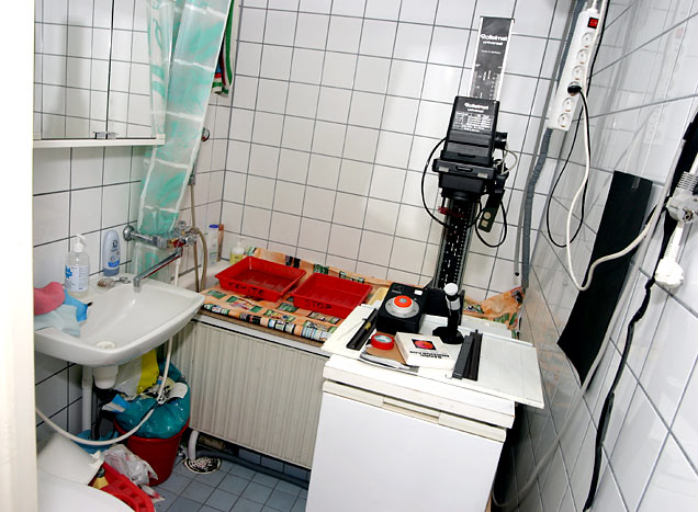

Some of you have very nice darkrooms, but what about this one (my own darkroom that is) - the toilet darkroom in my one-bedroom apartment, aka "tha place 2 be". The enlarger on top of the washing machine, paperbox on top of the toilet seat and dodging cardboards on the floor next to the washing machine. And this magical setup combined with my apartments window placement -- all windows on the same wall = no draft / no ventilation! :smile:

PMU,
Hey, that's a great setup. From the looks of your gallery, it seems to work perfectly well for you! Very nice job on both.

PMU, that's a fine darkroom you have set up there. I am sure it smells better than mine. A word of advice: if you remove the toilet seat, be quick to close up the hole.

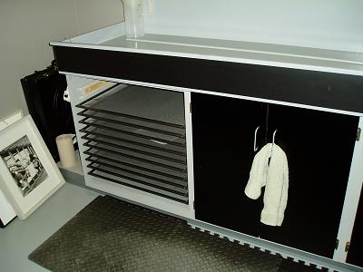

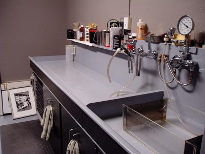

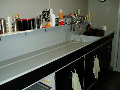

I am new to this forum but not new to photography. I have built several darkrooms for myself and former students. Each one presents challenges based on room size, available power, plumbing, etc. My newest darkroom is built in our single car garage (separate from our two-car garage). When shopping for a new home my wife and I made it a priority to find a plan that would allow us to build a darkroom without too much fuss or remodeling. I did all of the work myself from framing, electrical, plumbing, drywall, cabinetry, countertops, sinks, door installs, etc. I hired nothing out and did it all solo. I started in early July 2004 and finished in November of same year. It was more work than I anticipated but well worth it. The darkroom takes up about 1/2 of the 11' x 22' garage (about 130 sq. ft). Let me know what you think?

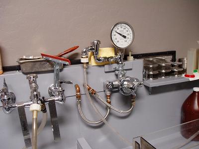

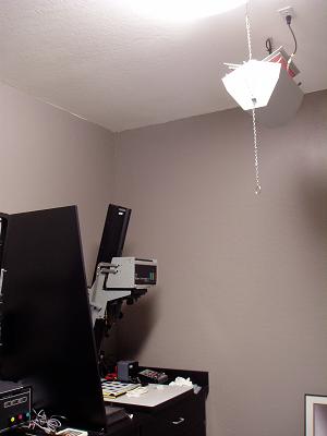

A few more views
Some of the more important stuff.

Very nice. I don't think the waste basket would handle my output but everything else looks 1st class. One question: your sink looks to be of sheet wood and painted. What paint did you use?

Hi Bruce, You are correct. I constructed the sink using 3/4" AC plywood with 3 coats of Rust-O-Leum garage floor epoxy purchased at Lowe's. I mixed just enough of the two part epoxy to do one complete coat at a time, allowing each coat to dry thoroughly. I used the same stuff to do my darkroom concrete floor which is where I got the idea. I am very happy with the end result and expect it to last a long time. I caulked all of the seems before apply the epoxy to ensure a water tight seal. It cleans up pretty good so far. I used half-round moulding to create the two duck board rails to hold the trays just above the sink surface. I built two sinks attached end to end. The main processing sink is 26" x 84" and the smaller wash sink is 26" x 36" for a total of 10 ft. in length. Both sinks are sloped enough for proper drainage. I have to still build a film drying cabinet which will occupy the space I left at the left end of the sink to handle 35mm x 36 exp. film as well as medium and large format films. I know what you mean about the wasted basket. A 55 gallon drum would have taken up too much space otherwise and the smaller of the two forces me to take out the trash more often.

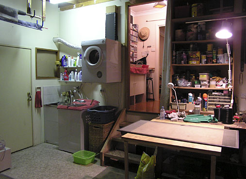

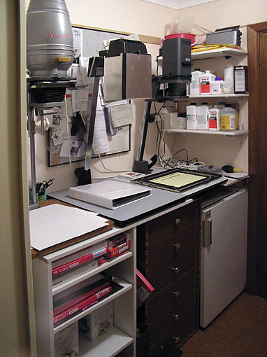

Here are a few shots of my semi-permanent space. A small dark room which leads into a large garage/laundry area for washing,toning and drying. The old magnifax enlarger on the left is for flashing and the unit in the middle is a light source I created for contact priting digital negatives. It is a $10 100watt floodlight with an aluminium housing bent around it to direct the light (no lens). The bottom of the aluminium housing has a couple of lips which hold a diffuser made from draughting film and also multigrade filters. Exposure times using pictorico high gloss white film are between 20-30 seconds as opposed to 5 minutes through a normal enlarger when I first experimented with this technique.
This room also doubles as CD storage area so fine music is always at hand. I kinda like moving from the dark space to the garage to wash and tone especially when using selenium where there is much more open space and fresh air. That's also where the beer fridge is located. The orange Agfa boxes may soon make this a truly historical photo...

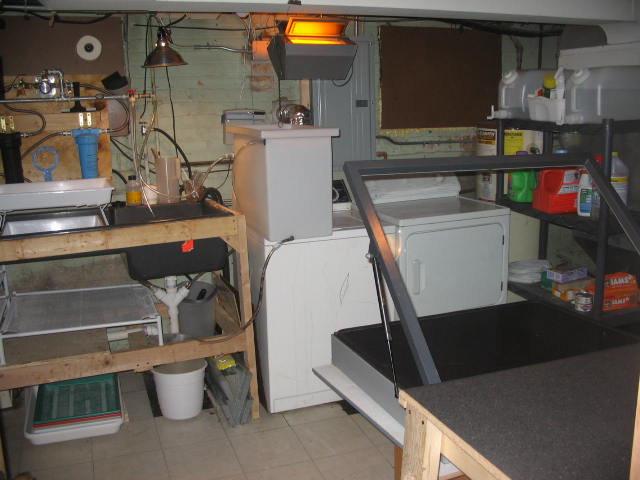

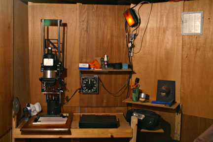

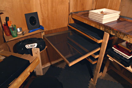

Some great darkrooms here. Here is my first attempt at my own. Unfortunately I rent so cant make it too permanent, though the landlord was kind enough to let me do this in the basement storage area. I haul my water and chemicals up and down 3 flights of stairs, but it works. I cant wait to own a home to build a more permanent darkroom, running water and sink, etc. This thread has really given me some great ideas. I built all myself. My wet area is a recycled futon. Used almost every piece.

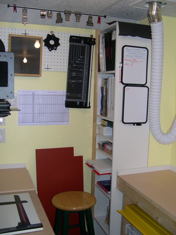

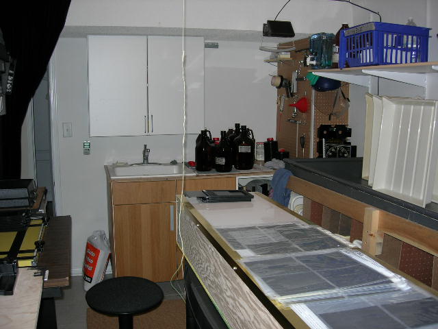

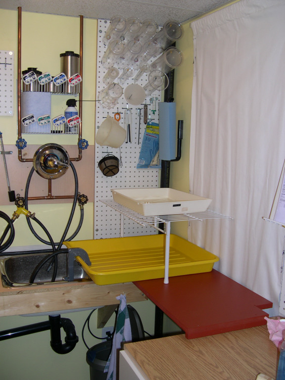

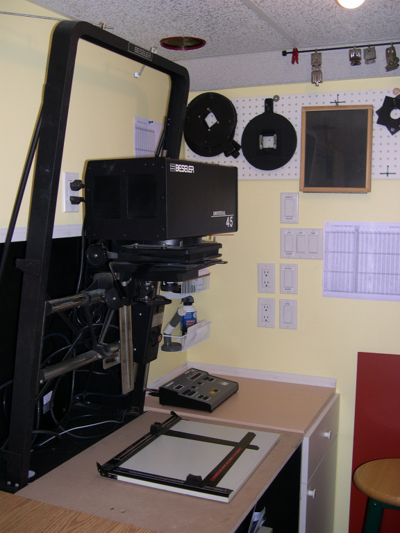

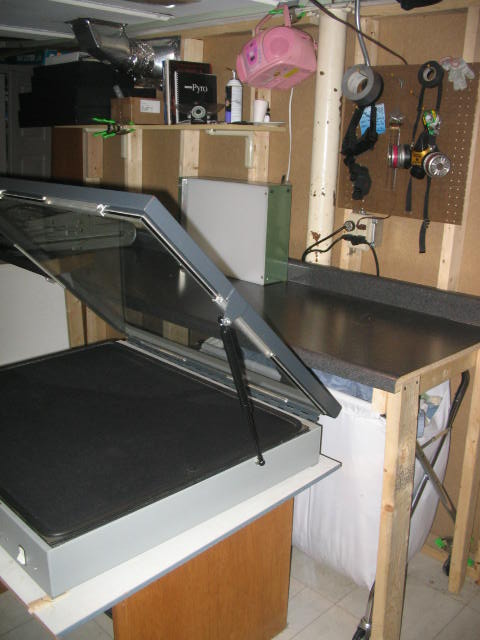

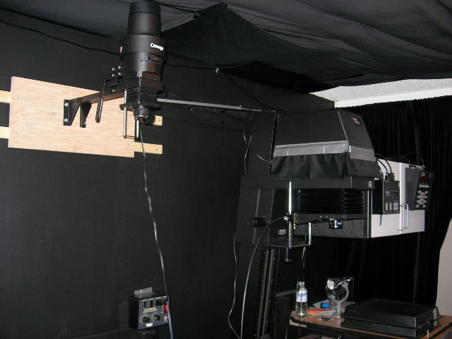

Photos my 4th darkroom (first in 20 years)
It is a corner basement darkroom about 6' by 11' with every inch starting to be filled up. It is small but very comfortable to work in.

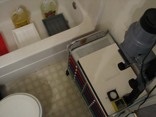

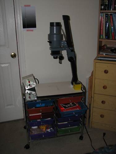

My temporary darkroom utilizes a bathroom and a rolling cart with drawers.
I purchased the cart through *bay, about $20 shipped. It's worth about that, as it can be ricketty and the material is thin. However, it works fine as long as I allow a few moments before each exposure for the enlarger to settle. I like having the drawers, they hold a lot of little odds and ends.
The enlarger is junk, especially for 6x6 but it works. I miss my wall-mounted D2.
When I wish to print, all I have to do is wheel it into the bathroom, screw in my LED safelight, trays with chems. in the tub and i'm good to go.
I also wash the prints in the tub with a larger rubbermaid tub under the tub faucet. The washed prints hang by a clothesline with clothespins (plastic kind, highly recommended!) up near the shower curtain.
It's cramped but workable. Plus the enlarger cart isn't TOO sore on the eyes, my gf actually likes how it looks.
