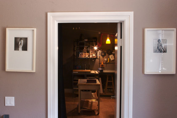

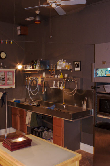

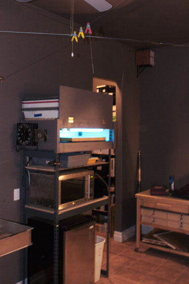

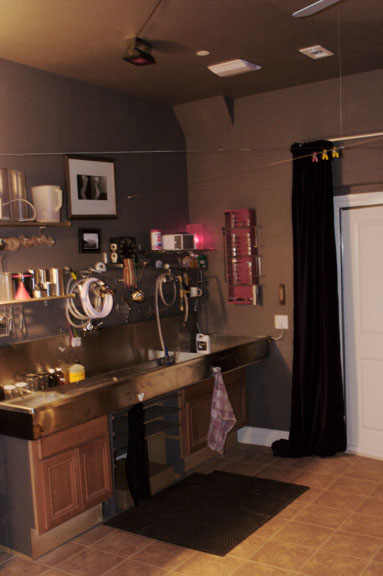

Well, the move is done and the room is up and running. Still needs some cleaning and re-arranging but I've produced work, both platnum and silver so "I'm finally after 5 months back in the silver business!" There is plenty of room for growth (Need an 8x10 enlarger) The room itself is 420 sq ft. Plus 200 sq ft production room (not shown) that is the entrance room. Because of the shutdown I have not had a chance to process so the room will get lots of use getting caught up. over 100 rolls of film and a couple boxes of 4x5 waiting to put the room through its paces. I am a very happy man! This room is a mixture of the very old and new.

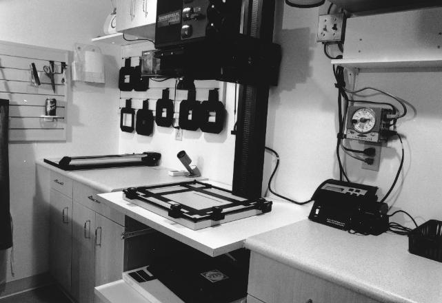

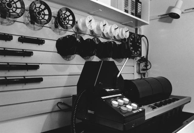

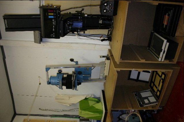

Well I finally got a scanner installed and acually figured out how to get something scanned. So here are some quick shots of the new darkroom (officially opened Apr 1). About 7 years late - we started on the new house then got a lot of attention taken by caring for ageing parents (now deceased) and taking care of my wife's brother while he was dying of cancer. So a planned 3-year project took 10 years to complete. Now with all that behind us, we are at least grateful to have our lives back and the darkroom - better late than never!

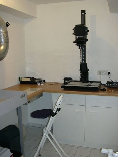

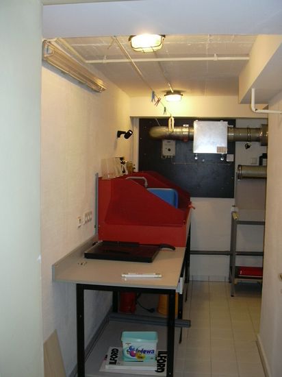

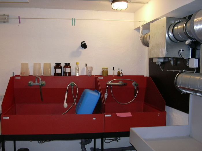

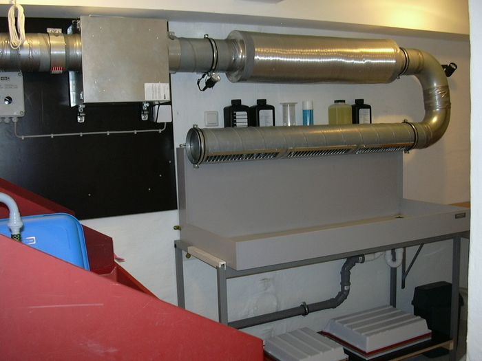

Being inspired by this thread I think I should show you my newly installed darkroom as it is nearly finished.
It's an L-shaped room of 10m² in the basement of our home. The width of the wings - about 4m in length each - is 1.40m and 1.70m.
Obviously the most sophisticated part is the ventilation. It is sucking the air right above the trays, an idea discussed some time ago in one of the threads in this forum. It's very quiet thanks to the silencer built into the duct and the ventilator running in a silencing box. It is changing the air in the room ten times an hour if it is running at full speed. So it should be sufficient for working with selenium toner and other hazardous chemicals showing up in the future.
The tray table and the two large sinks I purchased for little money from professionals closing down their darkrooms.
My enlarger is a Dunco II66 with Ilford VC module sufficient for 35mm and MF. I'd prefer to have an L1200 though :smile:.
cheers
Ulrich

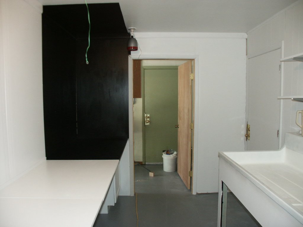

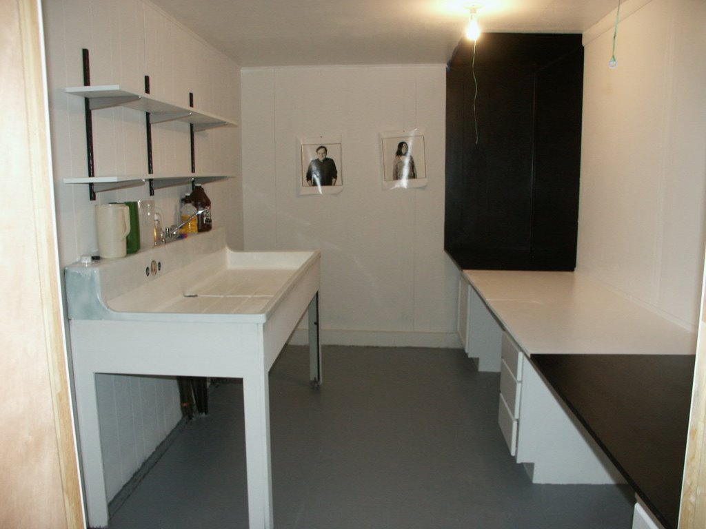

So here is my set-up so far.
I just finished all of the painting today. Thank god. Next week, I will have the electrician come in to install some track lighting, electric sockets and some other things.

Ulrich Drolshagen said:
[...]Obviously the most sophisticated part is the ventilation. It is sucking the air right above the trays, an idea discussed some time ago in one of the threads in this forum. It's very quiet thanks to the silencer built into the duct and the ventilator running in a silencing box. [...]
Ulrich,
I'm quite interested in the silencing aspects of your vent system. I presume the silencing box is just a simple, insulated box, right? Can you describe what the inline duct silencer is and/or provide a pointer to some information? I'd love to include maximum silencing in my vent system. The more ambient noise I can remove from my darkroom the better.
-KwM-
Curt
Sep 22, 2005
4,618
Pacific Nort
Ulrich, is it a vent filter and a heat recovery unit? Looks like a great place to work.
Curt
Curt
Sep 22, 2005
4,618
Pacific Nort
Or is the fan motor in the box?
