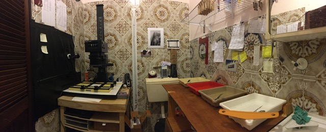

My darkroom is temporary, for as long as we rent this house.
It's squeezed in the laundry pretty nicely. The enlarger sits in a shower space.
Bottom right is the laundry sink that meets all my wet stuff needs, so I skipped on building an extended sink, and just have a 'wet table' for trays as visible on the right.
I couldn't pull the 'dunny' out since it isn't mine, so I just built the wet table around it.
There are more racks for stuff top right out of shot.
Behind is a hot water tank and washing machine, so no more space to extend into.
Would be nice to have somewhere to layout prints/negatives etc. to look at but this is it.

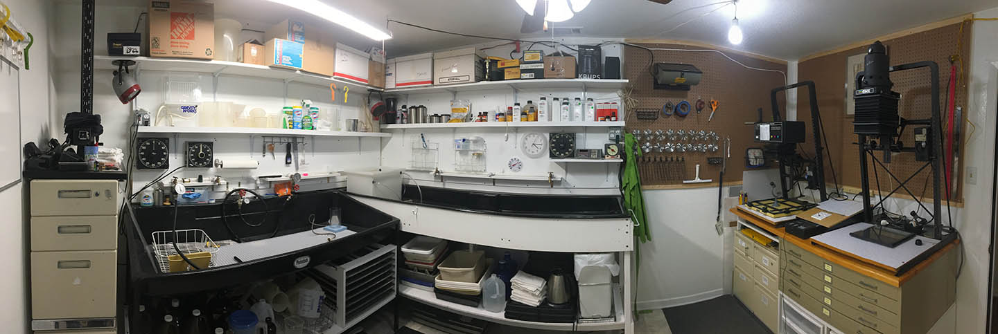

I got a good bit done on the wet side over Spring but evacuating from and dealing with wildfires this Summer had stopped things completely for nearly two months. I am back in the swing of it now and even developed 15 rolls of 120 last night. It was amazing to have a perfect flow from the film loading area ( At right not pictured ) all the way around to drying in a perfect counterclockwise 220 degree arc, it was a blast to use it! There sink at left is 9 feet by 32" deep and the one at right is 6 feet by 26". The 16x20' print washer is under a hinged section of the film processing shelf on the right. The bridge will lift up and be held in place during print sessions and lowered for film. The left side of the 6 foot sink shows the location of the 20x24" print washer.
I have found one of the biggest time sucks in doing the wet side is always looking for ways to reduce water consumption. I can already tell this is an area in which I will try to constantly innovate.
I am hoping to be 100% done by next Spring and have it usable for printing this Fall, I'll see how that goes....

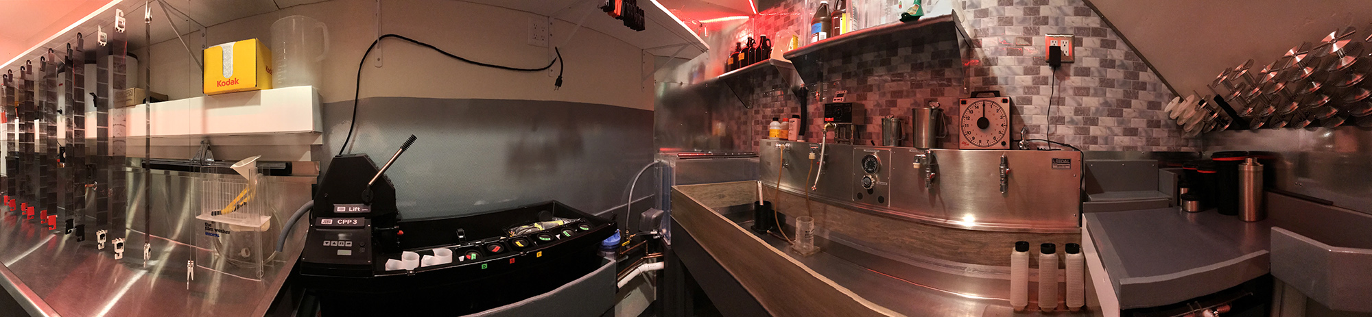

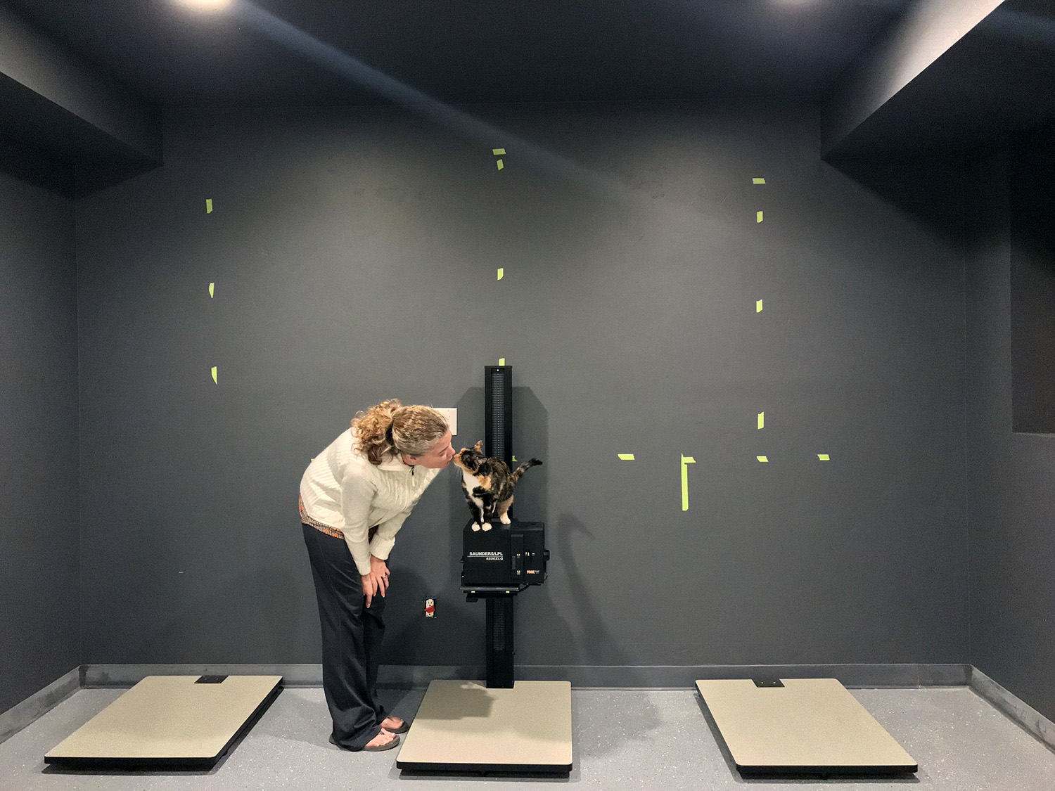

Wet side is done, on to the enlarger wall....
The setup will be three LPL 4550 XLG / VCCE enlargers, two on either side baseboard mounted for up to 20x24 and the one in the center wall mounted to achieve 40x50 at the floor.
The setup will be three LPL 4550 XLG / VCCE enlargers, two on either side baseboard mounted for up to 20x24 and the one in the center wall mounted to achieve 40x50 at the floor. View attachment 207404
............... Wow.! :smile:
Not saying my (especially mine) prints would be any better, but.....every time i see those LPL units, i wish i had them.
I have only SEEN them, like on this thread here, never used one.
But they look like they are a "better" made enlarger than my Beseler 45s.
Seems like having just the center column would be stiffer, and that the Neg Holders are a better design.....seems like they slide in more square and solid... and seal tighter.?
Anyway, i am blessed to have a spare bedroom that has a closet that shares a wall with a bathroom sink, and a wife that supports my hobby, but......i am truly envious of the space some of you Guys/Gals have.:cool:

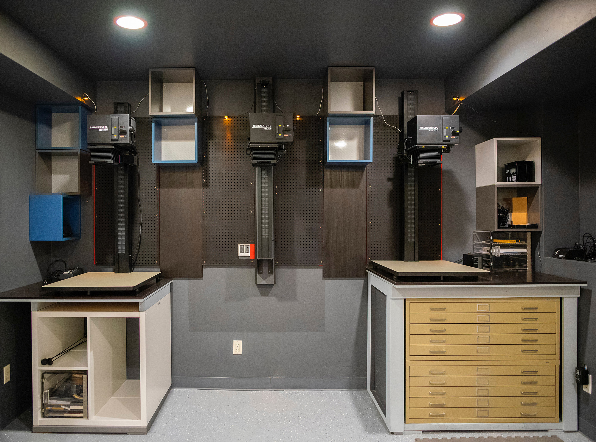

I am back on this build about full time, no major jobs after this month and until December, so I got ahold of my contractor today and we will likely have to rip out some drywall and reenforce between the metal studs for the wall mounted one.
I just scored some awesome countertop finish material today from our local thrift for cheap, two 3'x8 foot sheets of Melamine in a stunning black wood finish for the enlarger wall. I'll cut one into the material for the countertop on either end and then one for the center which will actually be a giant 65"x36" cart that moves for mural printing, countertop will be adjustable for alignment:
Alrighty, moving along really well now.
My contractor / handyman and I decided to just go big, rip out some drywall and create super solid mounting blocks for the mural enlarger that go right into the concrete foundation wall. It's perfectly plumb and as solid as it gets. Projection tests are showing prints up to 45"x54" from 4x5" negs, 45"x45" on medium format, etc. I also had him cut up all that second hand Melamine I got into what I needed so I don't destroy it with my less than ideal blades, it is really nice countertop, some pieces are in-between the pegboard sections for cosmetics and mounting areas. The wall is 13' feet wide and over 8.5' feet high, just enough for what I need this part of the room to do. Obviously I will do some darkening of the inside of the mural area near the floor but for now it is fine.
All three enlargers are up, I will likely hold off on the center piece / cart to give it some more design time but now at least I can print!
Looking slick. Maybe you mentioned it earlier, but is your wet side ready?
