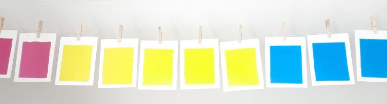

@Vaughn, funny you also happened to be making tissue! I just stored mine away. Poured them yesterday afternoon, they dried overnight and this afternoon they were done.
Mine are not nearly as pretty. 😎 I pour at 1.2 ml of glop per square inch of tissue. Thick as a brick...whoops, that's my head, but the tissues are pretty thick too, and take at least 48 hours to dry, with a fan, under drier conditions than I usually have (60 to 70% RH). I pour 12.5" x 19" tissues using 285ml of glop...wet, they weigh a bit!
For the first time in decades, I actually exposed all the way down to the tissue support...not much pigment in the glop.
The tissues in my photo are about half that. It's what conveniently pools on the paper without any barriers, which I find a convenient way to work. I used to use magnetic signage strips, but ended up just pouring in a marked area and spread using a comb. Ends up at about 20ml for a 5x7" tissue or thereabouts.
I'm doing that now...running an exposure test on a tissue with 0.5% India ink. That's not a lot of pigment, indeed. Not a tissue I normally use for B&W, which would be around 1% or even higher if I need more contrast.
High relief is nice, but I find it's a bit of a liability when doing multiple transfers onto the same transparency sheet and then getting them to transfer onto the final support. The initial transfers work OK, but a thick stack getting to stick to the final support is a bit more tricky when it comes to small details...
One way or the other, hanging sheets of soft gelatin for a day will certainly let one know if one has a floating dust issue in the room! Instead of flypaper, it can be dust paper!
