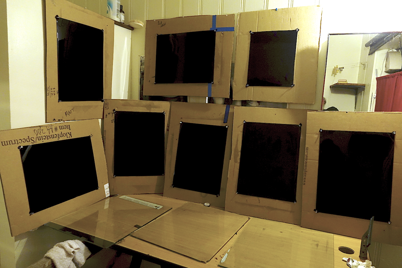

Freshly poured and drying carbon tissue in my 'dimroom/bathroom. No shower for a couple days! I now use clolthes hangers with the two clips (for pants?) Much easier. The tissues needs to have a fan on them for the first 12 to 24 hours to prevent mold. These are basically hanging petri dishes (food grade gelatin, sugar, and carbon).
