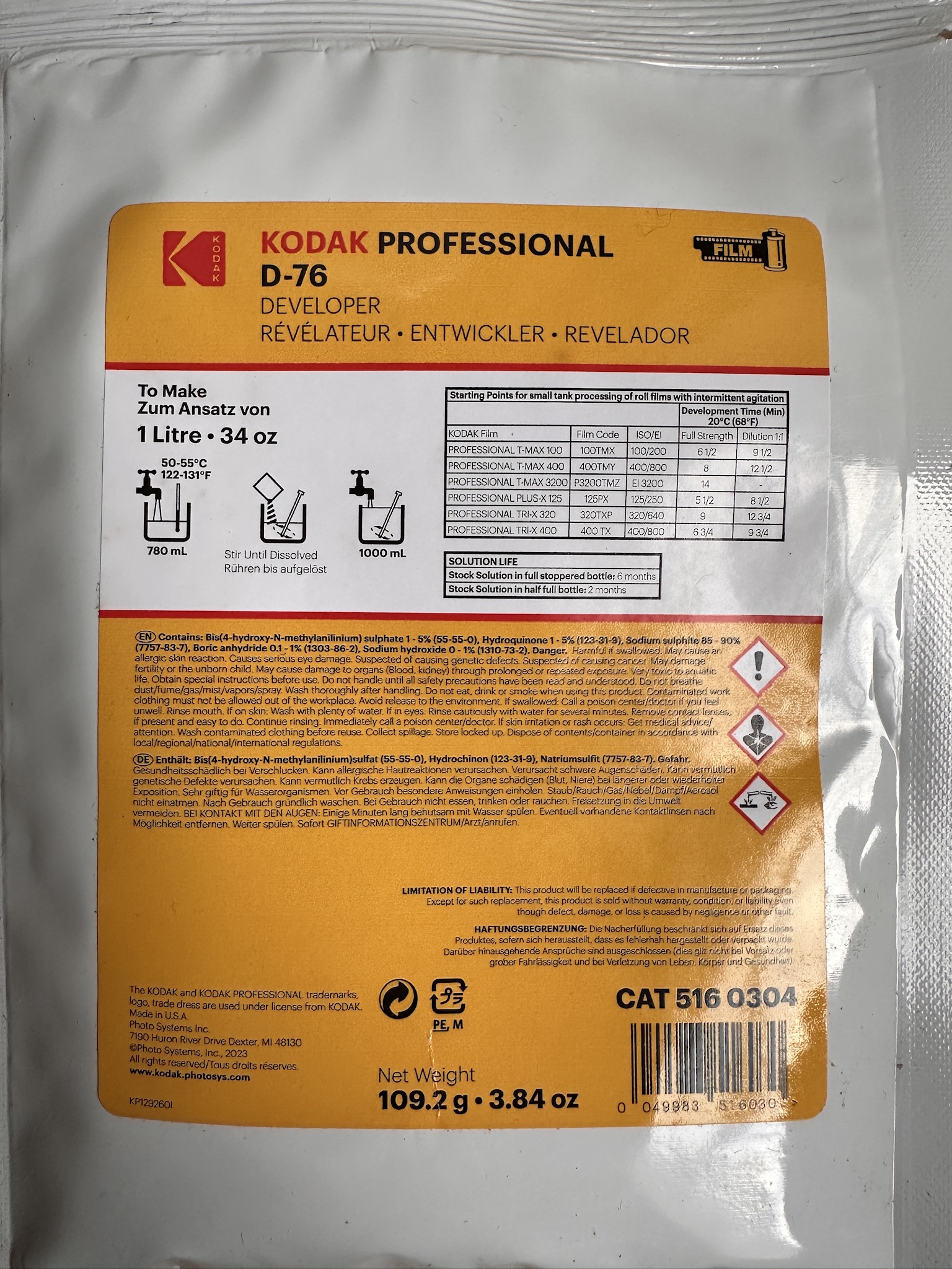

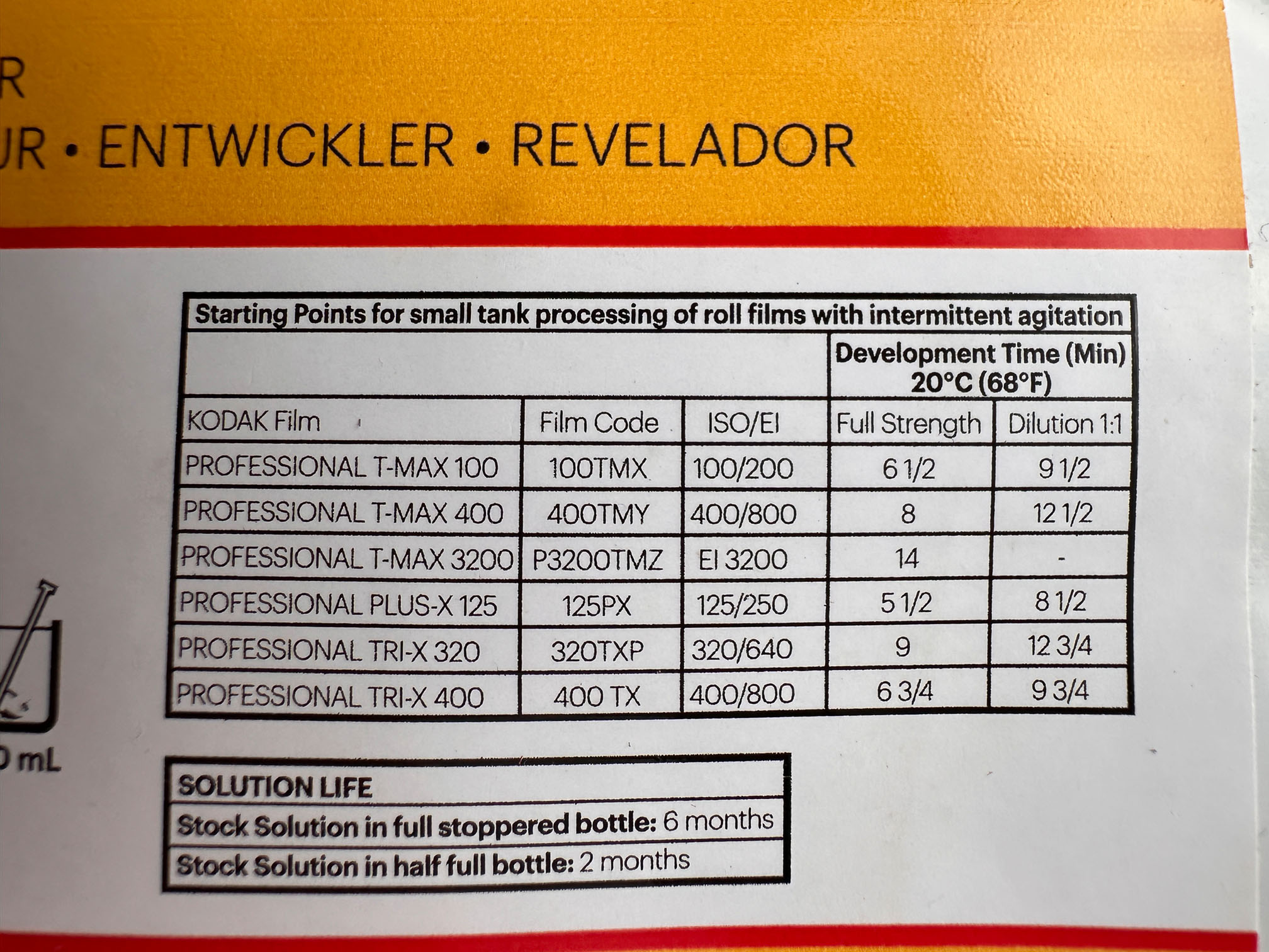

..found this thread after being confused in regards to what times to use with the D-76 I just mixed (using the developer for the first time) - it sure is a bit chaotic 😀
So as an update / for the sake of completeness, here's pictures of the current (made in the USA, by Photo Systems Inc.) packaging.
It sure feels weird that they don't even bother to do an updated data sheet but instead just point you towards the Massive Dev Chart on their own product page 🙈
