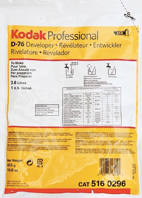

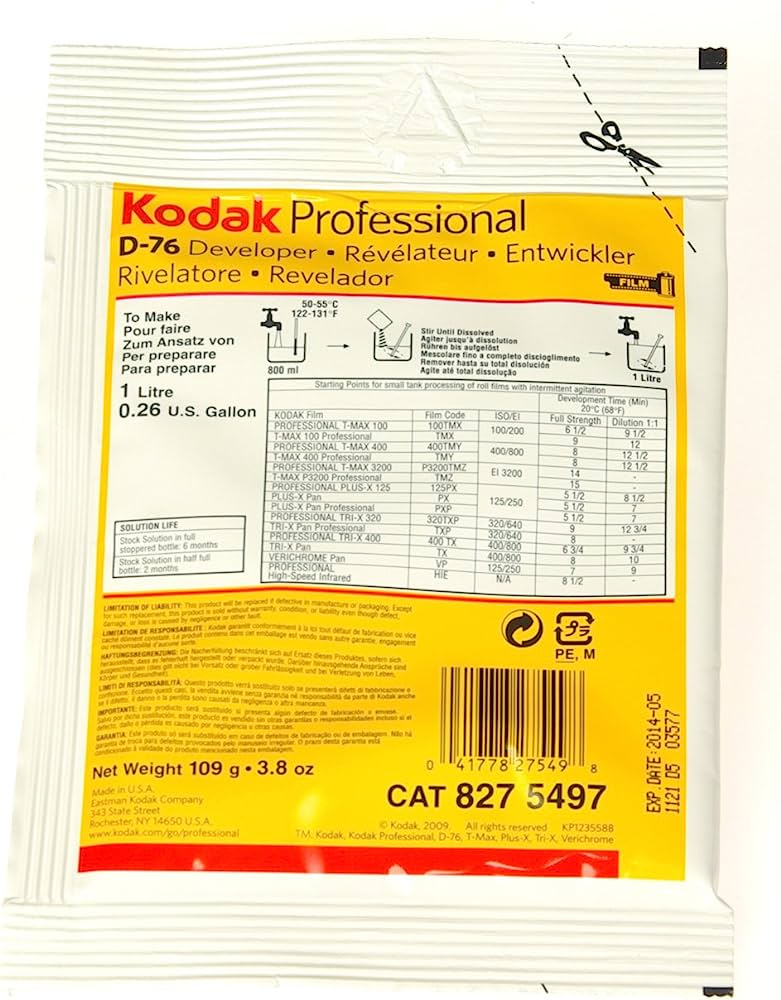

Given the packets of D76 "Made in Germany" prior to the sale of that stuff to Sino seem to have the same times as the data sheet, written on the table on the front of the package, these "wrong" times have been around a while.
Above, expired 2016 Made in Germany with the wrong times listed.
Below, expired 2014, Made in USA, with the wrong times listed:
But wait! Not only do these packages have the wrong times listed, they also have the right times listed.
"Professional Tmax 100" has 6.5 minutes listed - and that, supposedly is correct.
"Tmax 100 Professional", what?, has 9 minutes listed.
There are also two listings "Professional Tmax 400" and "TMax 400 professional", but they both say 8, neither says 7.5 (from the film's data sheet ... but which film????)
Tri-x has it better, with three listings (not including the 320 Tri-x, of course), with one having a time matching the film's data sheet.
So. What is the difference between "Professional TMAX 100" and "TMAX 100 Professional"? It's obviously significant, because it causes one to need 2.5 minutes longer development than the other. I never knew you could change a film just by rearranging the words on its label.
Is TMX the code for older Tmax100 and 100TMX is the current code? If that's the case, then the D76 data sheet simplified this list from the package but chose the wrong time for the current film, which is what was speculated at the start of this thread. Of course, 400TMY is still wrong on these packages, unless that film has been changed in the past 7 years.

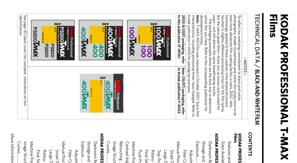

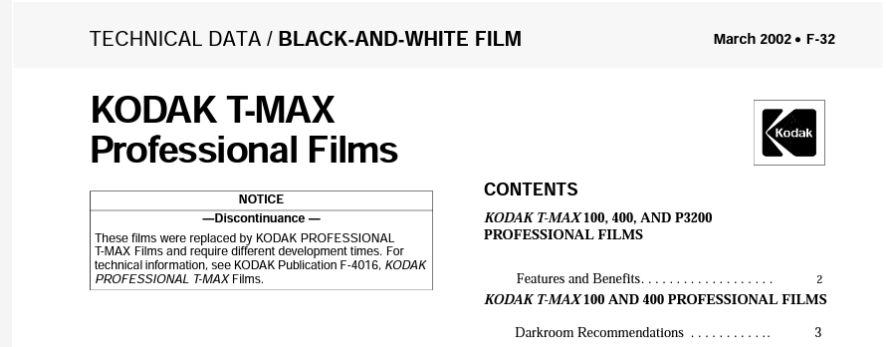

There are two different versions of both T-Max 100 and T-Max 400.
From the F-32 datasheet in 2002:
From the 2007 F-4016 datasheet in 2007 - rotated sideways.
This was much of what I was referencing earlier, when I posted:
By the way, matters are further complicated by the changes over the years in the various Kodak films, with correspondingly confusingly small changes in the names of those films.
