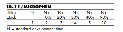

I cannot find any reference in the Ilford instruction sheet to a minimum amount of stock to be used.
From the Ilford datasheet for powder developers (emphasis added):
REUSING DEVELOPER WITHOUT
REPLENISHMENT
If a series of individual films is being developed in
a spiral tank using 1 litre of stock ID-11 or
MICROPHEN or PERCEPTOL, compensate for the
loss of developer activity after developing the first
film by increasing the development time 10% for
each successive film, (see table below). This
method of time adjustment relies on the used
developer, (250 -300ml for one film), being
poured back into the stock bottle and mixed with
the fresh unused part of the developer before
processing the next film. When using spiral tanks
this helps to give more consistent results by
reducing the risks of problems due to solution
losses and the restraining effect of the by-products.
In other words, it is there in the capacity information - essentially 10 rolls/litre or 100ml/roll, plus the additional practical recommendation respecting re-use of developer and 250 - 300ml for one film.
It is important though to remember this part of Ilford's recommendation.

OK Matt It was maybe just me who failed to make the connection between the capacity when re-using developer by the method mentioned and the overall capacity of the developer but I do wonder if all or even most newcomers would have made that connection.
Equally as I sort of hinted at, believing that 35ml for rotary is stretching credibiilty as well or is it for relative newcomers?
I think that a statement in the instructions which covers minimum quantities of stock required would have been sensible. It is after all, newcomers that keeps the likes of Ilford running and the more help they get from Ilford the better or so I would have thought
It reminds me of the thread that involved the minimum quantity of Perceptol required. As I recall the thread, there were 2 schools of thought. The first school said that Perceptol could develop 4 films and this was based on the following piece in the Ilford instructions as follows:
" If a series of individual films is being developed in a spiral tank using 1 litre of stock ID-11 or MICROPHEN or PERCEPTOL, compensate for the loss of developer activity after developing the first film by increasing the development time 10% for each successive film, (see table below). This N = standard development time Page 8 of 9 N = standard development time nr = not recommended POWDER DEVELOPERS method of time adjustment relies on the used developer, (250 -300ml for one film), being poured back into the stock bottle and mixed with the fresh unused part of the developer before processing the next film.
This was followed by a table showing that beyond 4 films the "pour back into the 1L of stock " was not recommended for Perceptol so 250ml was the minimum stock of Perceptol required. I this case a 1L tank is required for 1+3. Given how rare a 1L is ( certainly not the normal tank for 1 x 135 film ) and the strain on a lot of rotary processors with 1L of liquid to rotate it just struck me as requiring an expansion of the Ilford statement
I had used about 65ml in a slightly overfilled Jobo 35mm tank - they only require 240ml - but will take more, at a 1+3 dilution for HP5+. I had used 1+3 to get me the max speed of 320 and the negs looked fine as did the prints but decided to ask llford if this was OK as a minimum
The reply I got suggested that 70ml would have been better but there was not as much as even a hint that the minimum was 250ml.
The point of this long story being that there was an apparent but IMO a relatively serious contradiction between the conclusion drawn from the Ilford statement that 1L of stock in not recommended beyond 4 films so 250ml minimum required and Ilford's reply to me
So it suggests that there may be a large margin of safety to put it mildly between the minimum stock required based on the number of films developed in the re-use statement and what is actually needed
FWIW, the "powder developer" Ilford datasheet sometimes seems to me to have come from an earlier time, when the idea of rotary processors that use relatively very small amounts of liquid was something new!
It strictly avoids any discussion of the necessary volumes for that sort of application, while being careful to advise that, with respect to "spiral" tanks, it was important to make sure you have enough developer in your tank to cover the reels!
I'd be careful about extrapolating the re-use instructions respecting Perceptol to the situation with ID-11. ID-11 was designed for commercial use, often in a replenished line. Perceptol is a quite different entity.
Most of the capacity related behaviors of developers relate to how they were formulated to respond to the conditions of commercial labs.
