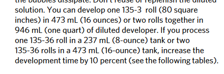

To repeat those instructions they say "You can develop one 135-3 roll (80 square inches) in 473 mL (16 ounces) or two rolls together in 946 mL (one quart) of diluted developer. If you process one 135-36 roll in a 237 mL (8-ounce) tank or two 135-36 rolls in a 473 mL (16-ounce) tank, increase the development time by 10 percent (see the following tables). "
I am having difficulty understanding if the last sentence is describing a "like for like" situation
In the first sentence it suggests that you can develop one 135 (80 square inches) in a diluted developer of an unspecified dilution but I presume 1+1 in 473ml or 2 films in twice as much. So far so good but then in the second sentence it speaks of processing a single 135 film in a 237 ml tank or 2 x 135 in 473 increasing the development time by 10% and refers the reader to the following tables.
Just as an aside 80 square inches seems a lot for a 135 or 120. The exposed frame are is about 54 sq inches so is the rest the leader and trailer areas and do these amount to almost half the exposed frame area?
On the next page there are times for small tanks and large tanks and there is in fact slightly more than a 10% increase. Tri-X for instance goes from 8 to 9 mins but I assume this is simple rounding up of 48 sec to 1 min. Am I right?
So it would seem that if you want to develop 1 x135 film in a diluted developer which I assume to be 1+1 a 10% increase in development time compensates for a reduction in stock volume from 237 to 119. For ease lets call those 240 and 120 ml respectively
You are reading the wrong table. You need to read the 1:1 table. And the tanks we are talking about here are all small tanks. The large tanks refenced on those tables are the ones with gallons of developer and either take racks with multiple reels in them or use dip and dunk technology.
The references to smaller than 16 oz tanks for more than one roll suggest a 10% increase. So you pick the time recommended for your film and temperature combination in the small tank part of the 1:1 table, and add 10%. If the table time recommended is 10 minutes (20C, Tri-X, D76 1:1), then add an extra 10% = 1 minute more.

Here is a screen shot of the applicable 1:1 table from the datasheet
Hope this helps
